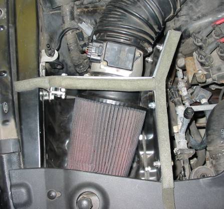

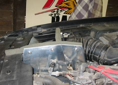

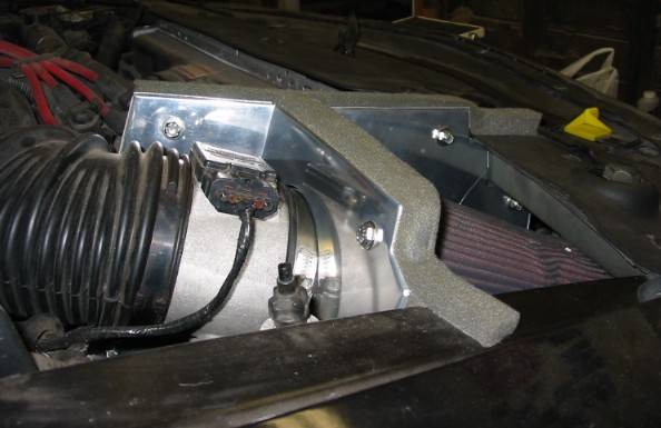

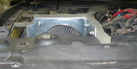

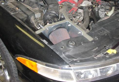

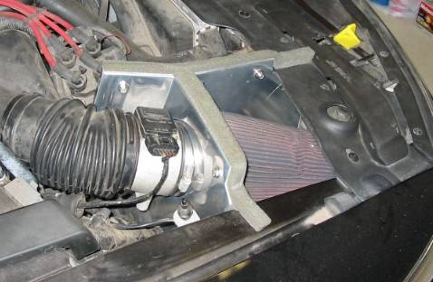

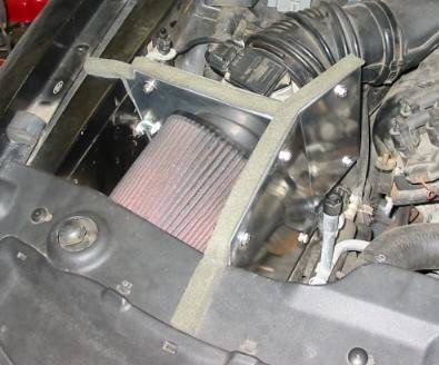

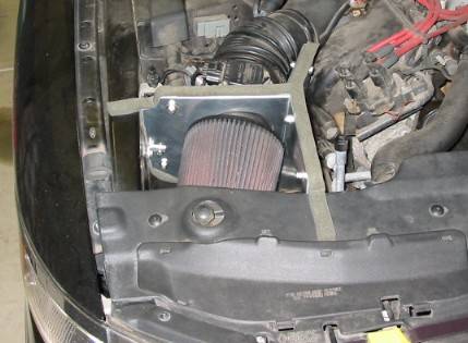

I made my own, its sweet. Completely sealed from the engine compartment, double walled aluminum. I even extended it past the mass air to help it stay cool. Made a huge difference on power consistency.
was it a pain in the ass to make? And where'd you get the double walled aluminum? I thought about this before and figured I'd just order it from LMS. But now I'm really thinking of doing what you did. Thanks man
I was going to get his too, I figured it would be hard to make one for less. After a while of waiting I decided to do my own. The aluminum isn't double walled, I made it double walled. I spent almost what he charges in materials, the final result is better looking and performs incredible.
Here they are. I believe it was 20 gauge, alittle flimsy I thought at first, thats kinda why I started to think double wall, then the obvious heat protection benefits, it works terrific. There's a 1" gap between the two walls. I used the same gasket material you see on top along all edges, so where it meets the body etc., its air tight. The fit was so good I could of skipped it. It also fits the hood insulation tight, the gasket was just a nice finishing touch I guess. I also designed it so it mounts to the same bolt locations as the stock box with simple L-brackets, you could go back to stock. Bolt are all stainless, washers too and I used stainless lock nuts. You can drive the car as long as you want in hottest of weather, pull over, pop the hood, put one hand on one side one on the other and the filter side is super cold compared to the other, its that dramatic. Let the car sit running or not it takes a long time for the heat to transfer throu. Even then if you jump in again and drive around, pull over and its cool again. I did it several times, it always cools down. Power is always there, always cold air to breath.
