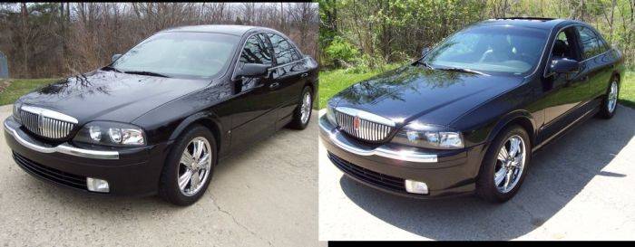

I have a picture from a month ago using some basic turtle wax and then a comparison with the Eagle One Nanowax. The Nanowax goes on easy, but it doesn't haze or dry completely like I wished. nano is on the right and there's more sunlight, but it does work nice.
The small microfiber cloth they give you, is TOO small. I bought a larger one at Walmart later. Do yourself a favor and buy a larger micofiber before you do your whole car.
I'll give it a 9 out of 10 since it didn't haze fully. But the results are good. It shines like a mirror.
