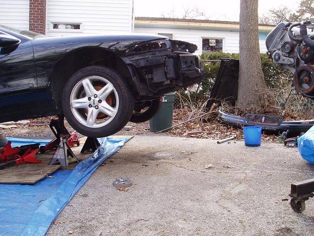

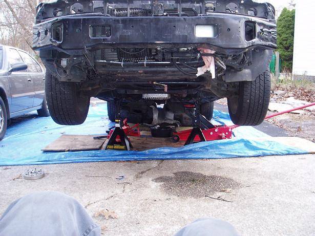

is this high enough for getting the engine out from the bottom, with the k-member? geno? anyone? I'm not sure how much I need to raise it, anymore I don';t think I';d feel safe under.

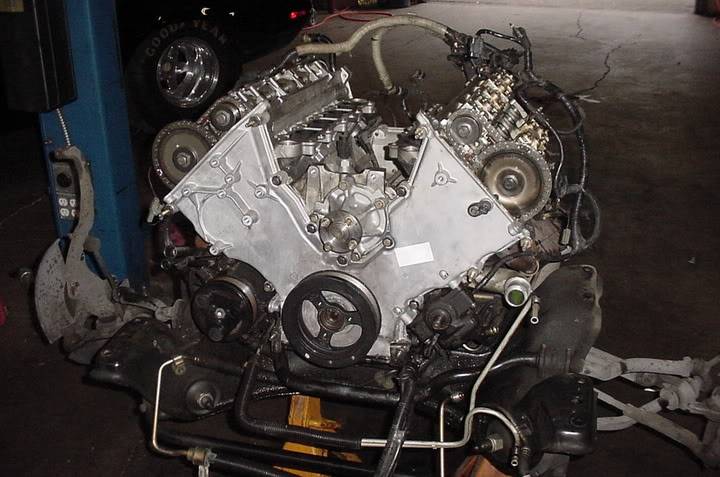

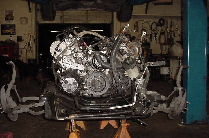

BlackIceLSC said:The part that will hurt you is the wheels/tires. if you can find a way to remove them, and cradle the K-member when it drops, you should be better off. But if you can, try to leave the suspension attached to the K-member...it will make it easier(less work) when you're done. I'd remove the wheels, and when you drop the K-member, have a dolly, or something to cradle it on(to roll it out) without mashing the oil pan. Then you have mobility. of course, you'll have control arms and spindles hanging off the k-member, but that's one less thing you need to 're-install' when the motor's ready to go back in.
BTW, we dropped motor AND trans...just leave the tranny cross-member attached. makes installation much easier.

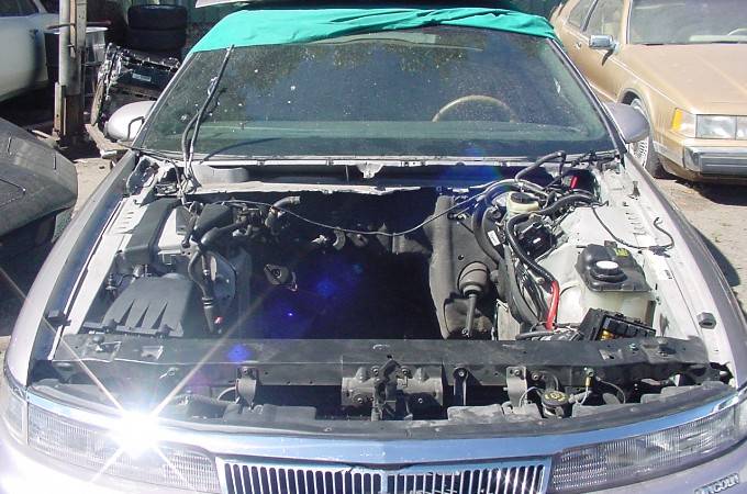

Coming out the top is easy, but requires more work, and some more finesse.
And proof i took one out the top, here's an empty engine bay for ya!
BlackMark8Li said:is this high enough for getting the engine out from the bottom, with the k-member? geno? anyone? I'm not sure how much I need to raise it, anymore I don';t think I';d feel safe under.
phreakness said:Just a couple of questions and a favor.
How tall are those jack stands 18" / 24"? Why did you take off your front grill and bumper, I understand the hood but not the grill and bumper? is it a "requirement" for a k-member drop? did you write down atleast what you done so far? Plan to make a step-by-step guide for us gimps that may attempt this later on?
I told you to measure from the k-member to the ground.BlackMark8Li said:to answer my own question... HELL NO THE CAR WASN'T HIGH ENOUGH.. trying to get it higher.. still needs a few more inches.. this car sucks
MonsterMark said:I told you to measure from the k-member to the ground.You could always take the lift and lift up the front end of the car and then slide the motor out.
