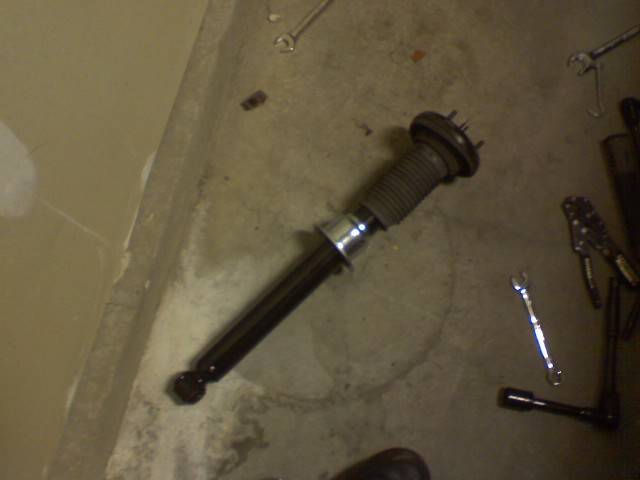

i also bought 1 front Monroe 2002 Jaguar S-Type V8 shock, just to see if it fits....heres the pics with the results....

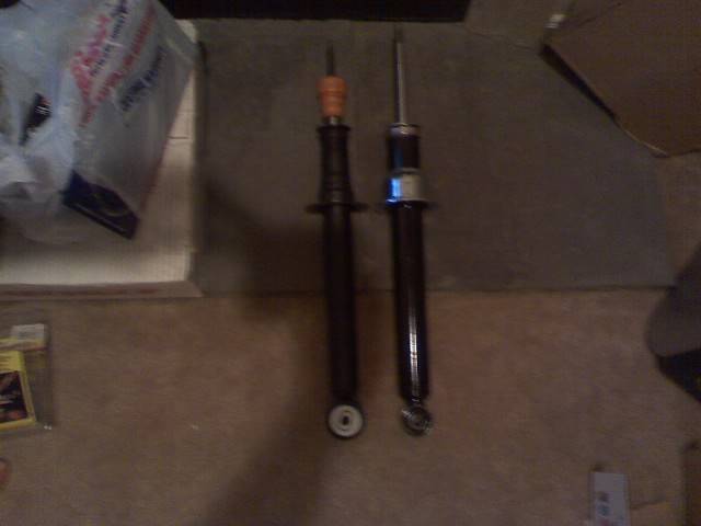

Jag shock is on the right, Lincoln shock on the left

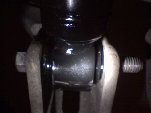

here's pics of the shocks installed. I only mounted the shocks using the lower mount. i did not fully install the Jag shock, i wish i had but from what i saw it would still work cuz the stock Lincoln's shock top plate and spring still looked like it would fit.

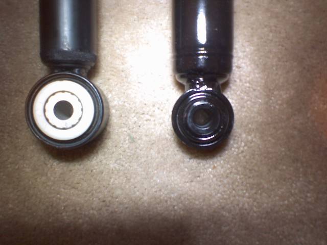

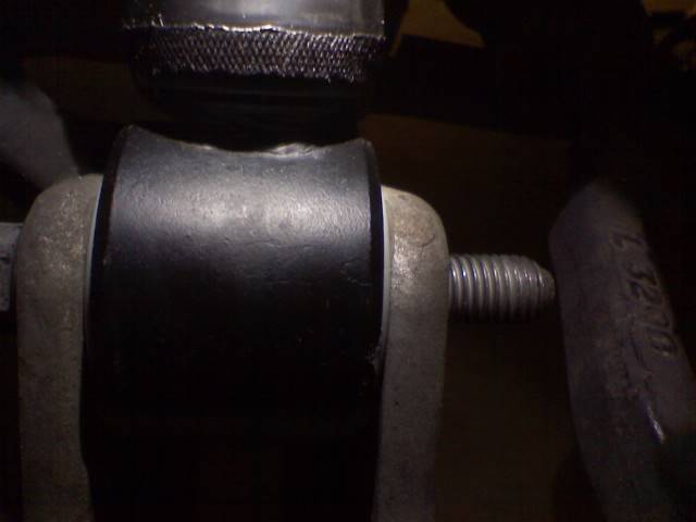

The only issue i saw is that the Jag's shock lower mount is thinner than the Lincoln's. It had movement between the shock and lower control arm. i think with some washers placed in between the shock bolt and lower control arm would make the shock sit nice n tight.

The first pic is the Jag shock, second the Linc's shock

that is very interesting. the data sheets we have access to simply state that they are different - not really pointing to 'what' is different.
beside the lower mount thickness - any other noticable? the shaft length looks shorter - but what about thickness?
i didnt see anything that would interfere with mounting the Jag shock other than the lower mount causing movement side-to-side. But i need to find out how the LS performs with the Jag shock.....The Lincoln springs fit perfectly with the Jag shock, both the shocks' lower perch and the upper mount plate fit perfect to the shock&spring.

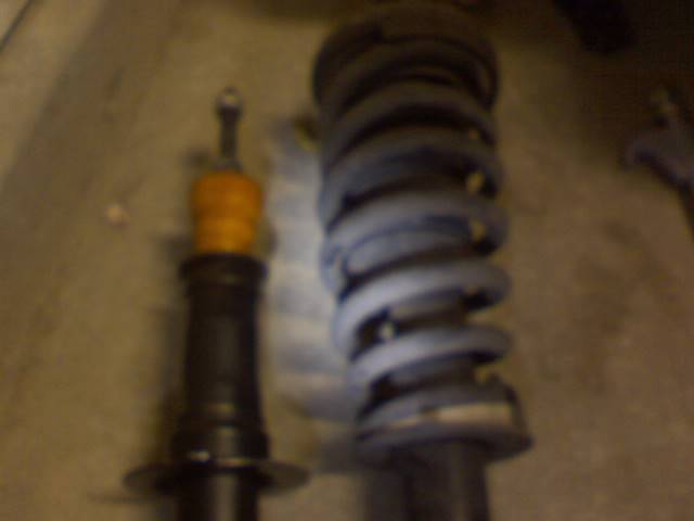

Just a random pic of the Jag shock with the LS boot and upper mount.

Try it with the spring on. Word on the street is the lower mount is smaller on the Jag shock and the spring will slide right over.

The "problem" with the LS shock is the travel, or lack there-of. That yellow piece on the LS shock is actually part of the shock travel; it will compress. The actual piston travel is pretty short with the rest of the compression taken up by that yellow bushing. That may feel like bottoming-out. If you want a tight feel (although maybe a little rough) use the european LS shocks with Springtech springs. Also, the majority of your ride stiffness will come from the springs, not the shocks. The job of the shock is to control the compression and rebound of the spring. If the spring doesn't compress, neither will the shock.
