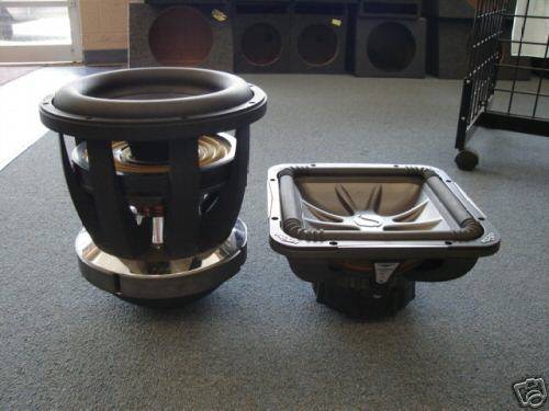

Just put in a 06 xxx and it sounds like crap???
heres a pic of it
http://www.lincolnvscadillac.com/attachment.php?attachmentid=21012&stc=1&d=1155657792
20BlackLS00 said:
THe speaker is not nearly as loud as my 2 audiobahn flame Q's. its facing forward through the seats with them down running off 1 2500d in a box built to its specifications. all i have now is 2 batteries. This is far from my expectations. This was installed by a professional audio store and im extremly dissapointed. I cant imagine wats wrong. Its got 0 gauge wire and everythin. Would adding a 200 or 240 amp alt make that big of a difference cuz right now it can barely make my rearview mirror go down and doesnt even compare to the audobahns that were in there.
