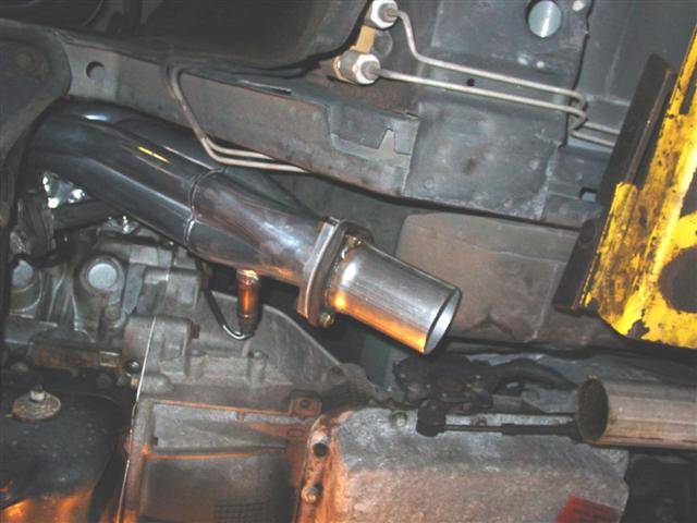

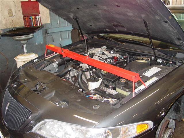

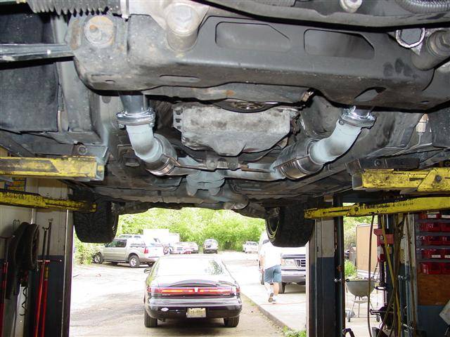

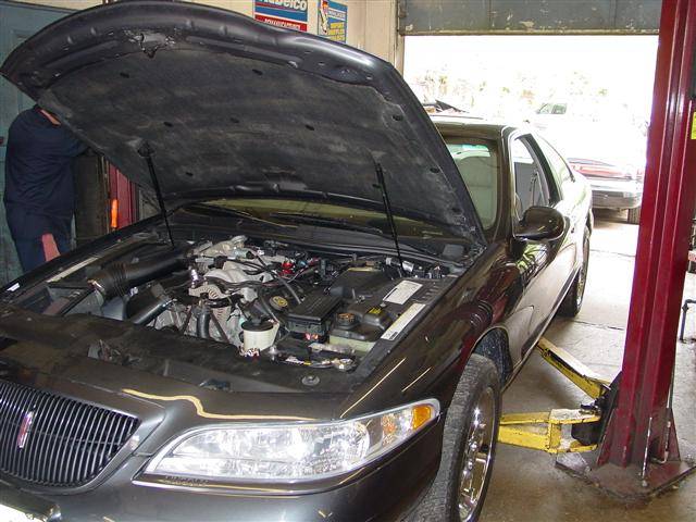

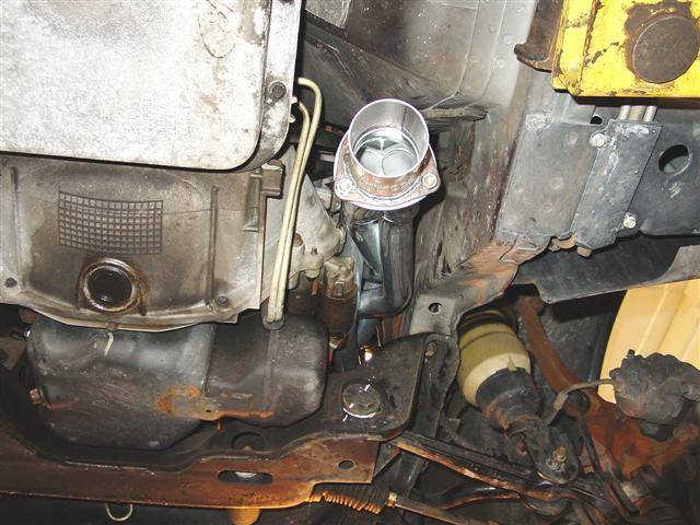

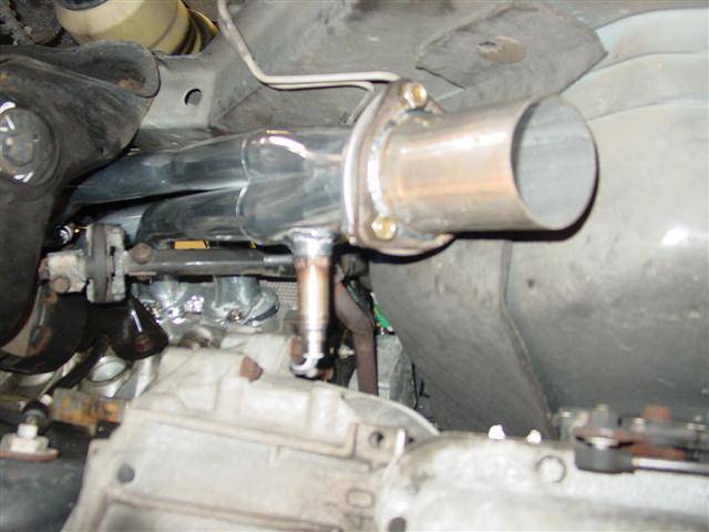

Ok - the kooks headers are in. Catalytic Converters are next. They'll be tig welded in tomorrow. That'll complete the header install.
Next are 4.10 gears, denny's driveshaft and a torque converter. After that, it gets a custom dyno tune. All in time for Carlisle. (Link to Carlisle Info)
How bad did you have to bend up the cylinder #8 pipe to get around the steering knuckle?
I also was wondering about the steering knuckle.... I thought it had to be changed??
Looks good. Have to say it looks like a tight fit and probably takes some patience and time to get those things in there with scatching the crap out of them. Thats what makes it so sweet when completed.

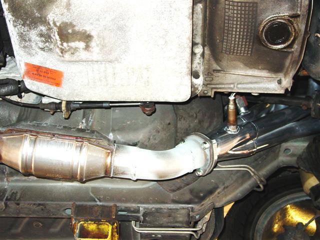

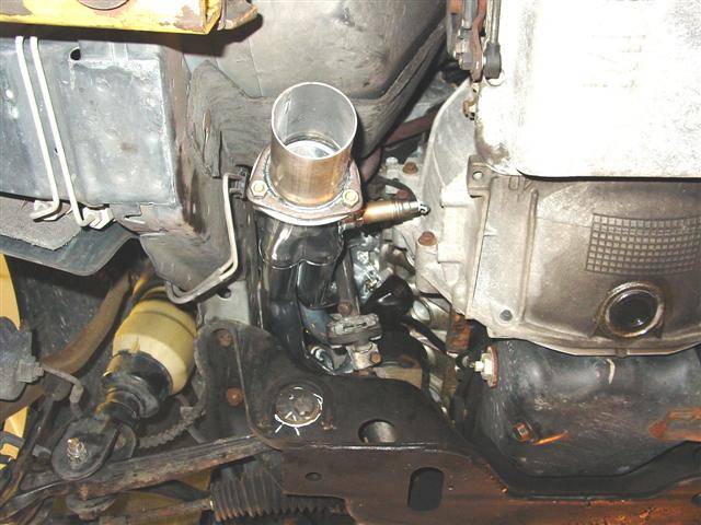

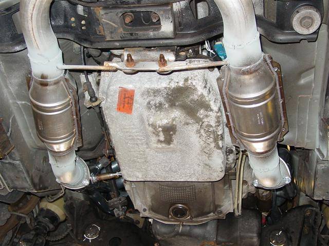

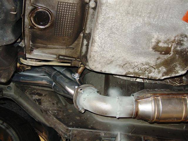

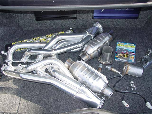

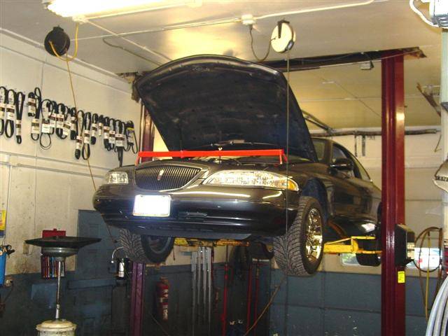

Ok - they're in!
Headers, high flow cats, all new O2 sensors as well. Sound is awsome, and I can FEEL the power difference. Next, torque converter, driveshaft and 4.10s
They slipped right in. No obstructions. Pulling the K Member is the only way to do this IMO.
Joeychgo said:
Things are looking good...
I agree on pulling the K-member.....:cool: looks awesome Joey, I wish kooks headers were around when I put my Motorsport shorty's in.

Joey, you said they were gonna TIG the exhaust, that looks like just a normal MIG job? (although, it is much harder to TIG on the car)
