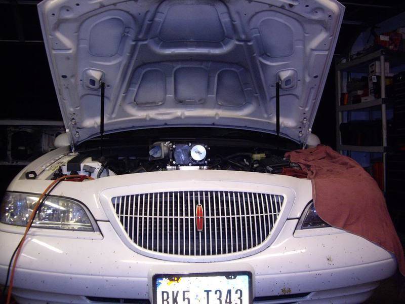

Gonna be doing some hood cutting today to ge the blower to clear. Looking at it it seems hard to believe the 2nd gen guys havent had the k-pmember dropped. Sure is tight!! Lsc8, thanks for the pics! Should help with the bracke making.
Did you have any trouble with the middle hood rib hiting the snout? Where did you get the feed for your bypass valve? Did you take it before or afer the blower?

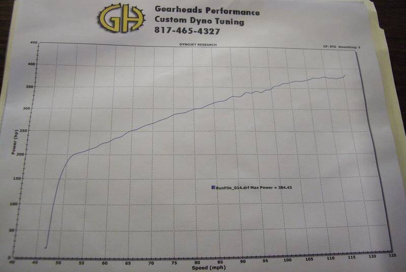

Alright ya'll. She made 384/398 on the dyno but is running way too much boost and then there are other issues. It will make a little more hp with much less boost but I have more stuff to buy first. Need 8 coils and he said get the MSDs as he uses them on his high HP Cobras. Also need a larger fuel pump or a Boost-A-Pump. He likes the BAPs. Also the IAC is sticking so that needs replacement and it seems a crickett is living in my idler pully so another part to get. I also need an under drive crank pully as I am making a chit ton of boost. I have seen a 17 psi spike so far but WOT will net 16 psi! :eek:

Aren't the Kenne bell's for the 96-98 cobras only supposed to put out 6-7psi with the pulley it comes with

How about I just put a smaller crank pully on it and drop the boost?
