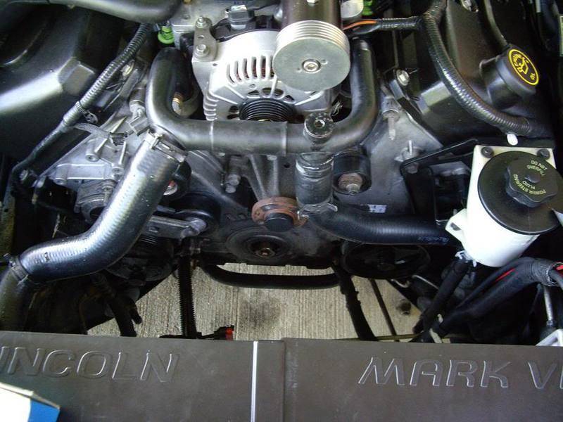

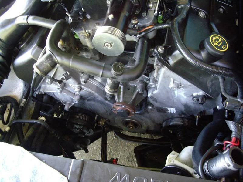

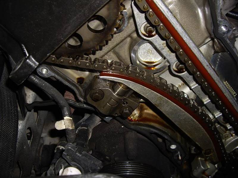

So Sapperfire came over last night so we could get an early start on the car today. He had actually started on it before I wouke up and when I went outside he had a lot torn down already.
So I hopped to it and started to help with the rest.

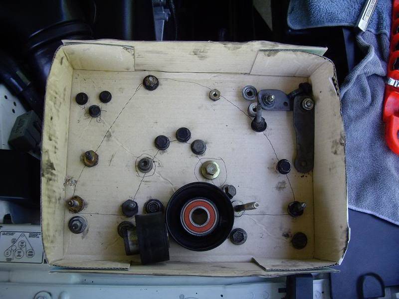

Decided since it will be a week or so till the car gets put back together that I better mark all the bolts to be safe:
Then it was time to get her in the air to pull the PS pump and take out some oil pan bolts:

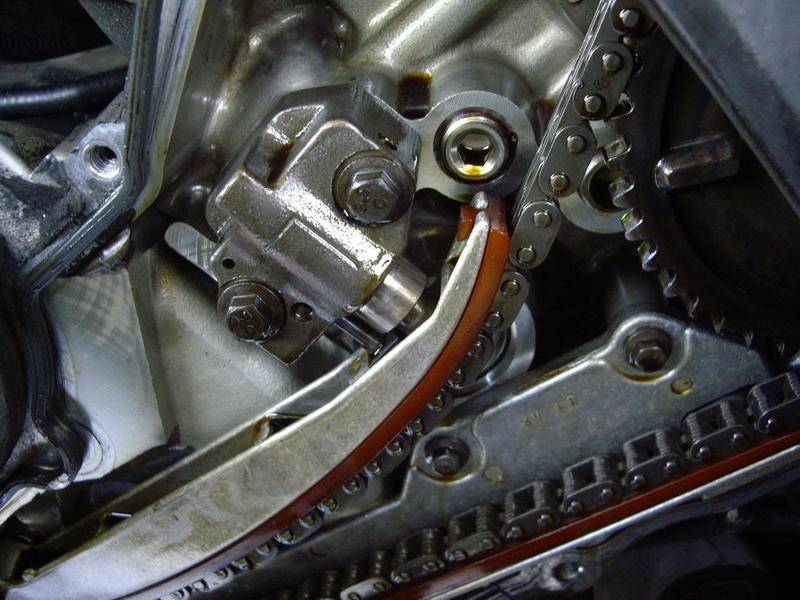

So we loosened the VC's and I pulled the timing cover. At this point I was very sad. :( The tensioners and guides look perfect and show no wear. At that point I was certain the rods or main bearings were shot. We started to make plans as to how to do the motor swap and set this one to the side for a rebuild. So Jeremy starts to make some calls and I fiddle with the tensioners and get the drivers side guide to squeeze out about 1/8-1/4" and start to think maybe it is worn and dont pump up enough and maybe its worth trying to swap them to see what happens.

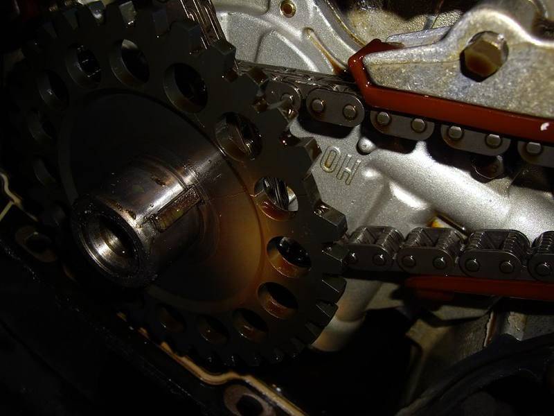

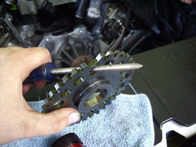

At this point Jeremy is back over the car and says "You're gear is cracked!" and I look at the reluctor gear or crank angle gear and see at its TDC spot it is cracked half way through! :eek: He touches it and it goes "clink clink" on the crank. He just grabes it and it slides off the crank with no effort at all. I take a look and man o man was he right! I had never been so happy to see a broken part! :lol:
Jeremy, thanks a ton mang! I was ready to get a new motor and he swoops in and finds this small part thats pretty easy to swap is broken.
So since we are in there I am gonna replace the tensioners anyway and order a new gear and gasket set.

That settles it, after this happened to my friends 97:
And now yours... when my timing cover comes off I'll bite the bullet and buy a billet.
