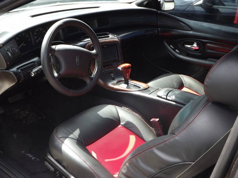

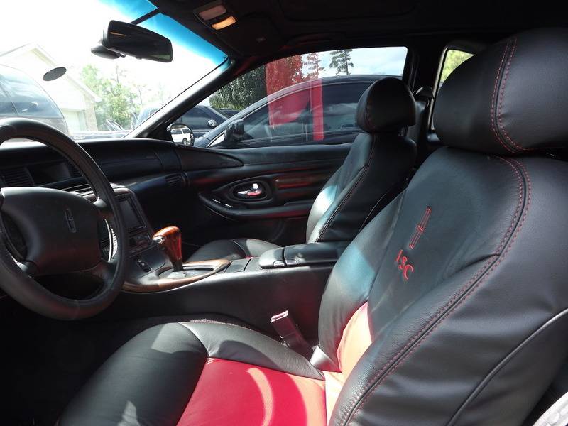

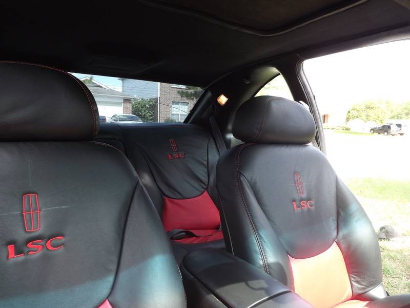

Whats up with the front of the bottom portion on the drivers seat? Am I the only one that see's it?

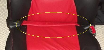

Yeah. I saw it too. What is that? Looks like a piece of the leather than needs to be folded under or between the bottom and back of the seat?
Is that what you were talking about?

That peice looks somewhat normal, it is a tad too big though and the red aint matching up. I was referiing to the front portion of the bottom. Looks like the left side is bulging out compared to the right side.

It's no different than what is on the stock seat that is one solid color. It only looks different because I have a two tone design.

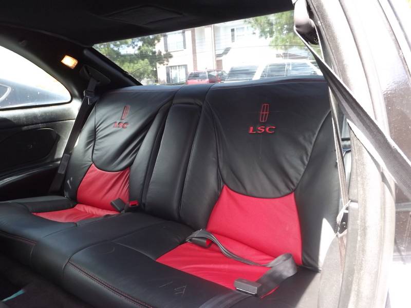

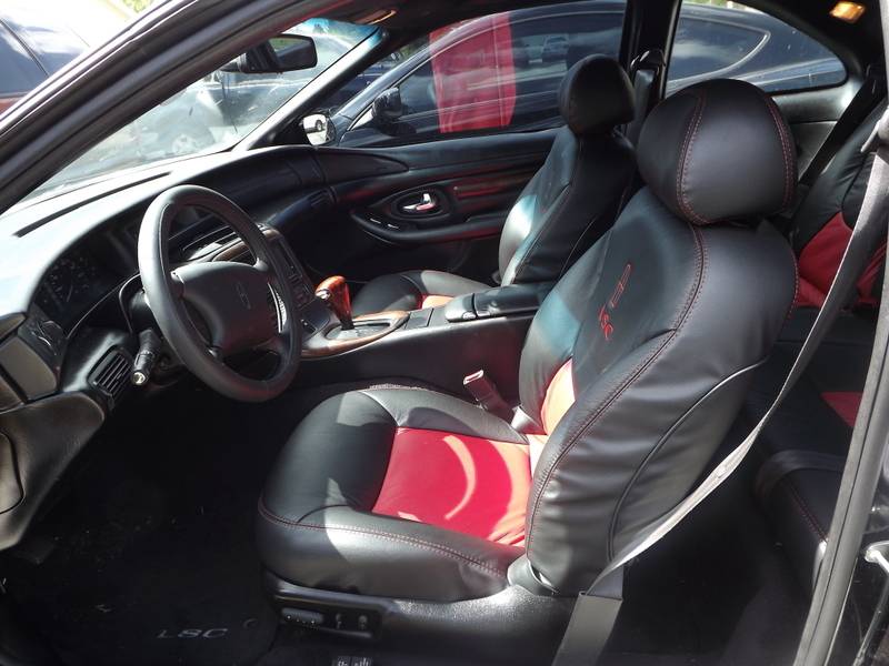

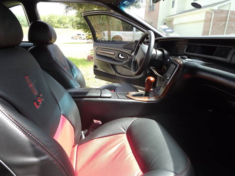

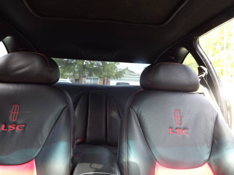

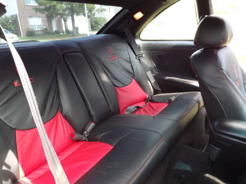

The seats are in, but they are not done. The foam has deteriorated and the velcro is all torn off when the leather was pulled off. So I plan to use my other seat back and build the foam back up by adding some layers. This is how they are for now.

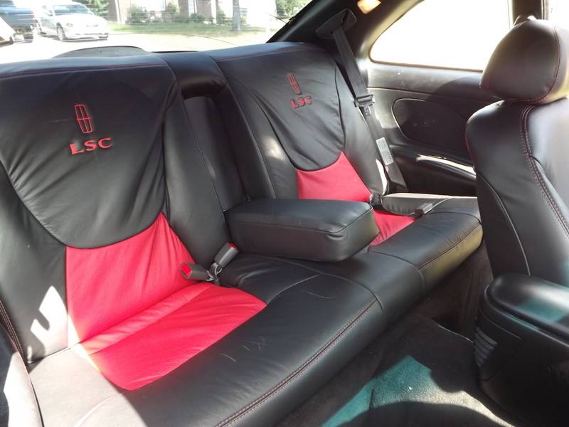

Deffinatly needs to be installed better Gregg... not trying to be mean - seriously.. but the way that leather fits looks terrible
The rear arm rest looks like its twisted, and all of the rear needs to be adjusted and tightened ..I'd hope that for $650 it would look much better
Don't frett thou man, its not useless ...it can be used as a bad example
Its just not Lincoln quality- maybe if its re-tightened and steamed it'll look better.
Personally if it were me, I'd be mad about the way it fits, rip it all out and find out who did Ultimates old 93
Clearly you just looked at the pictures and didn't read what I said. I put them on myself, and foam needs to be added to the back to build it up, not to mention the Velcro rips out when you take the old leather out. As far as quality, it's far better than Lincoln quality. Paying an upholstery shop $200 to build up the backs and fit them is not in my budget. So they will fit better when I get to it again later.

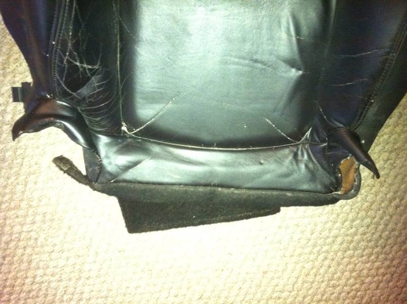

You can glue the velcro strips back in if you use the correct adhesive. I know it costs, but you might want to have a pro redo it. Especially if you are going to rebuild the foam. There are soo many choices in upholstery grade foam. If the leather fitting is not done correct the leather will wear and wrinkle quickly. I have been experimenting with building up the foam on my seats. Read some books. Have even gotten some tips from pro. It is not easy to get nice results. I am not too concerned with my results, but I am using my old leather so who cares. If I had nice new costly covers I would probably have somene do it.

Personally, i think is a great starting thread. The assorted M8 sites have few if any posts on installing new leather or repairing the seats. What I recently did was I sort of rebuilt the foam on my drivers seat. I tried layering some foam on the top but the results were not exactly what I expected. I think mainly because of material selection. I think that is a key detail. Especially on the bolsters. From the factory, the bolster foam is very firm. If you just layer regular foam (even "firm" grade it does not feel right. Then I located a good condition passenger's seat back and padded up the back of the foam and that worked well, but I still think it could be better. Another step I did was to repair how the seat frame cuts into the foam. I sprayed some glue in the cuts and shoved some thin strips of foam in there to bind everything. Then layered foam over that. Seems to work but not sure if it is the professional approach. Here are a few web sites where you can mail order upholstery supplies from.

If you look at my Project X thread you can see I actually put a piece of trunk liner carpet over the springs in the seat frame. Glued the foam back together and then glued a thin piece of foam to the bottom of the cushion to tie it all together. Leather is tight and the seats are firm, they will relax somover time.
