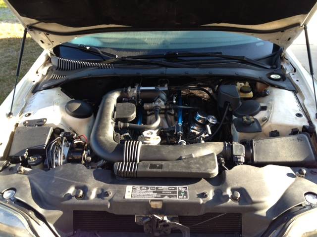

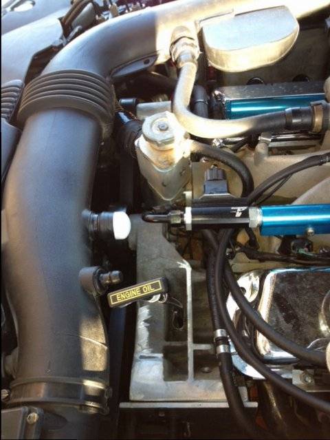

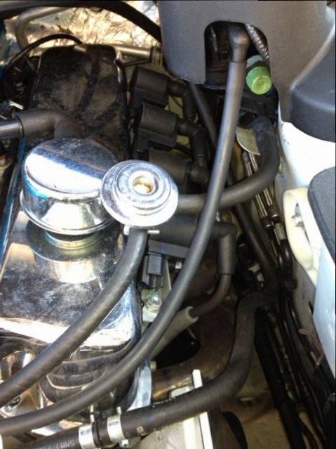

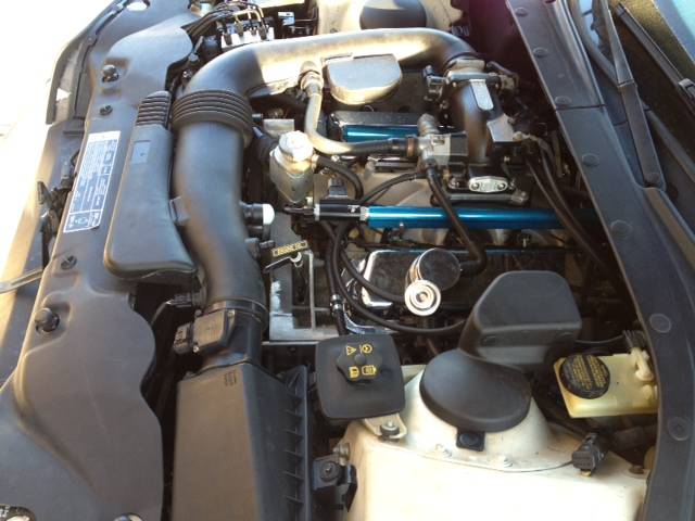

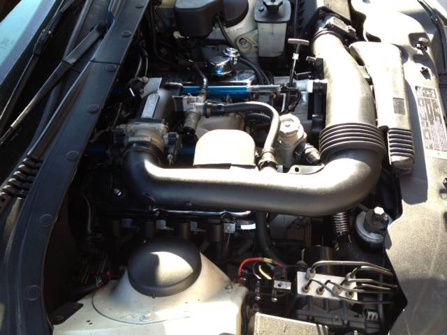

Here are some final pictures of the end result.

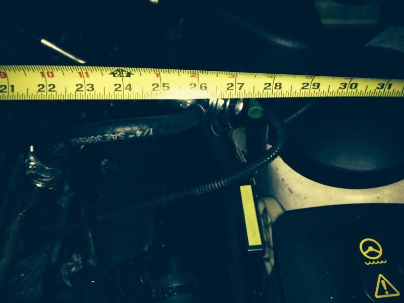

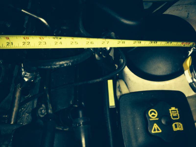

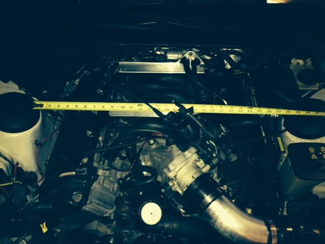

This only gives you about 1/4 inch on each side of the engine.
I can double check but I'm sure That the
frame rails are about 28 inches apart.
Pretty sure that 27 1/2" would be at it's widest point across the heads. The crankcase is likely narrower.
This is a rough measurement. What you can't see here is that the 28 inches runs roughly from the top of the shock towers and continues all the way down to the cross member.
I never, ever, want to say that it can't be done because I love doing odd ball conversions.
That being said, 27 1/2 inches would be darn tight!
In case you didn't notice this is a gen2 engine in a gen1 car.
...and yeah it's bad a$$.
