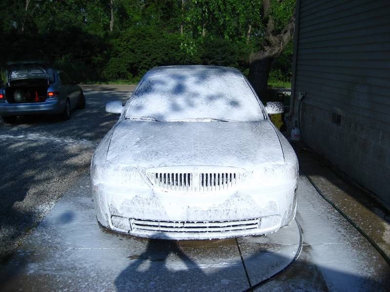

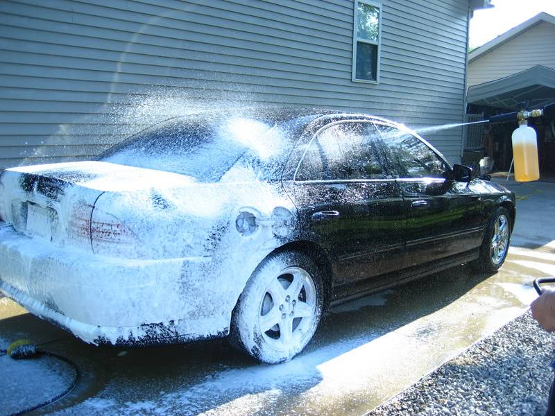

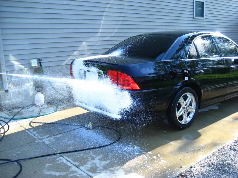

I think some of you were aware of the foam gun that I had, I did a writeup on it before. I have a new project, and I'm moving my way up to a foam cannon. It's essentially the same thing, but it's attached to a power washer. I'm importing the stuff from Italy. It covers the car in a shaving cream thick layer of soap and it sticks there until you want it off. I'll keep you posted.
:cool: I gotta see this.

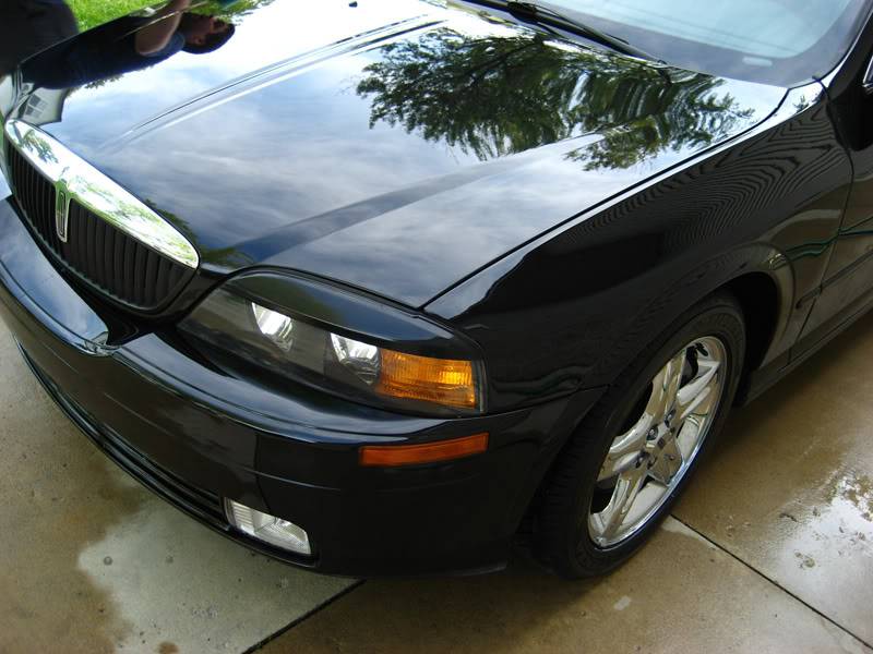

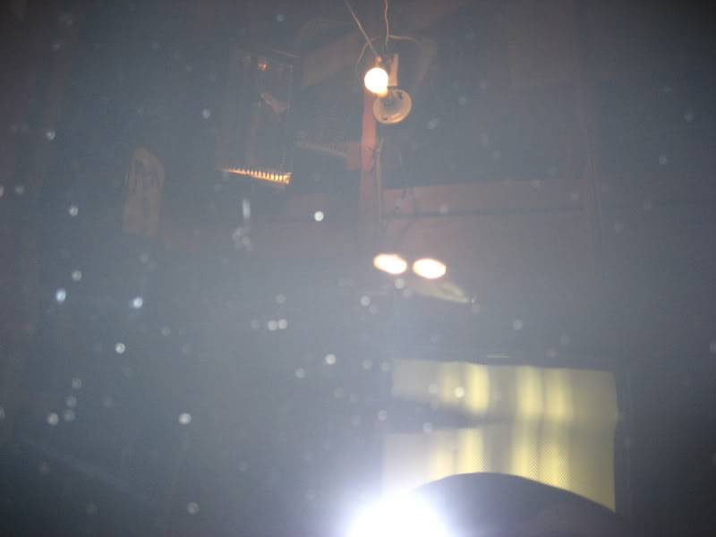

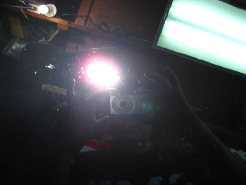

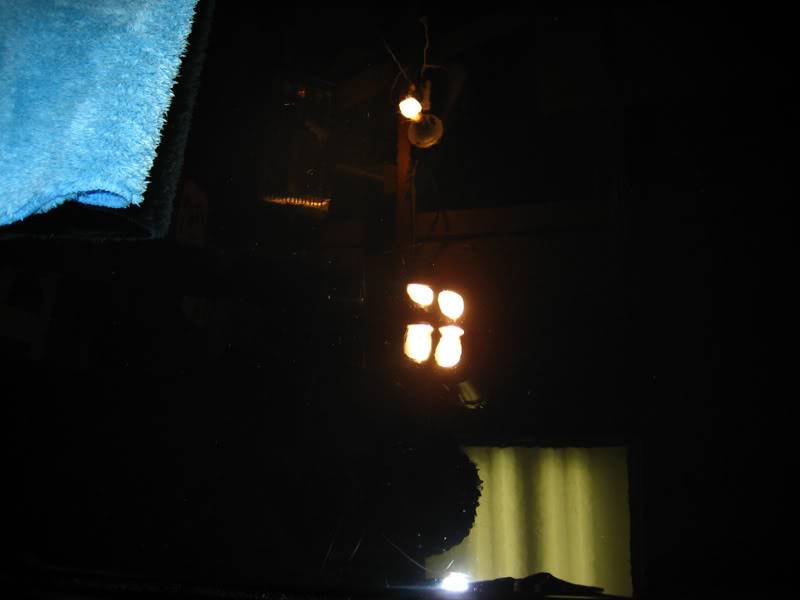

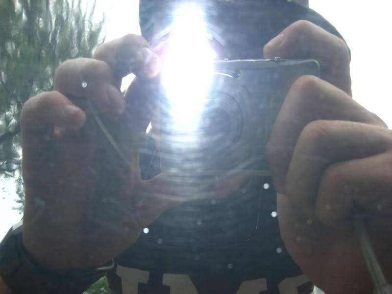

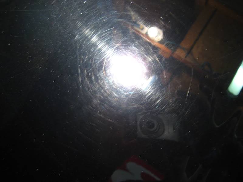

Yep, i just got it done last week I finally uploaded pictures.
these are just a couple favorites of mine:

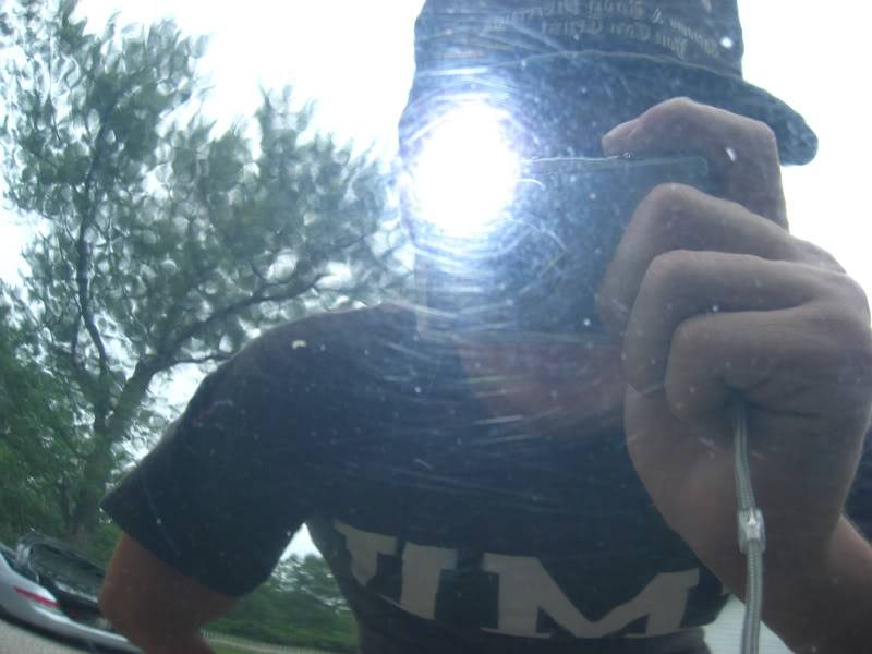

[befores]
[afters]

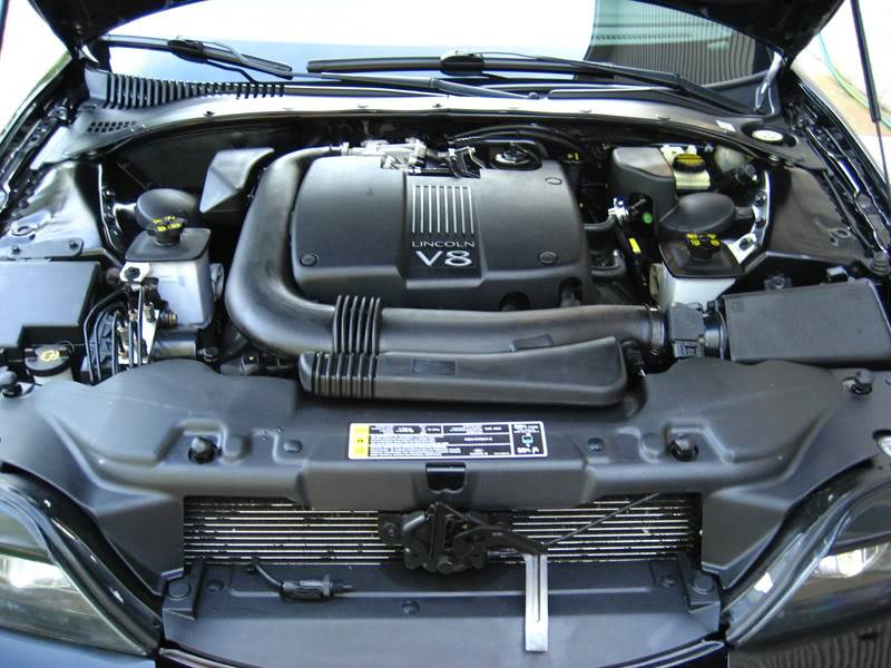

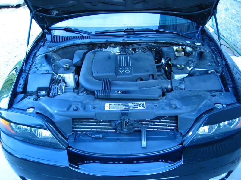

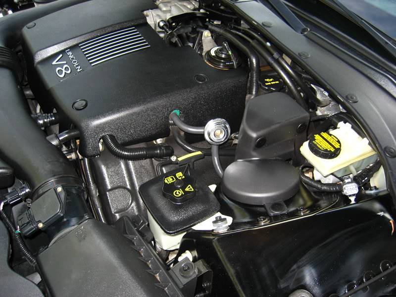

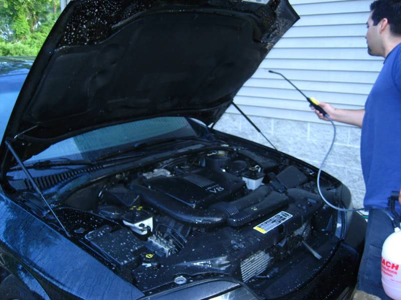

[Engine detail]
there are some more pictures in after the link, and pictures of the OTHER car he did the SAME DAY.

Car looks great Rockstar. I'm in the process of getting that foam cannon, I can't wait.

well, it was obvious that the owner before me was a woman because the interior is spotless... you could eat off the floors if i'd let you eat in it.
However... the clear coat was beat to :q:q:q:q it looked like someone washed my car with a S.O.S, pad luckily it was all Clear coat damage and EASILY fixed. Deep Gloss really did a great job. The guy that did my car recommended a "Waffle Weave" pattern towel to dry the car because its clear coat safe and if there are ANY particles left they get trapped in the waffles preventing them from rubbing the clear coat.
