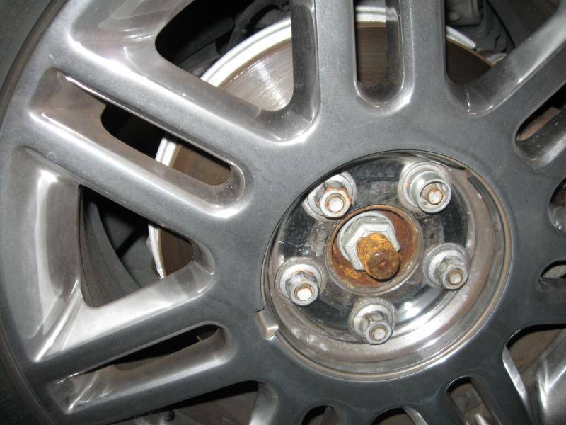

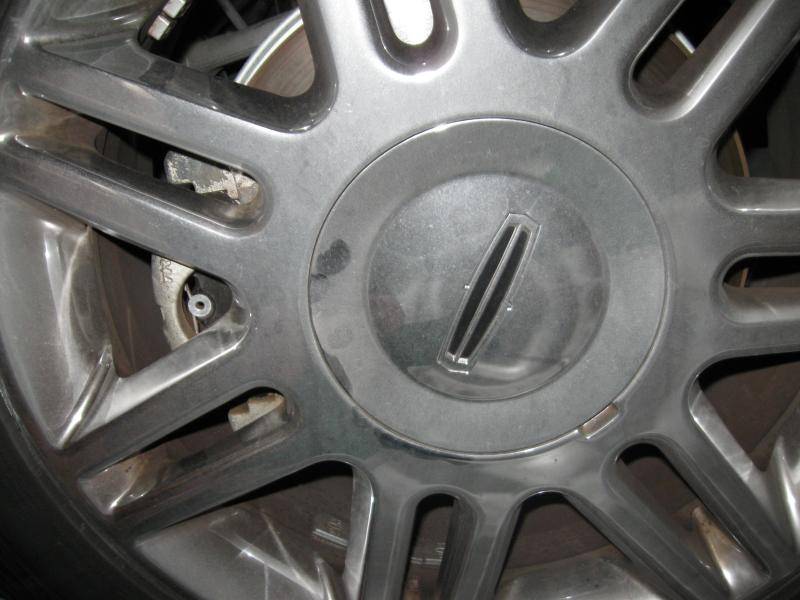

I can't sell it now! I lost one of my center hub caps and am trying to find a replacement....not from the dealer.......checked eBay! NOTE: The rims are dual-spoke design from the 2004-5 LS MY.
The photos show what the missing caps look like. The 2nd one was taken after I wiped it clean from dust and the reflection causes a distortion. Should have left it dirty. Oh well!
All suggestion are welcome!
Those aren't the stock center caps for those wheels. The finish on the wheel also looks different than stock.
I was wondering about that... my 03 has the same style wheel but the center caps have small holes that you can see the lugnuts through...
Yes! The rims are chrome-plated! I got them on eBay from Capital Original Wheels in Gardena, CA and they were equipped with those caps.
