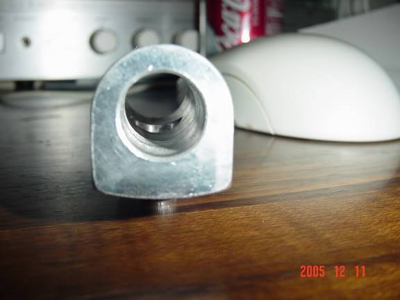

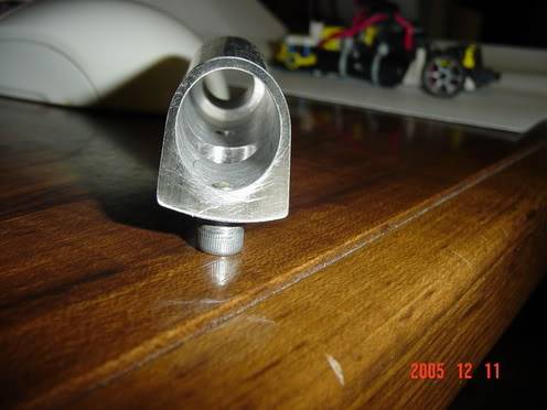

And what happens when it doesnt work? I have the money, but im unsure on if I want to buy it or not. 21 shipped, right? The sample tube that is on mine right now is gigantic. If you want, I could post some pictures of it. Maybe you would be able to identify which tube it is.
If it's GIGANTIC hen it is way wrong for sure. I have the proper ones sitting here. It will work fine.

Oh yeah! Heres what the sample tube looks like.... It doesnt have any markings on it or anything so you could determine what tube it is. To me..... It looks BIG. It must be at least 3mm bigger than the stocker.... Which explains why it runs so lean.
