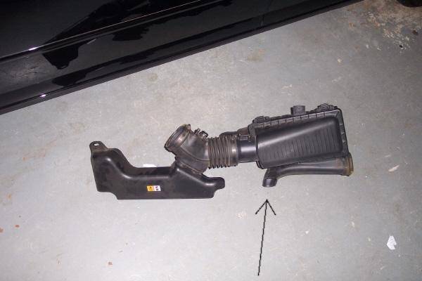

One thing i noticed last time i was under the hood and had things apart is that the snorkel on the stock intake is aimed directly at the incoming air from the grill. I think they designed the factory setup to be fairly effective.
