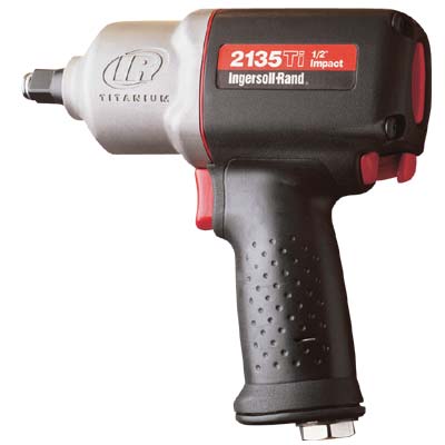

Thanks for the other input, I have an impact gun already, and I also use copper antiseize on EVERYTHING. All the bolts for the valve covers have it in there along with the plugs!
I just hope I don't have to replace studs, it's not that tough, but a pain, as usual. Thanks!

The offical method used in my home garage: 3/4 inch 12 point socket, 4 inch heavy snap on extention, 3 pound ball peen hammer to "seat" the socket. The 4.5 foot chunk of 2 inch gas pipe provides plenty of torque with my 220 pounds sitting on it. Next time around my impact gun will get to chew on 20 new sebring nuts...
