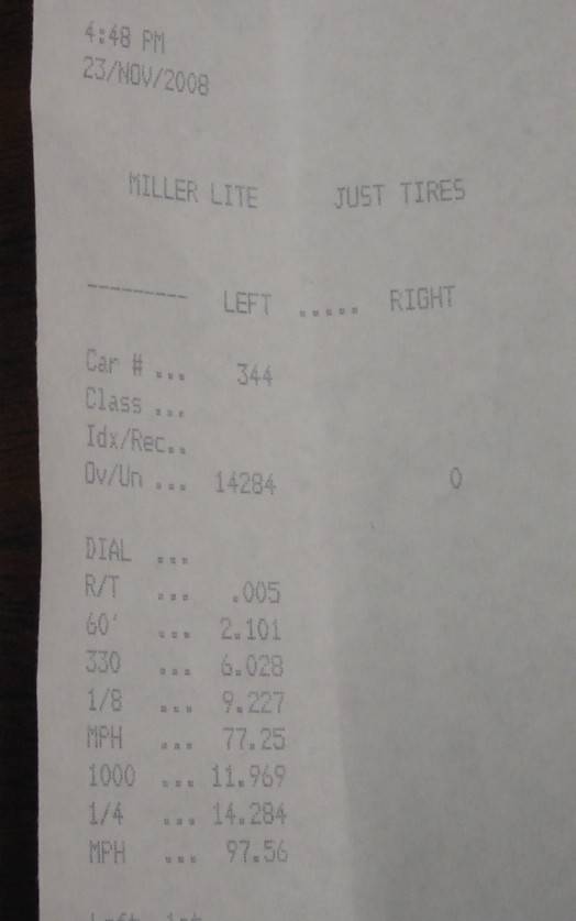

Looks like the 4.10's dont help too much because the tranny gearing is already optimized.
well, a tenth is a lot of time to cut off but look at the 60' You can get a 2.1 with stock gears so he probably did not have enough traction to give it everything. The increased torque for the remainder of the race alowed him the fast 14.2 run. What size tire are you running 02LSE...? Get more traction and those 4.10's will reward you with high 13's no problem.
I also tried launching in a parking lot the other day. once at 1100 and once at 2500. Both bog, but the 2500 gets into the power band sooner and pulls .85g's on my meter (vs.75g's @ 1100). im sure its not too acurate, but it does give a comparison. i will re-program the nitrous controller and try this next year since my tracks closed. its a fine line though, any higher than 2500 and they break loose.
I agree the 4:10s haven't taken the time off I would have expected. But there is a gain. While my bests don't look far apart, the average pass is faster. Car feels alot stronger too but timeslips say not so much. Traction is more of a challenge now but I can get out with full throttle and no spin with decent track prep, low tire pressure and a short burn out.
One other thing to consider is I haven't ran no where near the passes on the 4:10s as on stock gears.
And I am really surprized how much I had to change my launch technique. On stock gears the peddle had to be smoothly put down. The car now likes to have the gas slammed....traction is alot more crucial, but I have been able to deal with it.
Tires are stock Michilins that came on Sport models at 23psi.
