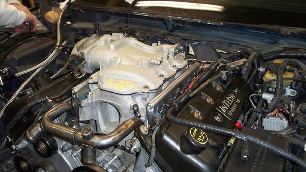

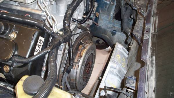

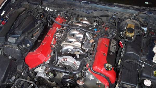

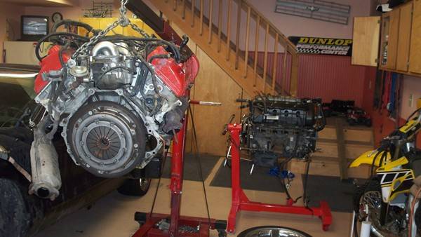

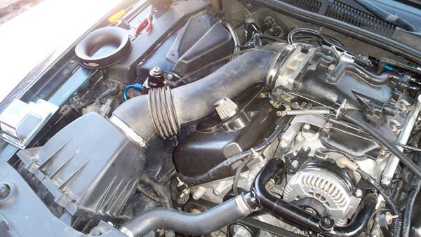

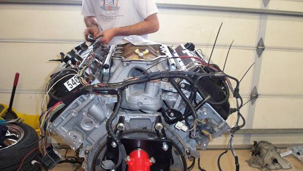

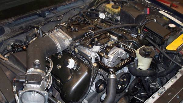

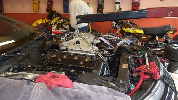

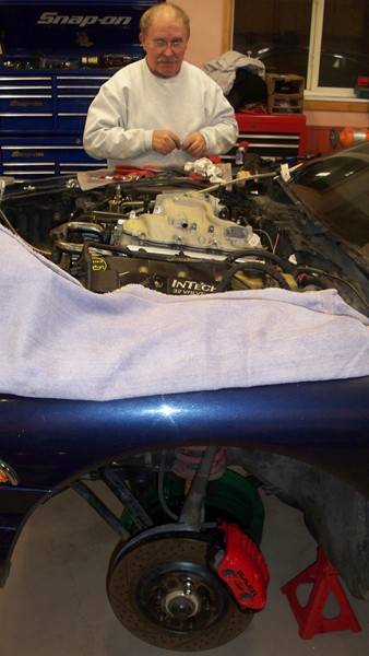

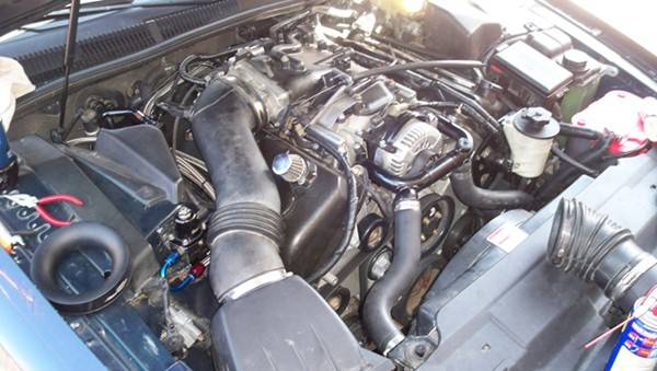

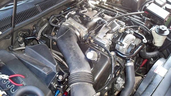

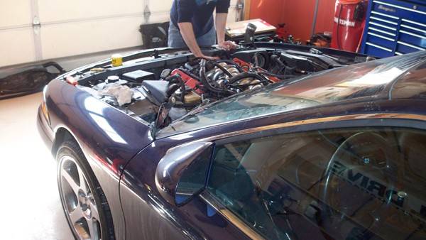

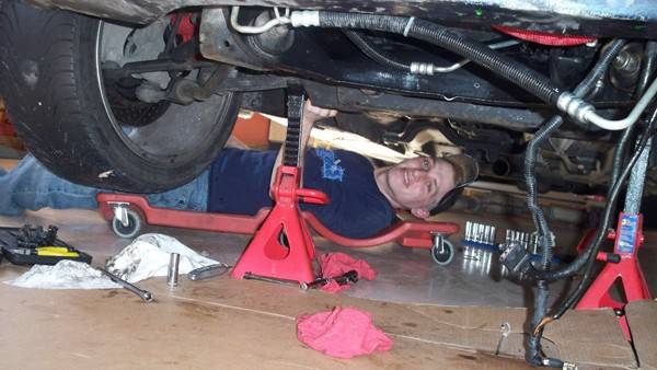

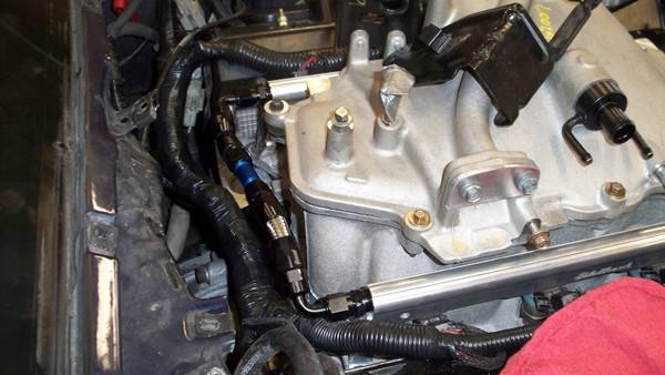

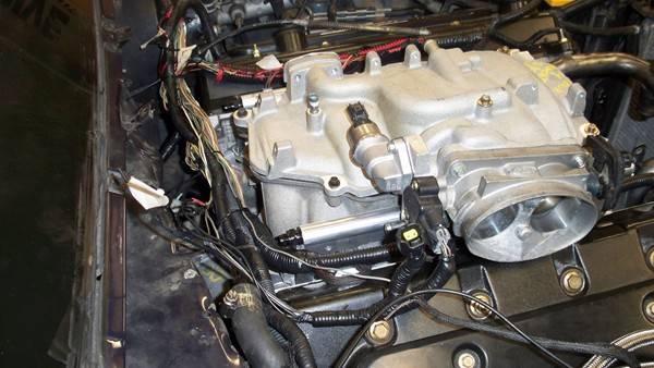

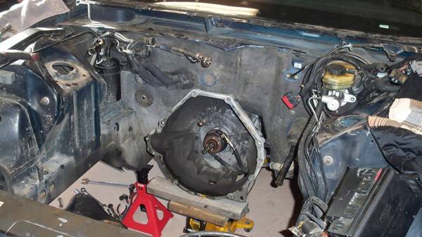

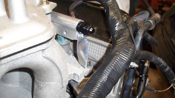

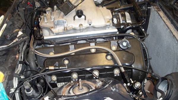

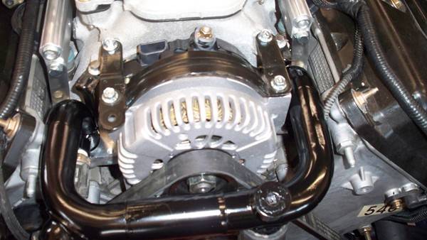

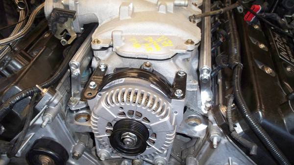

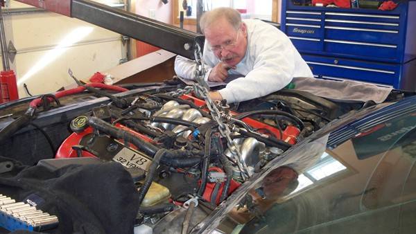

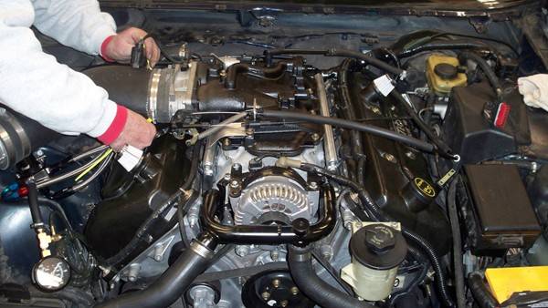

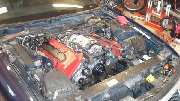

The car is now C-head powered, 3650 shifted, 4.10 geared, hub swapped and cobra braked.
Here are the pics.

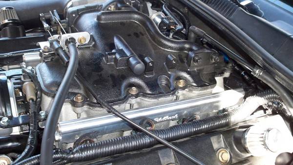

It is an 03 Maruader longblock, 04 Mach 1 intake, and edelbrock billet fuel rails. Running -6 line front to back and is geting a dual 190 LPH pump setup in the next couple of months to support the eaton at 9-10 LBS. After all this is done, it goes in for a quickie paint job.
I want to thank Dad, My buddy Dave (for the use of the garage space and the help with the tedious stuff.) Kyle (screw-Rice, for commin down to help.), and Jeb for listening to me jabber about buying a c head engine for all those years and not killing me out of boredom. (and for the wheels as well).
Pics...Pics...Pics....
If you have any questions.................ask.

looks real nice... how are you going to fit the blower under the hood? getting a cobra R?
steering joint
check with DLF he makes them. oops should have gone to page two.
Nope..... I'm going to do a custom cowl induction hood that is as low as possible. I've had one of the R hoods and don't care for them much.
