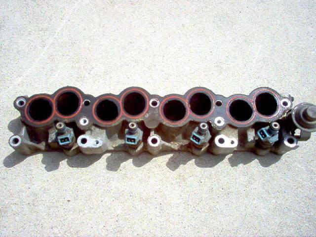

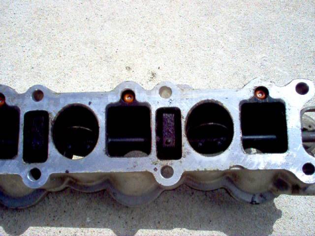

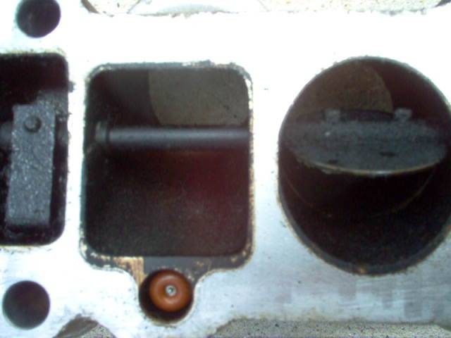

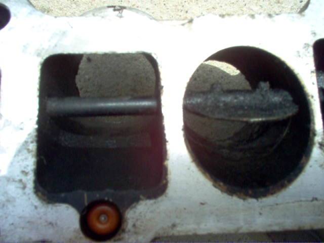

Correction there Craig. Actually, only the air passes over them. The fuel injector is located next to the primary intake port and inject directly into the cylinder. But there is always 'back pressure' so some of the atomized air/fuel mixture along with burnt carbon, etc gets deposited onto the runners by backing up into the intake tract. The primary is the rectangular hole and the secondary with the butterfly is the oval hole. Talk about having a nice obstruction in the intake. The orange o-ring things are the injectors.
The SeaFoam tuneup is a 'must have' as far as I am concerned. Especially with the way our intake system is set up. I bet there is at least 10 horsepower crapped up in there.

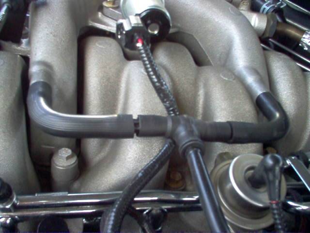

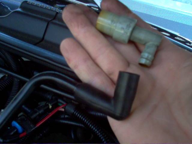

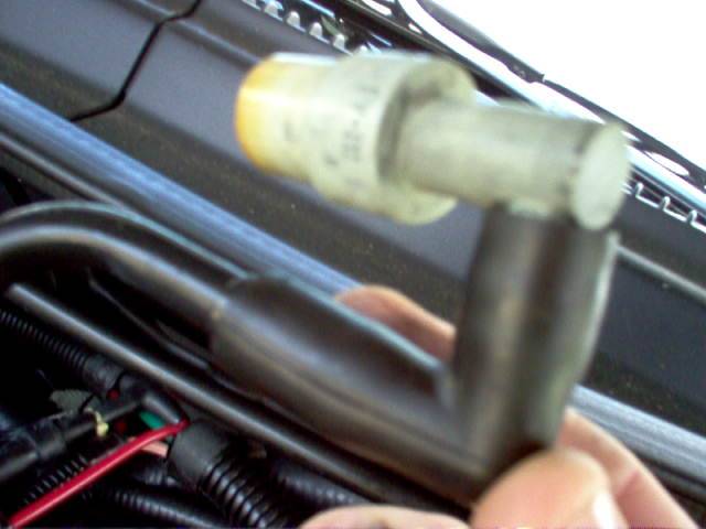

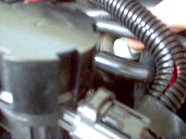

1) Locate the EGR (edit: PCV) on the drivers head in the back. (Its Grey)
2) Pull it from the valve cover.
3) Rotate it to break the seal and pull it from the black rubber hose
4) Gently pull (untangle) the black rigid tube and free it to hang loose.

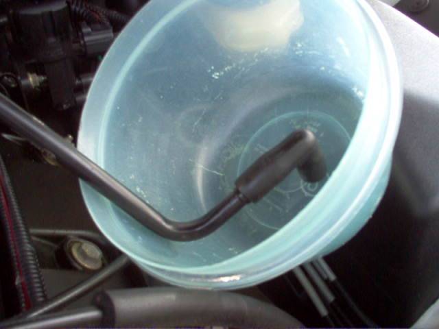

5) Put the seafoam in a bucket so you can control the amount of volume being slurped in. As previously posted, a little at a time to about 1/3 left and then slug the rest down to get the motor to die, if it doesn't choke off. Turn it off immediately. Let it sit.
6) last pic. On the 2nd gen, we have 2 of these heat recirculation tubes going in to the intake to help with cold starts and warmup. I'm too lazy to pull the cover on the 1st Gen to take pics of whats there for you guys. Someone else will have to do. Everything happens on the passenger side on a Gen 1.
