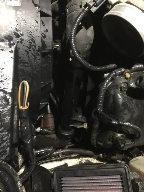

I got the intake tube and filter off, the majority of the spilled coolant is around the lower radiator hose. However, I see absolutely no cracks, holes or anywhere it actually leaked from. I'm at a loss. Will have to tear more into it tomorrow. Is that the only coolant part in that general area? (The lower radiator hose that goes to the bottom of the rad from the thermostat housing and then splits off for the oil cooler)
I will post some pics tomorrow. Imgur updated and I hate the new layout, doesn't make sense to me. Photobucket is still a POS and errors out.
Lot's of coolant parts in that area. It's the most common gen II leak area.

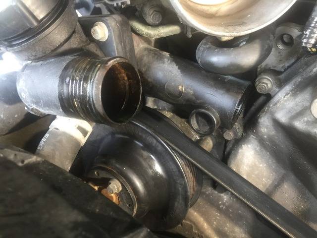

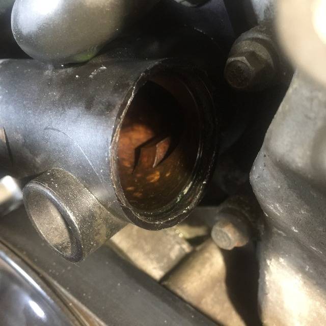

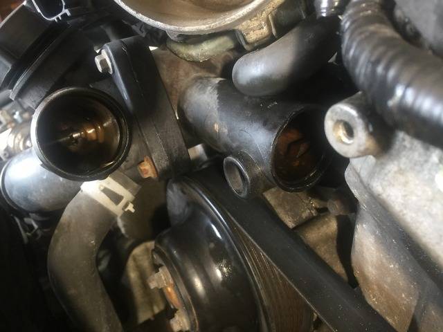

Then I see this...
Whatever the hell is supposed to go right there, is gone. Just a wide open hole off the thermostat assembly...

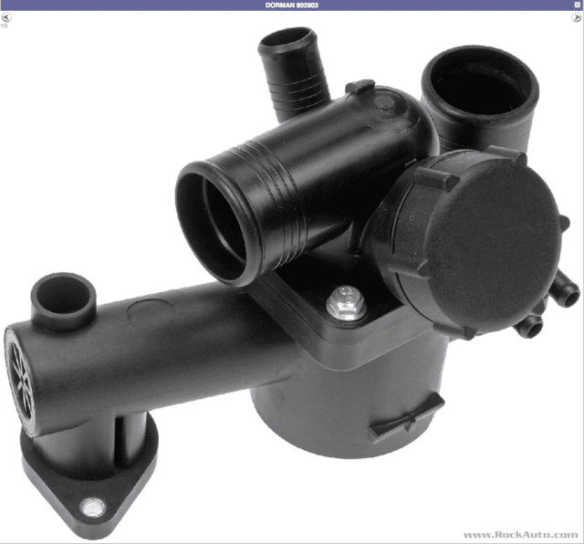

Looking at the Dorman part pictures (NO! I am not buying a Dorman replacement, it was just the first one I found with pictures)
It looks as if some cap/stopper popped off. Probably lightly glued in place, you know with it being such a good design. /sarcasm

Im trying to piece together all these parts, theres so many different threads mentioning so many different parts. -_-

I have a discount from RockAuto burning a hole in my pocket so i'm going to order a few parts of this from them, and on top of that, they are cheaper than buying from FordPartsGiant (Same exact parts and numbers, as well as being Motorcraft)
So heres what I have:
Degas bottle
Degas bottle cap
Main engine fill cap
Upper rad hose
Lower rad hose
Whole thermostat assy (water inlet, outlet, 94n99 elbow) as well as 4 new bolts, and the O-rings/seals.

that is exactly the same thing that happened that started my coolant problems and system replacement.
the drivers side end cap on the coolant crossover tube just blew clean off... it wasn't a part that was glued on, it looks like it was part of the original mold, but as something common that almost every LS owner will have to deal with one day, the coolant parts just get brittle enough that sooner or later they are going to give out.
The good news is that at least with your failure, there is no question of whether or not a part is leaking... the worst thing ever is trying to tell somebody that their parts are failing and all they keep telling you that they dont see any leaks :Bang

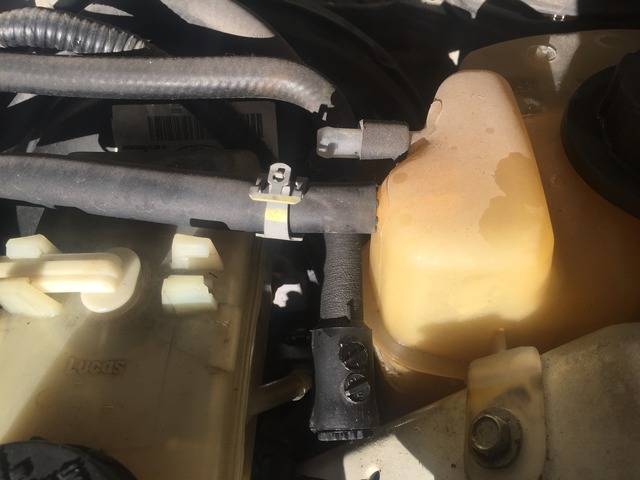

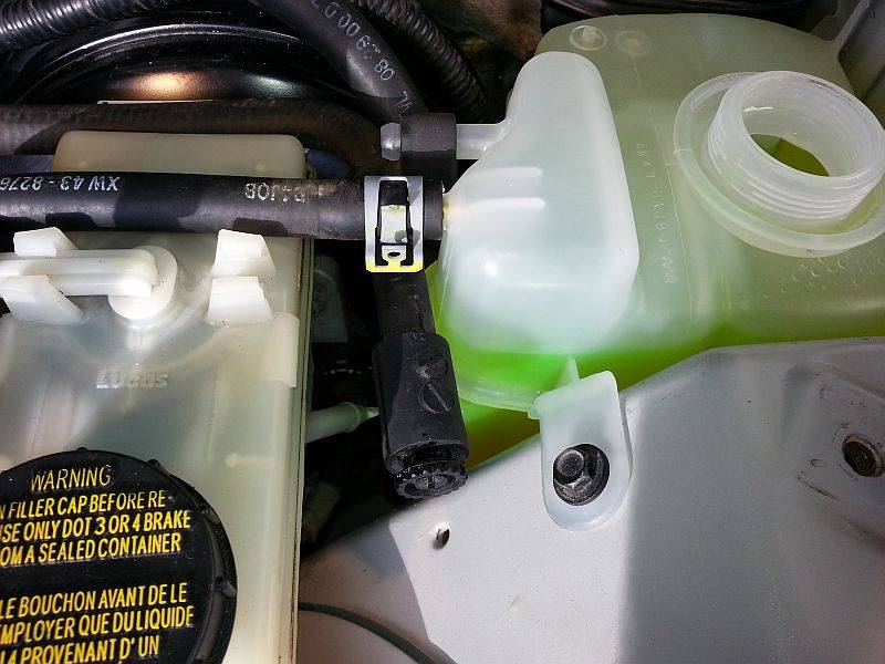

Is there supposed to be a hose on this exposed nipple?
My degas bottle had 3 nipples/outlets but only two hoses. Im assuming thats like a pressure blow off or something, if the cap releases pressure it escapes through there. My Explorer's have had those, but theres a hose on them that runs down somewhere.
Nope. It's closed off. It's just there to hold the heater bleed tube up where you can get to it.
