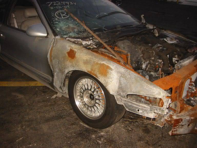

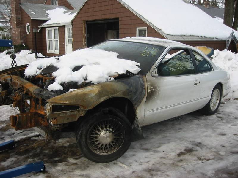

the fire wasnt started because of the cruise control deactivation switch. the switch is behind the pass side front tire, that fire was on the top of the motor, unless someone moved the switch to the top of the intake ford isnt liable for :q:q:q:q, thats not what started the fire, if it was, the car would look like this...
this is a cruise control deactivation switch fire
this is another one...
both of these fires started in the pass side wheel well, not on top of the motor like gman's. the second pic had no tire and amelted rim when it came off the flatbed at my shop, only reason why the wheel is nice looking is i had to put it on to roll it into my shop.

holy :q:q:q:q man look at the pics, yes the car could have looked like either one of the cars i posted, but the fire didnt start in the wheel well, it started dead nuts on top of the intake, so there is no way it was the cruise switch that started the fire, the deactivation switch fires start in the valve block of the switch, not in the fuse box, not in the wire harness, the switch is hot power all the time, when they go bad, the switch fails and starts the fluid on fire that is in the end of the switch, thats why they were recalled, faulty switch, not faulty fuse boxes, or wores 5 feet away from the switch, i'm not always right tommy, but i know i am about gman's car, that fire did not start because of the cruise switch, i'll bet my :q:q:q:qing car on it, i'm not blaming gman for the fire, i'm simply stating he said he did this and that and all the sudden fire, right near where he was working, not in the right wheel well, :q:q:q:qing relax dude.
