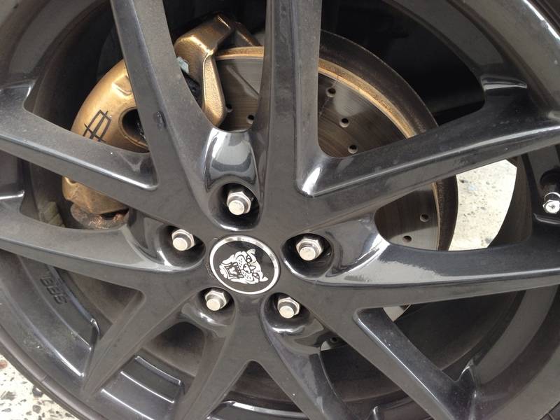

Just got these in today and have begun work on painting my calipers and installing these. Snapped 2 lug nut studs so far though just taking the wheels off so this is going to be a long night...

yeah first time since I've owned it actually which has been almost a year now.
If you replaced the front hubs you have a source for studs :D I have 8 left........
Just picked up a couple and replacement lugs at autozone a few minutes ago. Now the caliper bracket bolts are being a pain in the butt...

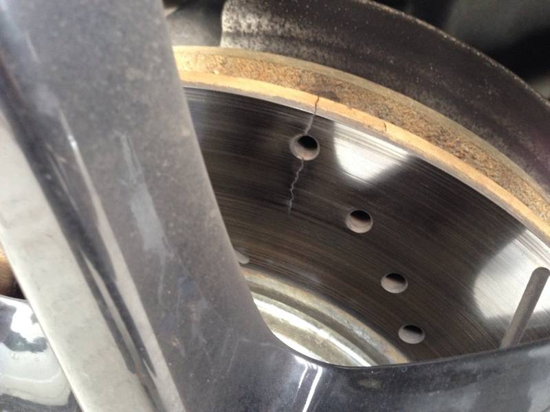

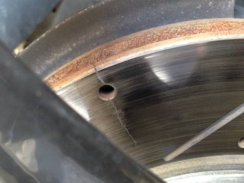

Cracks on both rotors
After only 5-6K miles, I found cracks on both rotors. I tend to drive my LS fast and do some occasional high speed braking, but I don't track it or do any type of driving that could even justify this. I haven't contacted Brakemotive yet and I'm sure i'll have no problem getting them replaced, but I don't want this garbage on my car anymore. Maybe I can negotiate some sort of refund. I don't know :mad:
Passenger's side
Driver's side
YOU GET WHAT YOU PAY FOR!
