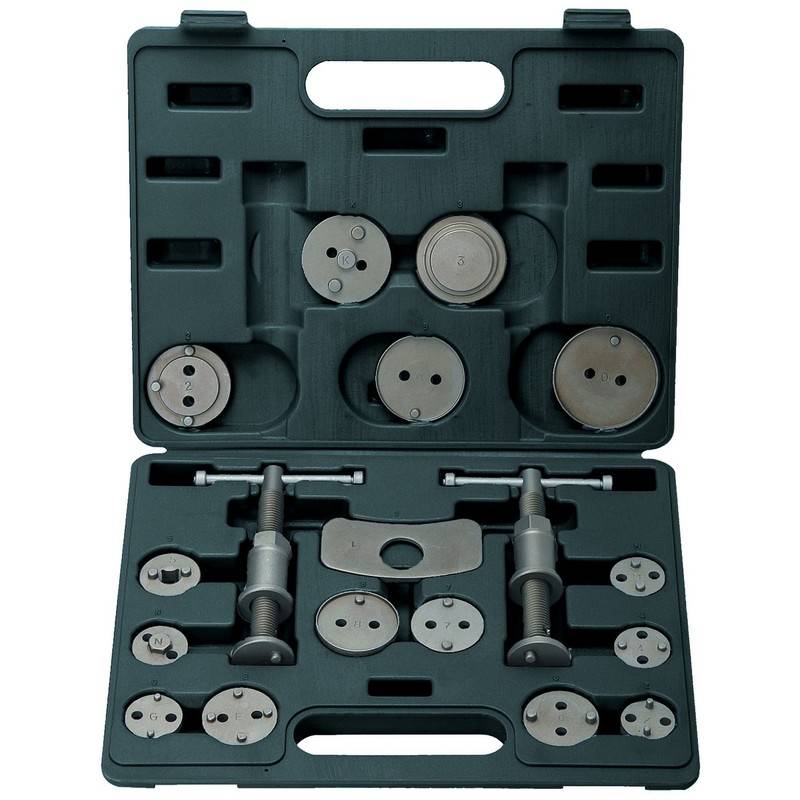

The caliper tool works perfectly. Use the right hand threaded tool and the #7 piece. I thought it would be a bit easier though. It takes some force to get those things to turn. I also bought the Husky 20~250 ft-lb torque wrench. ($80) It worked perfectly as well. I wanted it done right. I don't want to warp my new rotors the moment I put them on the car.
