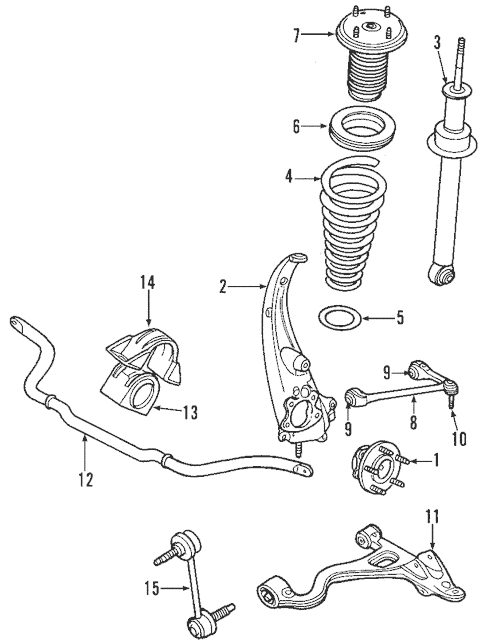

I take it from your reply that the front lower spring isolators must be discontinued? If that is the case, would an aftermarket brand be a fair substitute? When you refer to lower front spring isolators, do you mean what Jaguar calls "spring seat" which is #5 in this picture?

#5 in the picture... is not a spring seat, (or isolator). It is a "shim" to restore factory ride height... to keep the suspension geometry "in spec". They are stackable to compensate for sagging springs. The only reason I know this... is because I ordered some thinking the were the isolator.
