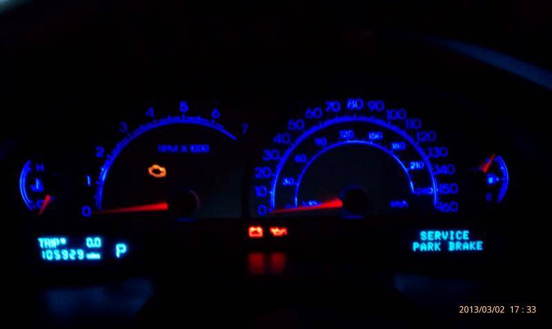

To get the info boxes blue I took plexiglass and painted it stain glass blue then inserted it in behind the guage panel.
So the plexi infront of the info display isn't green?.
On a stock display yes, on mine no. You have to cut the clear window out of the overlay, then modify in a blue film if you want it to match.
Only gripe I have is the display output for both windows is extremly bright, almost like the original film on the overlay was a dark tint, so after it was all done the display boxes are pretty bright at night, but you can scroll through and select the RH box off. It's nothing crazy tho...
The vacuum fluorescent display color output is closer to blue than green. That is why it is brighter with a blue filter in front than with a green filter in front.
