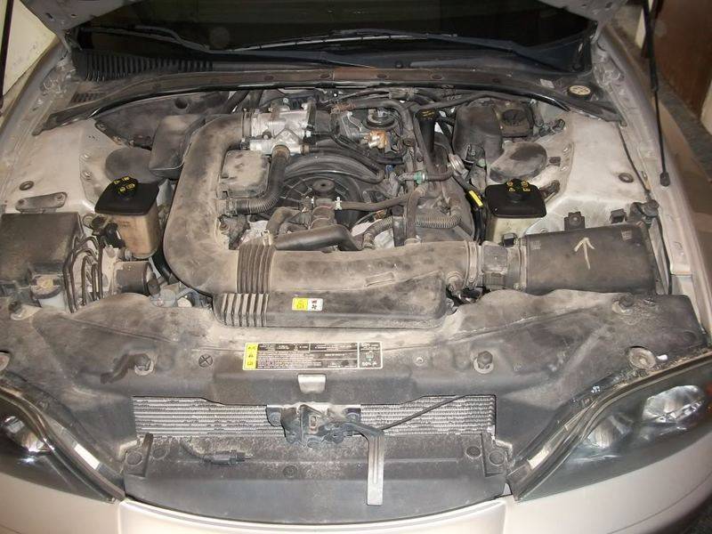

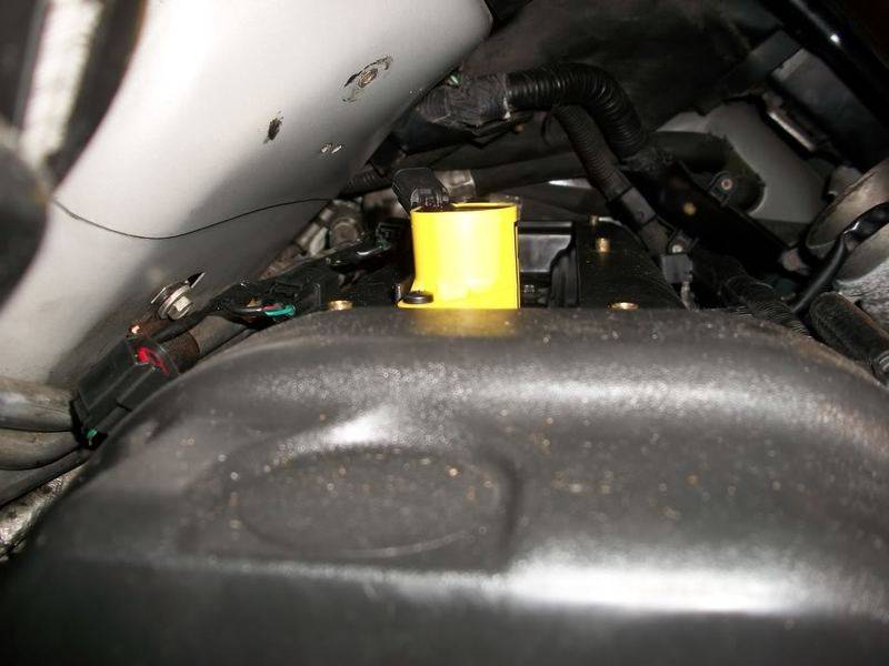

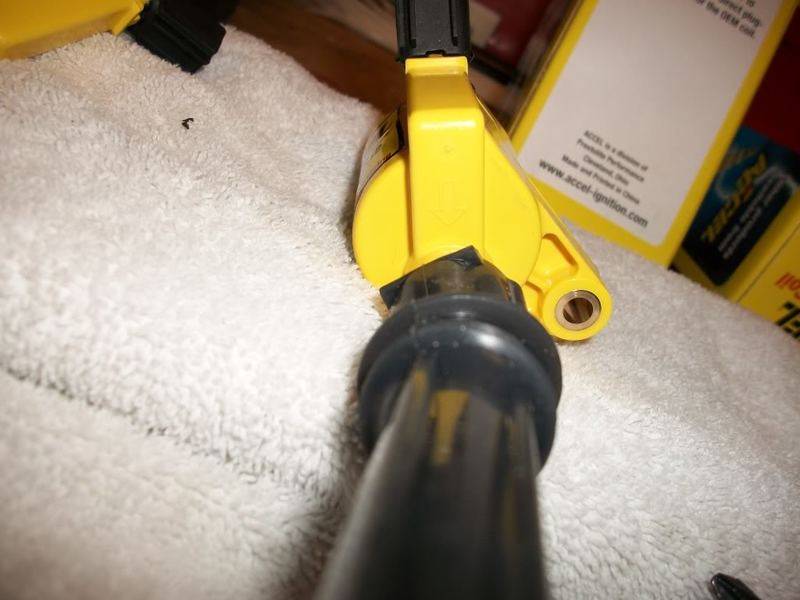

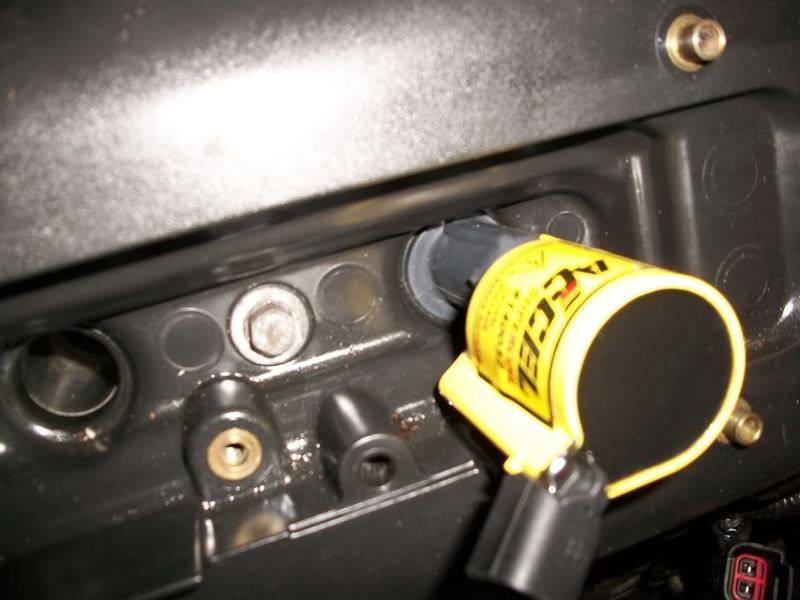

So I completed the electric cooling fan conversion, installed a new DCCV, fabricated an intake heat shield and installed the Accel COP's. The car cranked several times before it started but ran beautiful. I figured the cranking several times was caused by having the fuel line disconnected while replacing the VGC's. Then I realized that wasn't the cause. I drove it for two days and decided to park it untill I get the hard start problem fixed so I don't fry the starter.
I have removed the fuel rail and injectors and found one injector with rust around it and it looked very dirty. I ordered a remanufactured set of injectors and I am currently waiting on them to arrive. I also plan on replacing the fuel pump for good measure. I'm leaning towards using the Walbro GSS342 255lph high flow pump. I'm not sure what power adders I may decide to do in the future so if I'm already in the tank, I may as well upgrade now. I believe Pektel used this pump and said it only required a slight modofication to the pump housing. But I am going to get the car running with the new injectors first to see if the cranking problem is fixed.

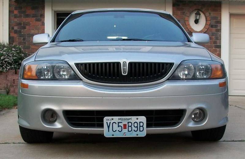

I have also painted the upper and lower grills black. I think it looks alot better than before. I also fabricated a custom license plate bracket for the front bumper since Missouri is one of those stupid states that requires a front plate. The good news...the plate hides the crack in the lower part of the front bumper.
