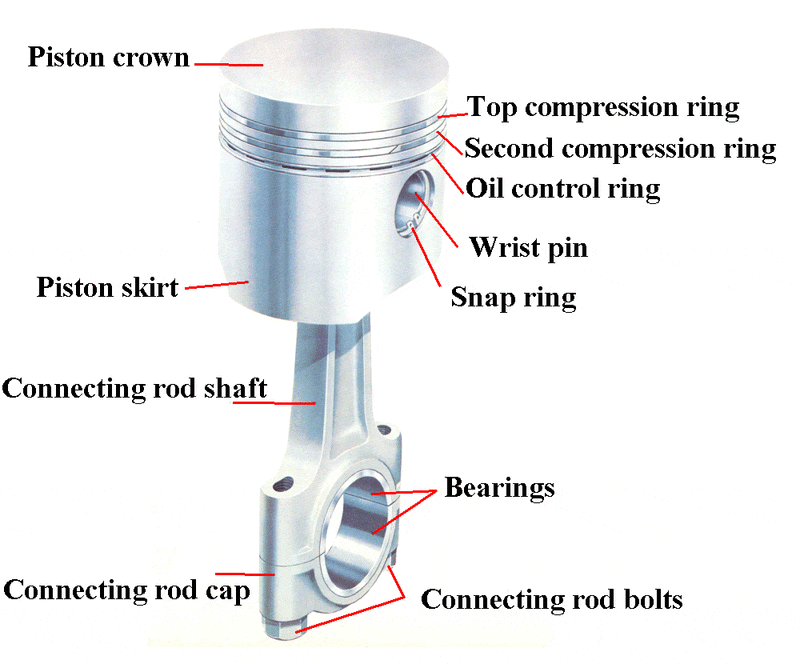

Just for clarity here...
If you can see a rod through the spark plug hole, then you are really, really in bad shape.
What you meant to say was that you don't see one of the pistons moving. No movement at all would indicate that you didn't just bend a rod, but actually broke one.
None of this alters your situation or your needs, just trying to do a little "education."
and just to edjamicate a little more...
