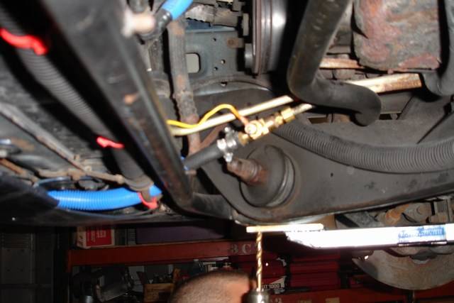

I took the opportunity of access to the lift to install front suspension braces...
and new brakes.
It was not without incident however. After 2 rounds of breaking in the new gears, I proceeded on the long trek home. About 50 miles out a terrible vibration started from the rear. Nursing the ailing car back to the shop, I was convinced it wasn't the new gears but perhaps a failing wheel bearing. Once finally back to the shop, it didn't take long to find the culprit. Apparently one of the rear rotors was not drilled/chamfered properly not allowing the rotor to seat on the hub! As a matter of fact, the wheel studs were forced slightly back from mounting the tire and two had broken from the stress. After chamfering the rotor backside for clearance and installing new studs, the brake assembly was replaced and the wheel installed without any problems.

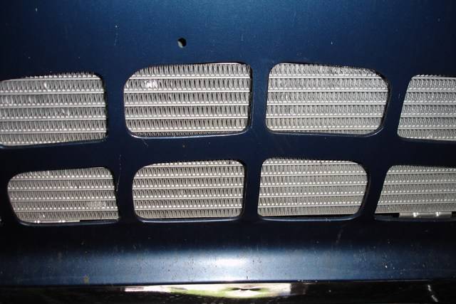

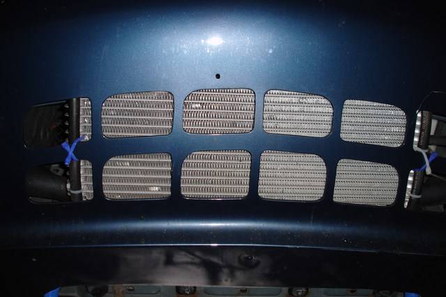

Also, here's pics of the new and improved 40K GVRW tranny cooler.

Where did you get the rotors? It seems the manufacturer did you a disservice.
The front braces are the original Kenny Brown Performance issue I received from someone whose Mark VIII had an untimely demise. I have had them over a year, just never got around to installing them. I have the rear cover brace and a torsion brace. I had to modify the torsion brace to clear the dual 2-1/2" exhaust. I have an RSTB waiting to install as well. I am still needing a pinion brace and rear subframe connectors. I had a Cobra pinion brace modified to fit the Mark but it did not clear my exhaust.
The rotors and pads were from someone who sold their Mark VIII before they were installed, so I do not know where they exactly came from. They had "KVR" on the pads, but no identification on the rotors.

After test fitting the location and procurring the rivet supplies to fasten the cooler to the bumper cover, it occurred to me I may not want to drill the holes in the bumper cover until it was shown the location would be functionally adequate for proper cooling. So armed with wire ties and sections of spare hose for 'padding', I secured the cooler in place without actually drilling holes in the bumper cover.
  • During the heat wave, beating on the car hard barely made over 190*.
  • Normal highway temp 150*.
  • Again, in the heat of lately, idle in traffic at about 180*.
So far it looks like it has no problem functioning there. I have a 180* thermal bypass valve yet to install if needed and the temp sensor is immediately after the cooler recording the coolest temps.
