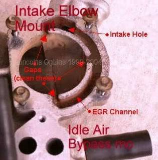

The EGR - It is on the BACK of the engine - aft and outboard of the elbow that the throttle body attaches to - kinda of a PITA to get to!
At about 120K my 93 started pinging under load and finally threw a check engine light - I talked to a couple of guys at work with TC's and they said to take it to the dealer and have them do a upper intake cleaning - it would take care of it.
I did a bit of research and ended up pulling the EGR valve, the TB and elbow and disconnecting the egr pipe from the exhaust - scrapped and cleaned all the carbon deposits from the EGR passages and reassembled everything - took an afternoon and about $20.00 worth of gaskets and cleaner. - fixed.

- EGR - where is it?
EGR Valve
Removal
1. Raise vehicle on hoist. Refer to «Section 00-02».
2. Disconnect exhaust gas recirculation (EGR) tube from EGR tube connector.
NOTE:
Hold EGR connector with a wrench while disconnecting EGR tube.
CAUTION:
Use care not to damage EGR tube.
3. Lower vehicle.
4. Disconnect vacuum hoses from EGR tube and valve.
5. Remove two retaining bolts from EGR valve.
6. Remove EGR valve, gasket and tube from vehicle.
Installation
1. Transfer EGR tube to new EGR valve.
NOTE:
Do not tighten line nut on EGR valve at this time.
2. Position new gasket and EGR valve assembly into vehicle.
3. Install two bolts retaining EGR valve to intake manifold. Tighten to 20-30 N-m (15-22 lb-ft).
4. Raise vehicle.
5. Connect EGR tube to EGR tube connector. Tighten line nut to 35-45 N-m (26-33 lb-ft).
NOTE:
Hold EGR tube connector with a wrench while tightening line nut.
6. Lower vehicle.
7. Tighten EGR tube line nut at EGR valve to 35-45 N-m (26-33 lb-ft).
8. Connect vacuum hoses to EGR tube and valve.
http://www.lincolnsonline.com/tech/00126.html
As you can see service manual is not very detailed as to exactly how to do it, and like the members have mentioned it is a bit a PIA hopefully images can help ya out a bit.

the iac valve is the round peice that has a 2 wire connecter on the upper intake a couple inches past where the rubber intake hose hooks to the intake. 2 bolts hold it on 8mm socket or wrench. take it off and take it apart (phillips screwdriver)clean the valve inside with carb cleaner. the egr is also on the intake looks kinda like a mushroom with a vacume line and or wires going to it also remove and clean carbon deposits from it. also replace the gaskets on both.if you cant figure it out go to the parts store and ask them to see each one. also get a manual for the car they are priceless for that kind of repairs
