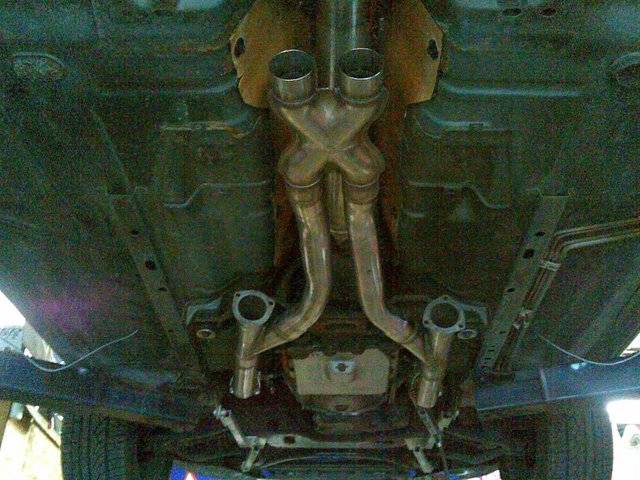

Here are some pics of the work...

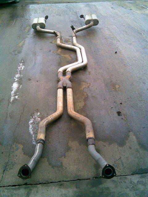

Old soldier removed from service.
Note the sloppy work on the downpipes.

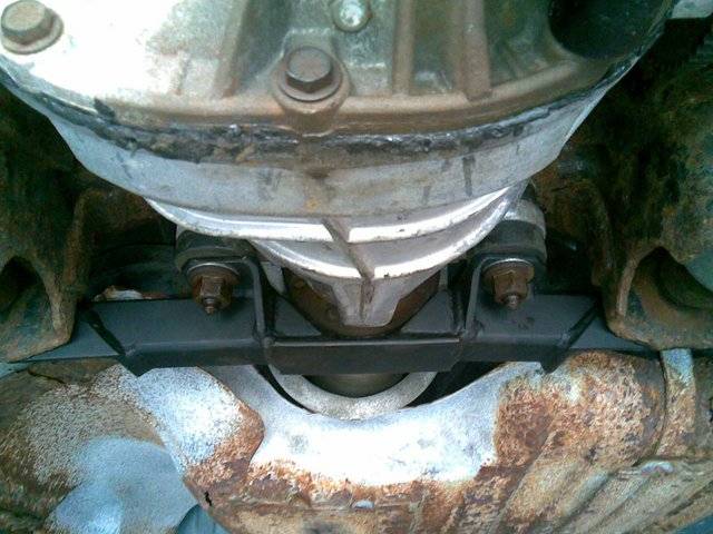

The long awaited pinion brace installed with the exhaust pipes out of the way.

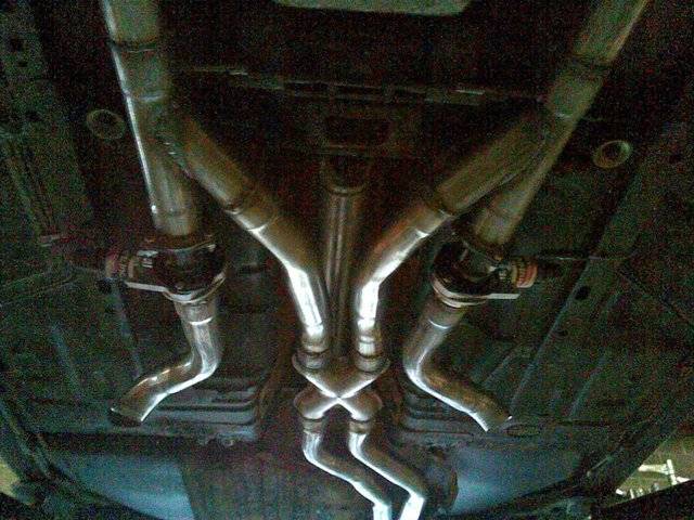

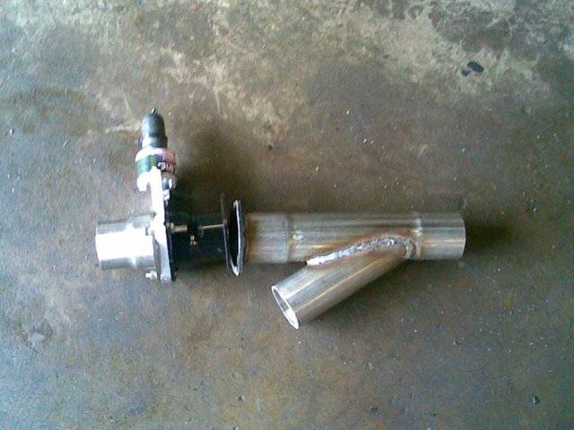

The electric cutout, flange adaptors and Y-pipe.
The downpipes, Y-pipes and X-pipe in place.

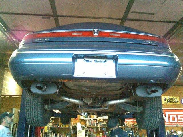

The rear view of the Hooker Maximum Flow mufflers.
The sound is just awesome with the new mufflers. I still have the electrics to hookup before I get to hear it through the cutouts. Then we'll get a vid with a couple sound clips posted up. [cowboy]
What are the pipes that extends outward go to?
Nothing. :D

Seriously, it's new technology applied to old school fun - open exhaust via cutouts simulating running open headers. But instead of crawling under the car and uncapping the cutout or using a choke cable to pull the cutout valve open, you push a switch and let the HD electric motor do the work.
Whether or not it helps performance wise will be told soon. ;)
Nice JP, I had the cutouts in the same location in my 95 LSC... gained 2mph over the stock LSC piping and Dynomax Ultraflow mufflers. The only thing I don't like about your setup is the Hooker mufflers look like they way a lot compared to a Bullet or no muffler setup...

Also on a side note, were the cutouts mounted where they are because of their size? Cause that's one hell of alot of reversion from how they are installed, it would seem to be a straight run if they were swapped from the other pipes.
