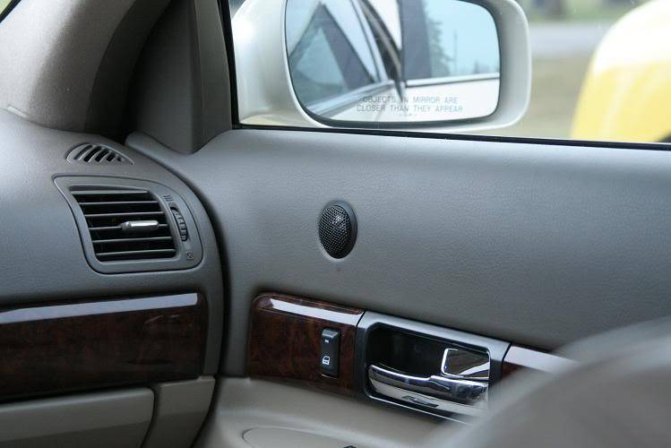

I have the tweeters flush mounted in the doors:
If I were to do it again, I would try to mount them in the a pillar, pointed a little towards the windshield. maybe about a quarter of the way up the pillar. But as has been pointed out, I don't know if flush mounting would be a possibility.

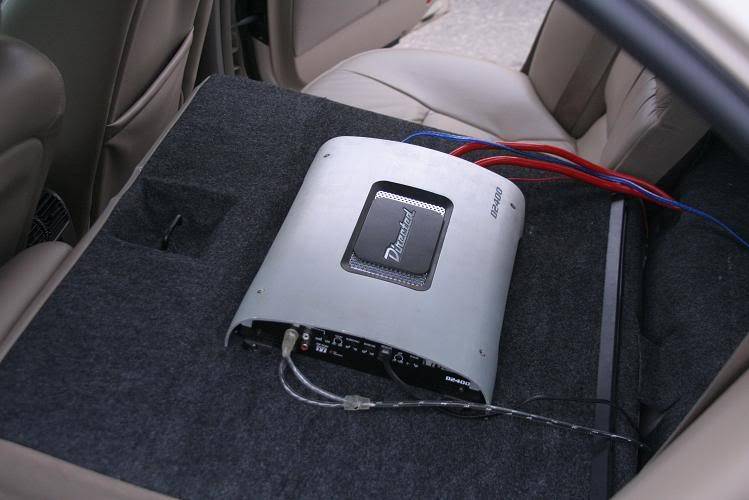

And the amp for the sub mounted to the back side of the rear seat. Probably the most common place for mounting it. I still have to clean up those wires. The amp is relatively new to me:

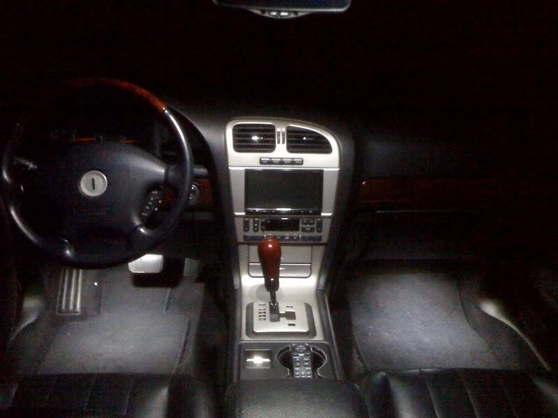

and i wanted to do a single din with a flip out touchscreen but i didn't like the fact that it covers the middle AC vents. so i just decided to go with something that sits in there like that.
Why not go with a double din & have that nice factory look that comes with it? You can get some nice double din units for good prices now. Here's a pic of mine with my JVC before I put my pioneer in.

and dennis, that is what i am going to do. Other people were saying have a single din with a flipout monitor but i didn't like that it covered the AC vents so i went with a double din touchscreen unit for that factory look that you have.
