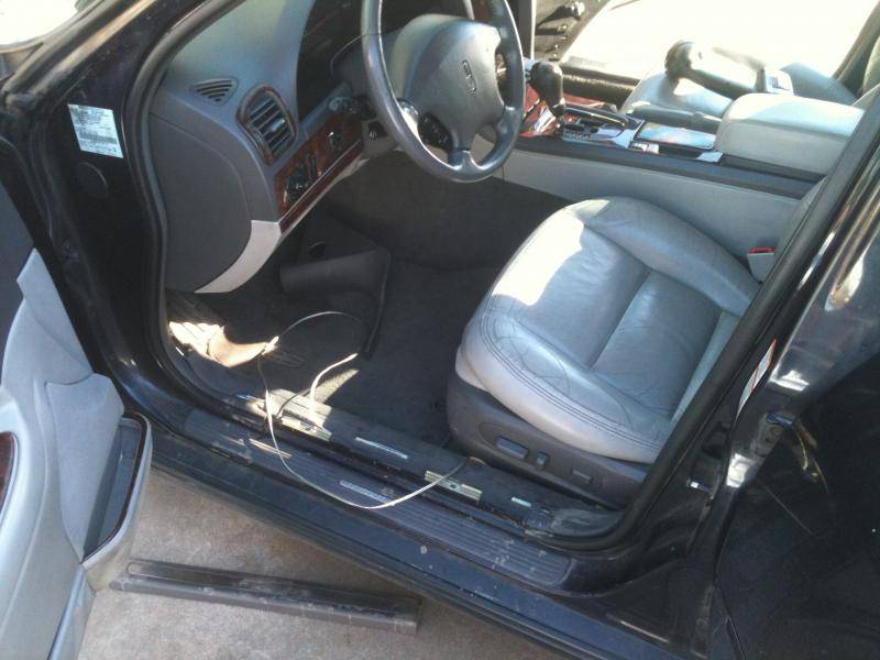

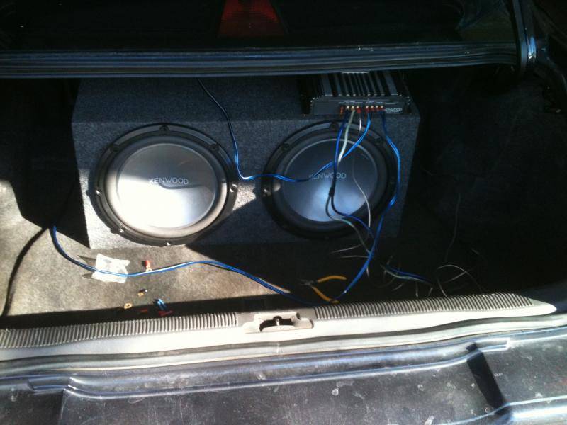

to answer a couple questions. I know that the wiring looks terrible. I tried getting it through on the driver's side. too many computers to get it through. doing the passenger's side wouldn't have been an issue but i just didn't want to do one differently than i did the other. I know it sounds stupid, but i swear that's the reason. If there's some insight all you guys care to offer on the wires then go for it and i'd gladly rewire them. As for the tweeters, i'm planning on getting something to cover up those wires and make it much more stock looking. don't worry. And no, i'm not taking it as criticism so don't worry.

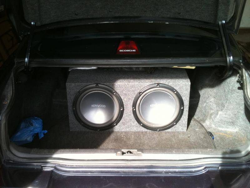

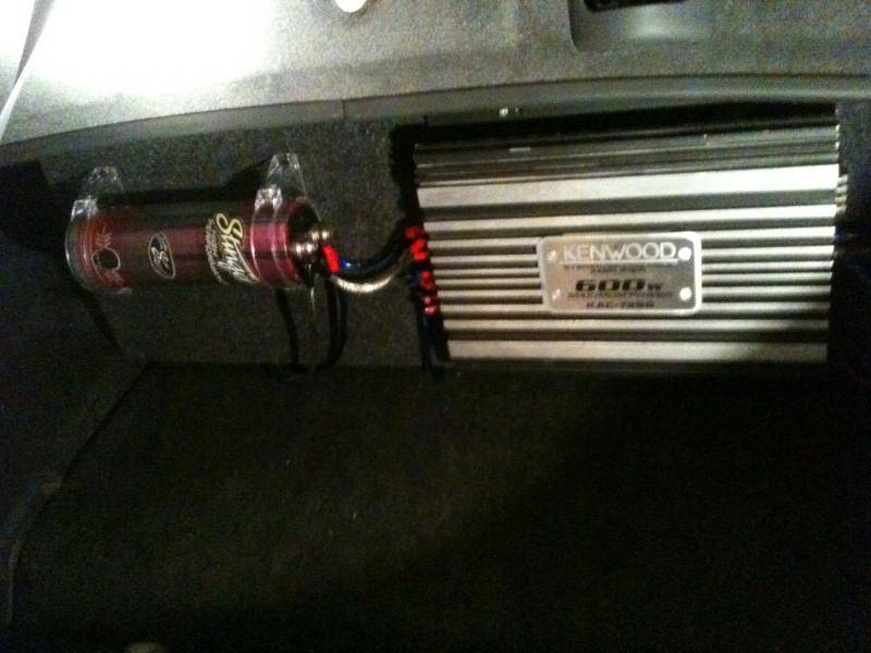

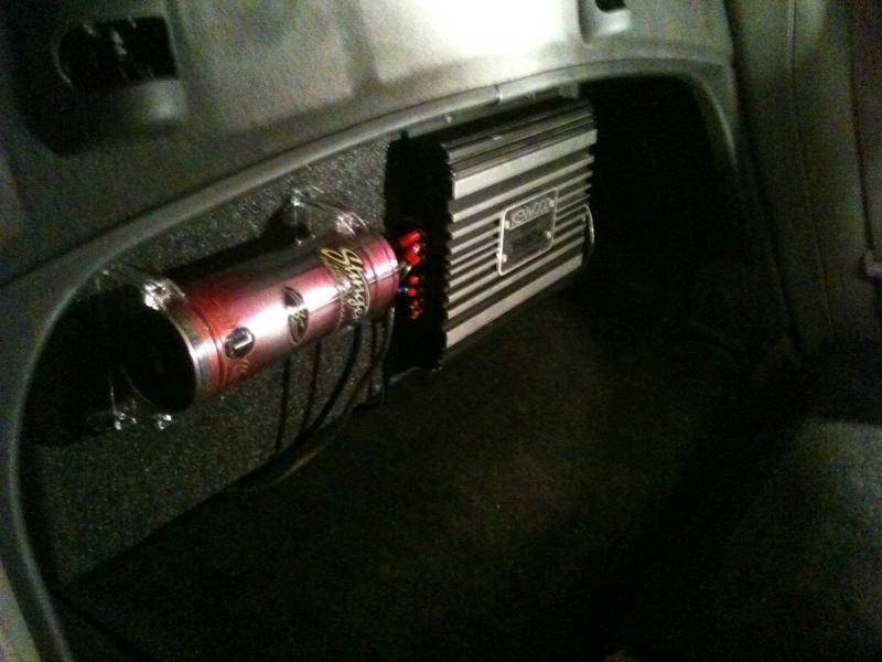

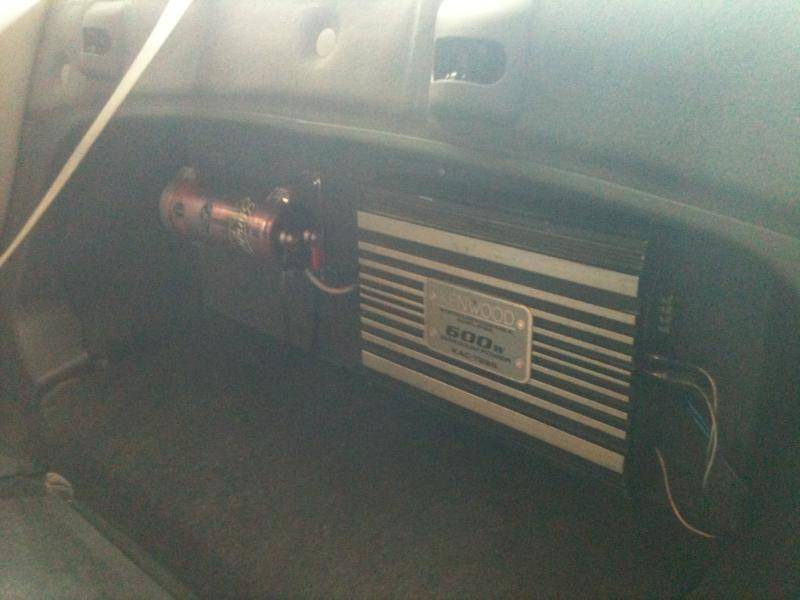

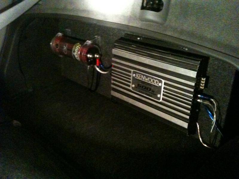

as for the amp on top of the sub box...i do have a question. for some reason my subs seem to have stopped working. could this be the reason? I've never encountered this problem before and i went around and tore the car apart double checking every single connection. the fuse is not gone on the amp, and the RCA's are working. and there's absolutely nothing loose. If it makes you all feel better i can put it on the back of the sub or something.
too many computers to get it through...If there's some insight all you guys care to offer on the wires
yea those computers can be removed or just moved out of the way, just unbolt them.

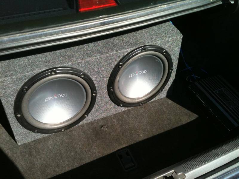

the only reason i said to leave out the factory sub enclosure, is because of it, you cant slide the sub box back at all and your just wasting space, i even recommended a way of putting those speakers in with out the enclosure to be able to have speakers and space
sure could be
well if the amp doesn't have a thermal protect circuit, it could have over heated itself to death, are you sure that you are getting enough power at the amp? good ground and 12v at the power and turn on terminals?
-makes sense. Just didn't think about it at the time. Thanks for the suggestion though.
- yep, i do. but if it was fried, would it even turn on?
bust out the digital multimeter and check if the subs are still at the ohms there supposed to be at.
you could also take a spare speaker and hook it to the amp on both channels to see if its the amp. Or if you have a spare amp hook that to your subs.
i did that. it's really complicated. The speakers didn't work...but the RCA's that go to that amp are specified to be for the subwoofer. So they wouldn't even work if i put other speakers up to it, would it?
and i do have a spare amp. I hooked it up, and the subs worked. well. sorta. they were playing music. like words and all that good stuff. they weren't actually playing the low end frequencies like they're supposed to.
I can just get some y adapters and use the other amp...i like the other one better anyways, but how do i get the subs to behave?

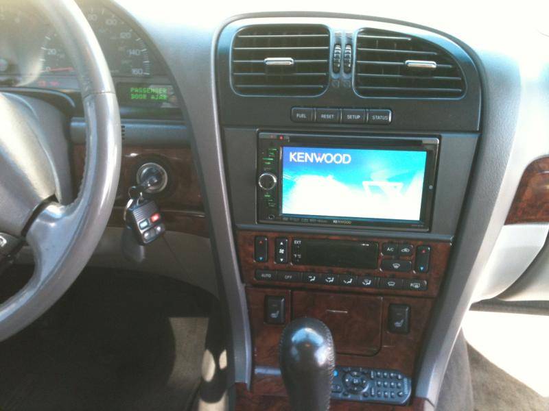

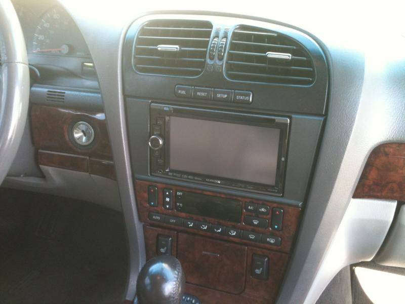

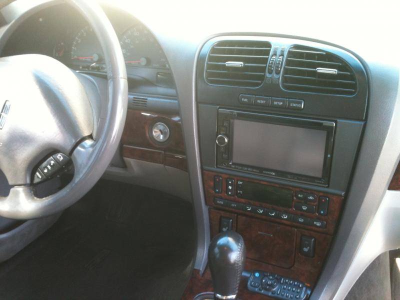

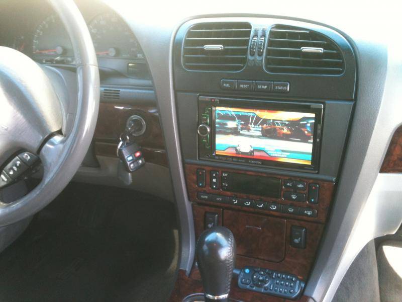

hmmmm...Do you have a sub-level option on your head unit? Such as: subwoofer on/off? If there is then there might be a level for you to turn it up aswell..
It does, but it does not allow me to press it. almost as if there's nothing connected. But i just pulled it out today and it's all plugged in. It just really makes absolutely no sense.
Make sure the Zone function is off on your head unit. This may be keeping you from turning on the sub output. Also, one way to clean up your wiring would be to get spacers for the amps on the backs of your seats. Then make a slit in the back of the seat and run the wires up through that slit and out from behind the amps. You won't see any wiring at all.
DO you have more than 1 set of RCA connections on the back of your head unit? Just pointing out something obvious, but maybe your sub rca's are not hooked up to the sub out set.
yes they would still play some sound, they just wont be able to take a lot of volume, and the freq's they would play would be out of their comfort zone
this definitely shows that either they are plugged into the wrong rca ports at the back of the radio or that the sub settings are not correct in the radio (LPF)
the kenny are a little trickly in the menus, before you can adjust the sub settings, they need to be turned on and i think that its in a different menu
and depending on what the problem with the amp is , yes it may turn on, but still have no output, but it definitely sounds like the problem is with the amp itself
all right my display of the kenny 514 isnt working right now so i cant go through the menu but i think its similar to the dd units, so go into the settings by touching the wrench (not by just adjusting the audio setting outside of the system menu) then go to audio control and then make sure that the sub is turned on, then click on Xover and set it to somewhere around 80-100hz instead of "through" and then you shouldn't get any more voices

Like I said before, you need to use the SUB OUT rca outputs in the back of the head unit. I bet the RCA's from your sub amp are not plugged into the correct set of outputs.
do you have the unit bypassed, or the parking brake set? with a lot of units if the p-brake is not set(or the unit is not bypassed) then the unit will lock you out of certain options (along with locking you out of watching any videos)

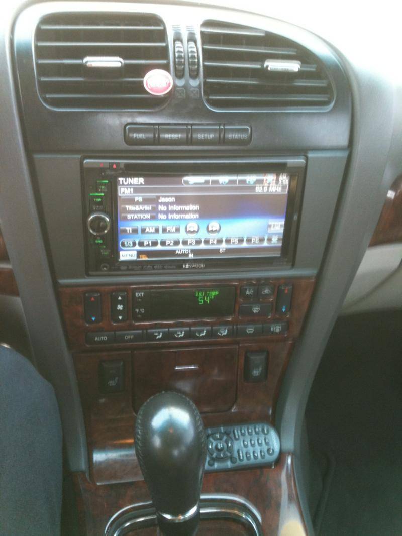

This is my second ls. I had totaled the first one back in 2009. I was very excited at the opportunity to install another system in an LS. If you have the experience the LS is a fun install as well as rewarding when its done.
If done clean and right it looks amazing. I had installed a pioneer system in the first LS and decided to go kenwood this time other than the 4 door speakers i got the new pioneer 3 ways and love them. A member had posted that the LS is not a good first time install and I would agree with that. Being in my mid 30's and having done several different installs in several different cars and trucks id say the the LS is one of my favorites. My install is somewhat basic but its clean. I want to be able to keep a spare and be able to remove the box fairly easy if i want.
I will also say a double din is the only way to go in one of these cars. Flip outs don't look bad but if you can fit a DD in a car why go flip out in my opinion. That to and i have had 2 flip outs go bad on me so im a little Leary about those anyways.
