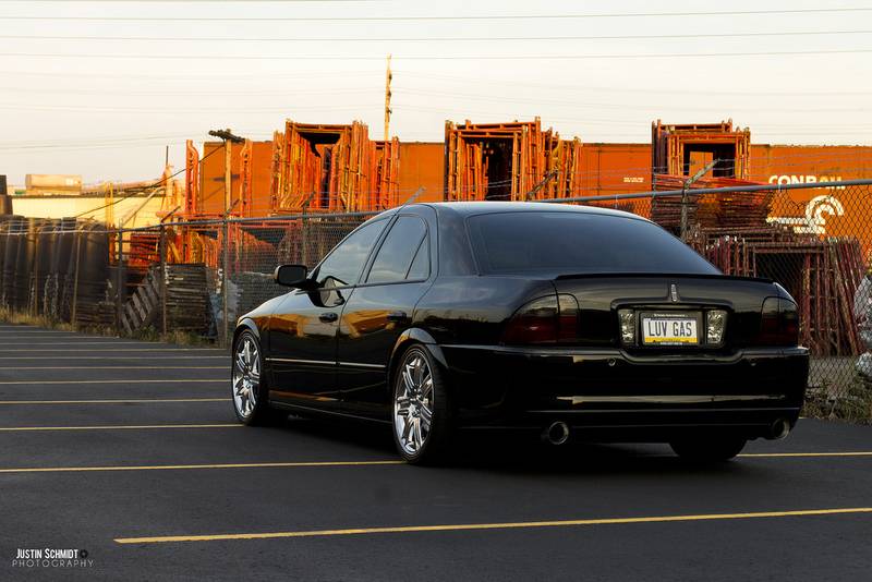

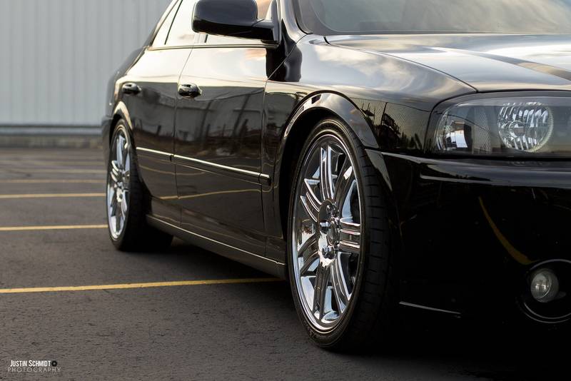

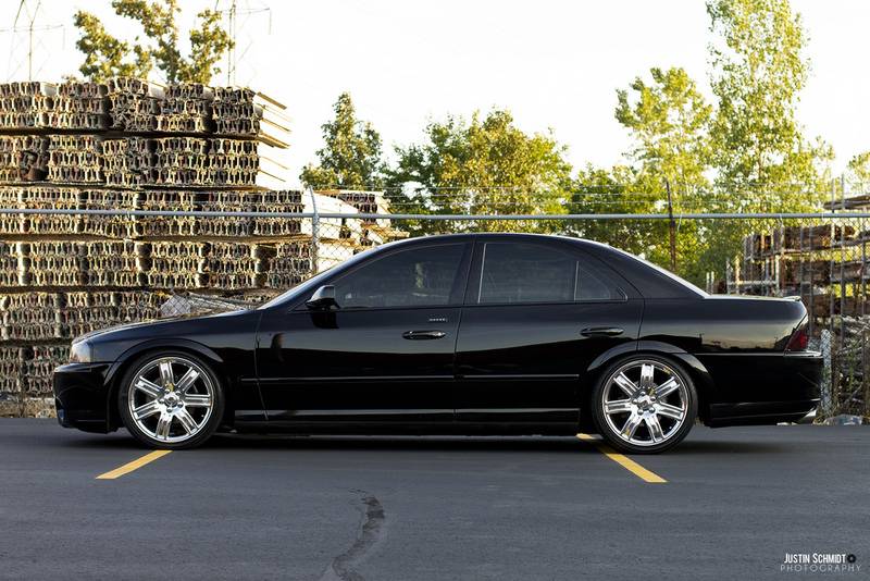

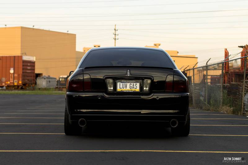

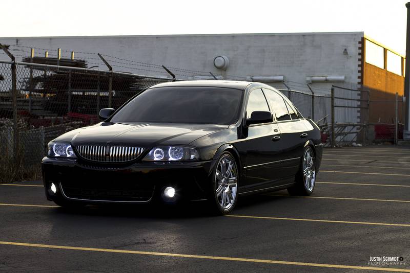

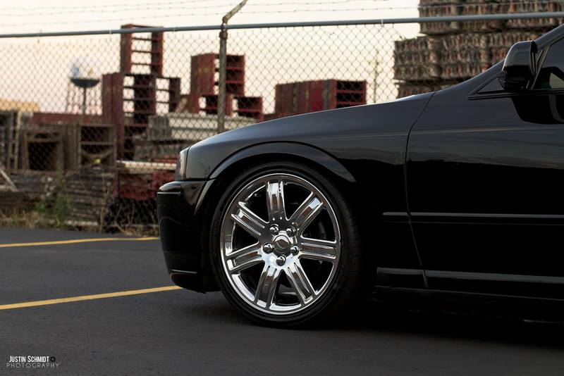

The moment you have all been waiting for is here. Try to keep it in your pants
I still need to take off the wheels and get some pictures of the coilovers themselves, I hope I can do that tomorrow.
Eye Candy :cool:

I was just talking to tony starks about needing a new background :D
That look sick man
Beautiful!
Really need to get a photoshoot of this quality together for a large LS meet. I want to be there!!
