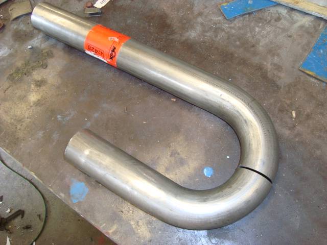

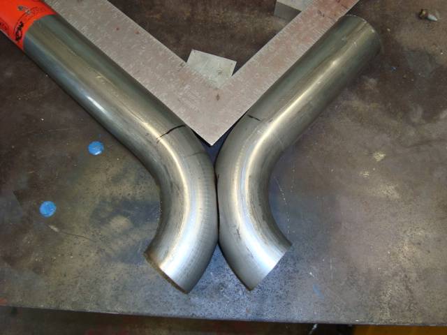

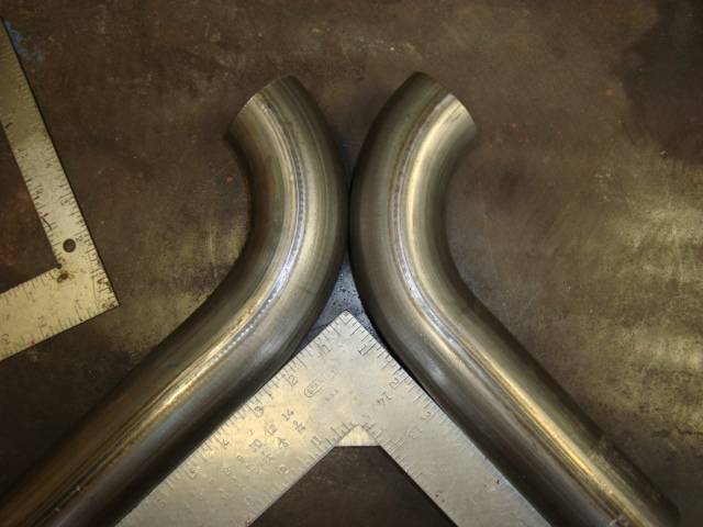

2.25" 'J' bend, soon to be an 'X' cross over pipe.
At the welding bench, the square is sitting on some 1" blocks. Used another straight edge to eyeball the first cut.

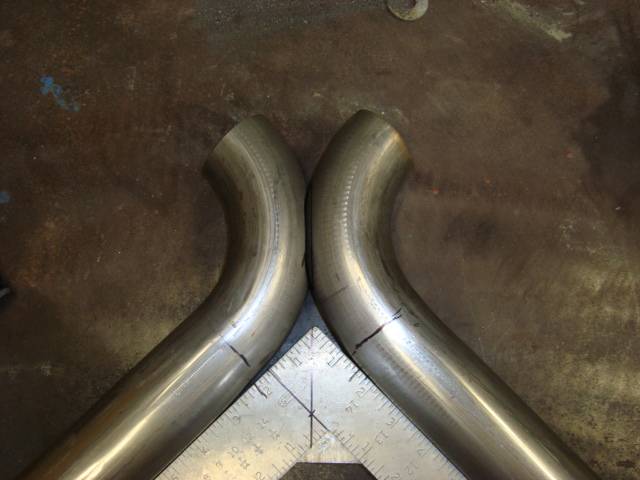

Then used the first cut to eyeball the second pipe.
Second cut, then comes the fine tuning with a sander and file to get the pipes to line up with minimal gaps while maintaining the 90` inlet pipe angle.

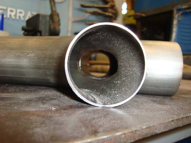

Hole size should be 1/2-2/3 of pipe diameter. This is the old rule of thumb from when Dr. Gas first did this for the NASCAR engines back in '02 or so. The diameter of the hole and inlet angle changes the RPM band and how hard it'll pull at that band. I should see a substantial torque increase around 3200rpm...

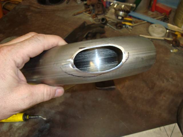

See? Once welded I can use a round file to finish cleaning up any burs.

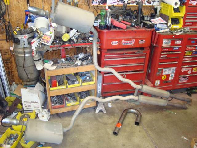

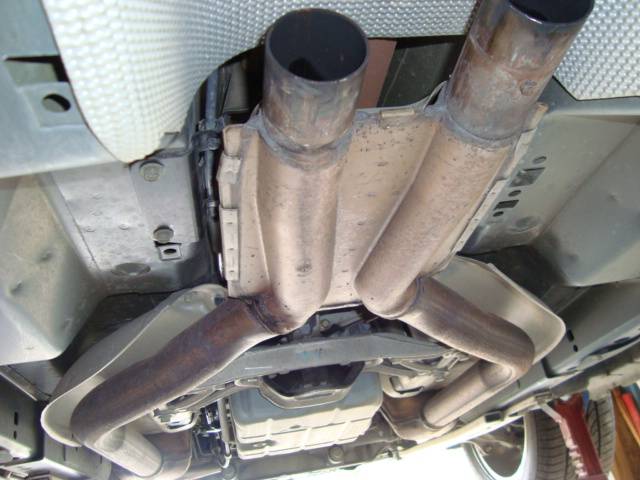

After the X the pipe jumps up to 2.5" out to the tail pipes. I did hang a J bend and the mufflers off the cat pipe and ran it through to 70mph on the stands and it doesn't sound horribly loud in the garage so maybe this will work out.

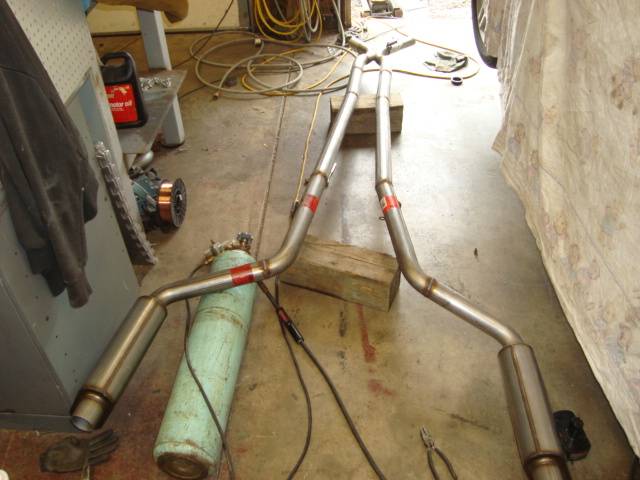

I killed the camera battery so no pics yet. I've gotten the drivers side tacked in, working on the passenger side now. Everything is fitting pretty well and is nicely tucked up out of the way. I'm going to use 3" dairy pipe (304 SS) for tips.

Ok, quick update. The car sounds great, nice subdued mellow burble. I didn't notice much increase or loss in performance so I'll see what the MPG meter shows after a couple days.
Not a really good shot but I was tired after crawling around the last two days. I got the but joint band clamps this morning and am pretty impressed with them. The pipe is upside down here as I was finish welding all the joints. I only used one 10' stick of pipe and most of four 2.5" J bends and the one 2.25" J bend for the 'X' pipe.
Ended up reusing the stock tips. I'm not totally happy with how they positioned themselve so I'll let the exhaust settle for a week and tweak things as needed.

Ok, took the buggy to work and back today, mileage seems the same, exhaust tone is nice but I have a sneaking suspicion I'm down on torque a bit. I figure I'll ride it out a week or so, then swap the stock exhaust back in for comparison. If I notice the stock stuff performs better I'll resize the pipes down to 2.25" all the way to the muffler.
The car does have the slightest drone right at 1500rpm.

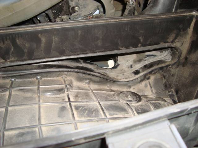

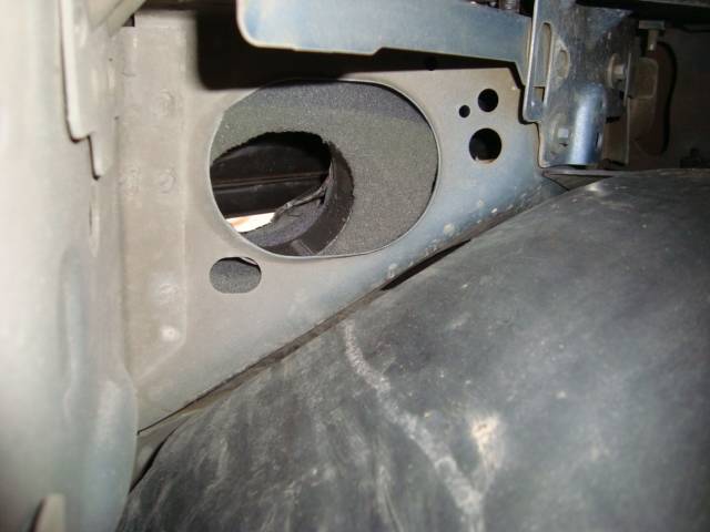

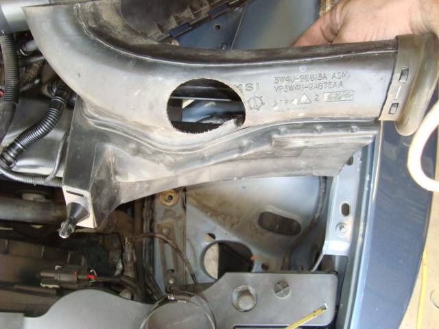

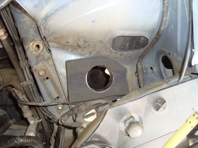

Ok, home built cold air time. I wanted 1.5x the TB area for the air cleaner inlet. The OEM filter inlet is about 1x so I took advantage of the existing inner fender well hole below the inlet and used a 2.5" hole saw to make another inlet to the filter.
Then as a cheap and easy 'seal' I used some spare window AC insulation foam, drilled a 2.5" hole through it and used some of the extra 16ga 2.5" stainless exhaust pipe as an 'aligner / hole size maintainer' and set it on the inner fender.
Results from the top...
From the bottom. I tweaked the foam once the filter housing was bolted down.

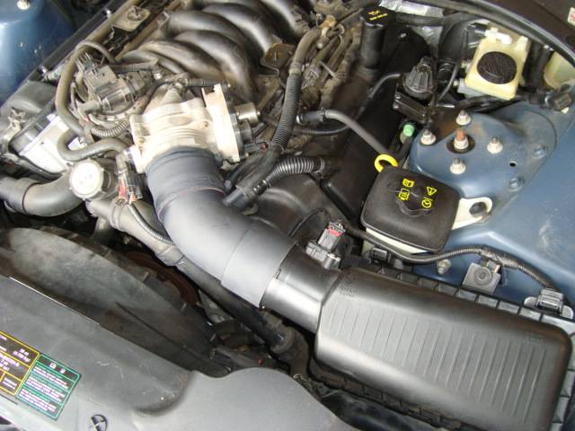

Here's the rest. the MAF adapter is the 3" PVC plumbing coupling that I turned on my lathe. The next peice is the old chrome 3.5" cold air kit elbow. I lopped some of the bend off as needed, then fitted and welded the two fittings on. The valve cover fitting is 1" stainless that I turned so the tube would fit and seal itself. I painted everything with some tan textured plastic paint and finally flat black (which is going to get redone with semigloss)

The bits and pieces were all deburred and radiused before assy. The MAF coupling is a tight slip fit on both the MAF and the painted tube.
I did get a chance to run it and the only new noise is I can now hear the valve train at WOT. No real woosh or sucking sound at all.

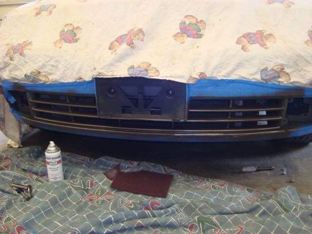

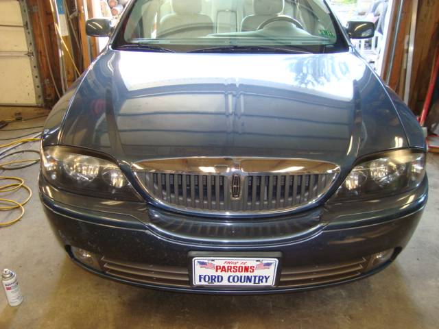

Spent an hour this afternoon doing something with the lower grill...
The something ended up being tape it, scuff it with a scotchbright pad, wiped down with alcohol and spray it with some Rustoleum dark bronze metallic. I chose the bronze because my stock grill has some bronze in it vs. straight gray or sun bleached black and I think it's more 'luxurious' vs. flat black or dark gray.
It did turn out a little 'warmer' than the grill so I'll pull the grill tomorrow and give it the same treatment. I'm pretty happy with the color and think it compliments the dark blue. I don't think it would look 'right' on a lighter colored car.
