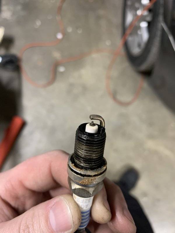

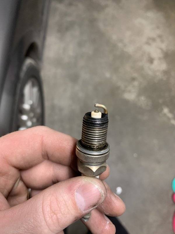

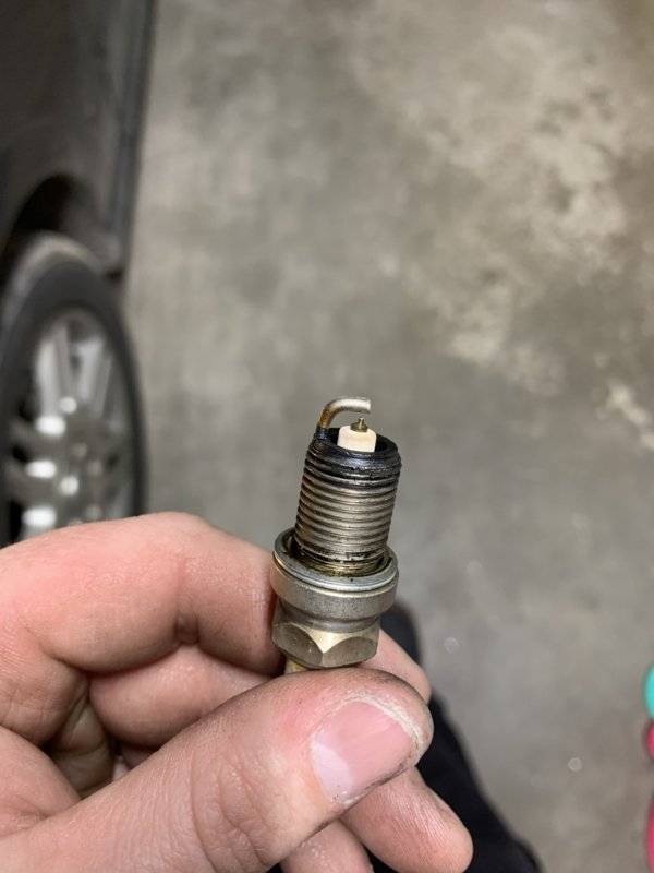

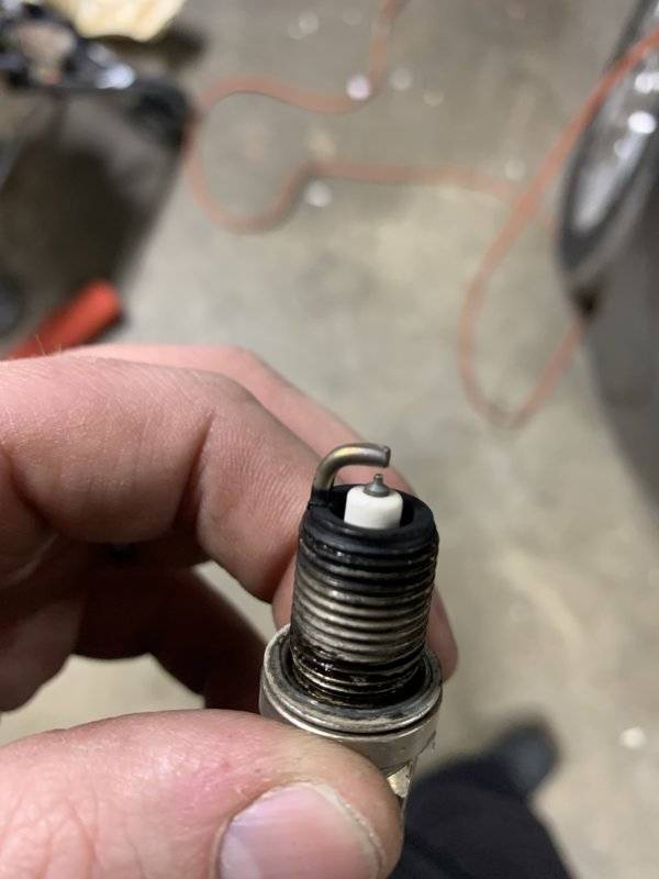

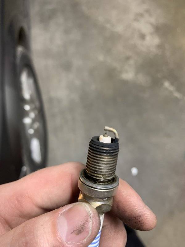

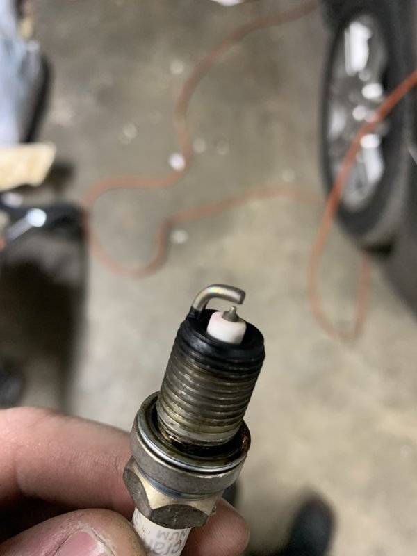

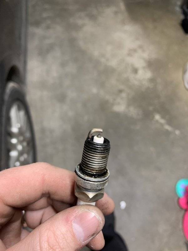

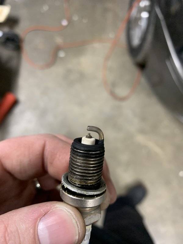

But every time I’d put a cold coil in it would run good for a bit. Sunday I’ll go ahead and pull the plug and share a pic.
In order 1 through 8
Interesting...I've definitely seen worse ...they look pretty good...nothing out of the ordinary here...I would think a smoke machine is your best option to be sure it's not leaking air somewhere...you said you changed your fuel filter right?

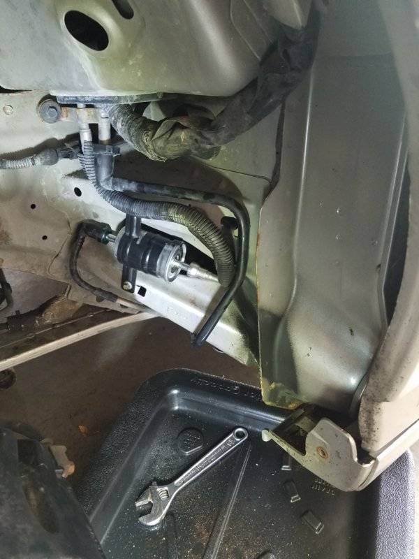

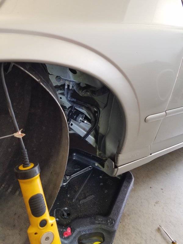

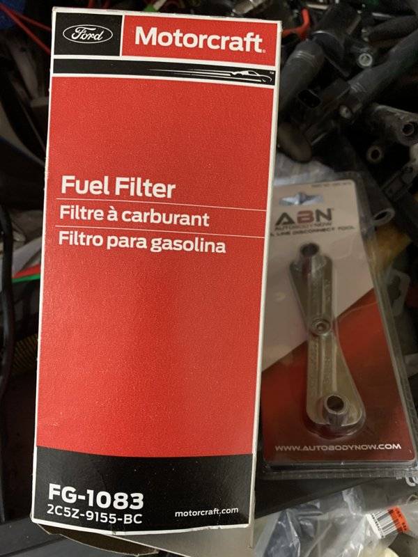

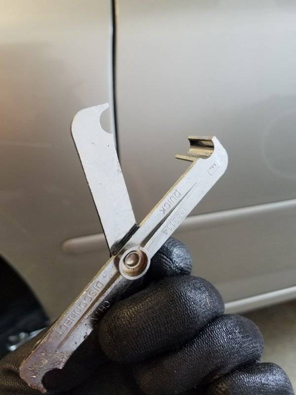

Under splash guard front driver/left side ...you need the special tool to disconnect..it more than likely is rusted so be patient with the tool
Need to crank with fuel pump fuse out to depressurize?
You can, but I always just throw a rag over the connection before opening it. Not much gasoline comes out. The rag soaks up most of it, but more importantly, keeps any of it from spraying in your eyes.

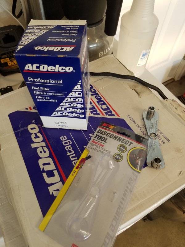

Got the fuel filter and tool today. Rockauto just received my return on the NGK coils so I’ll order the motorcraft ones when I get a credit.

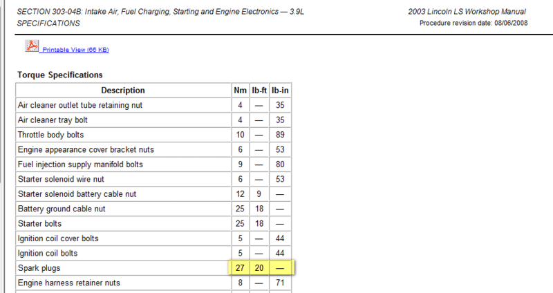

Just want to add there is a recommended torque on the plugs when seating them...Call me crazy but I truly believe this is really crucial to the longevity of our plugs life on the 3.9
