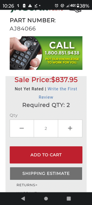

I don't believe there is an aftermarket for the cam phasers. Just the high dollar Jag ones.

Part number for the phaser is 2w9z-6256-AA. No longer available through Ford.
Price... $175
Dealer told me it was obsolete... but that a place called Vintage Parts has a couple in stock. They buy discontinued New Old Stock parts for resale.
I didn't get any contact info for Vintage Parts. But my dealer gave you the option to purchase through them.
