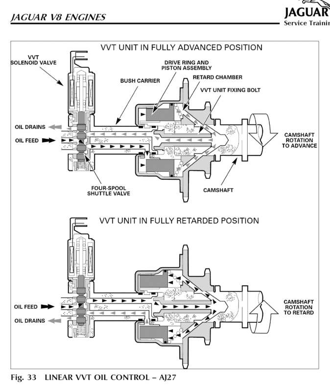

This is a diagram from the Jag service manual. You can see that if the VVT solenoid valve potentially gets stuck in the "fully advanced position" that could cause the P0021 code over advanced code.

I got the solenoid out with just taking the valve cover off on the drivers side. When I examined it, the shuttle valve was stuck and I couldn't move it up or down very easily. After gently pushing on it, it seemed to work it's way loose again. Not sure if there was something lodged in there or the spring is loosing its springyness or what but it moves easier now.
I do have a new one that should be coming tomorrow. Hopefully that is the issue. Looking at this picture, having the shuttle valve stuck in the down position would cause an advanced situation.
