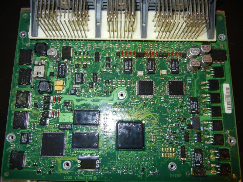

I'm teetering on just getting this thing rebuilt, my car has been sitting since the end of August collecting dust. I called the place Gus recommended in another thread and they are willing to rebuild my pcm for $175 and give me a 1 year warranty. It's not the avenue I want to take but if I ever want to see this car running again it looks like my only option.
My car is in the same position as yours - I think the transmission issues are PCM related. I just wonder what they would "rebuild" inside of the PCM. All of the components are coated in silicone. DSCN1078.jpg
That's conformal coating. It adds to the difficulty, but it melts away. It's still very possible to unsolder and resolder components.
I just wonder how they would be able to test and determine which components failed. Obviously I don't know much about the process. It seems strange to me that there are all of these PCMs with only transmission related problems.
