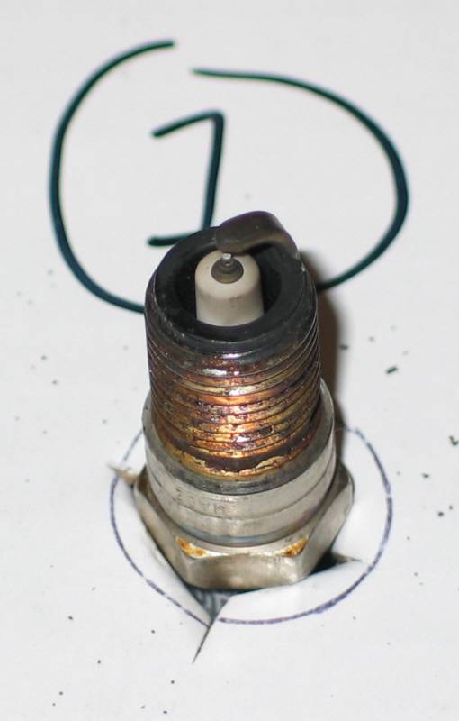

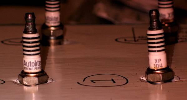

Here are 2 photos of the Autolite HP 104 iridium plugs after 2 weeks use.
Looks like oil is getting past your spark plug cover seals, the valve covers need to come off to change them though. This maybe causing your issues. If not willing to change yet, I would use cheap Autolite 764 coppers and check/change them often.

As to the other (one of many) subjects in this thread, those plugs look like they are running rich imho. You probably have lots of fresh carbon on the exhaust tips too would be my guess.

You are correct, So whats up with his car? The plugs look like they have been running rich to me.
