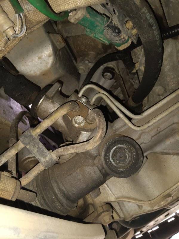

Replacing my pump and pressure lines and, of course, I didn’t take any pictures and the manual isn’t very helpful. I can’t remember which pressure line goes where on the rack and pinion - there are two right by the steering column.
One is the long pressure hose that comes from power steering pump and the other goes to the cooler.
Does the long hose from the pump go on the top port of the rack and the hose that goes to the cooler connect to the bottom port?

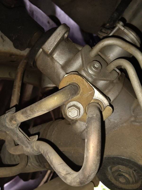

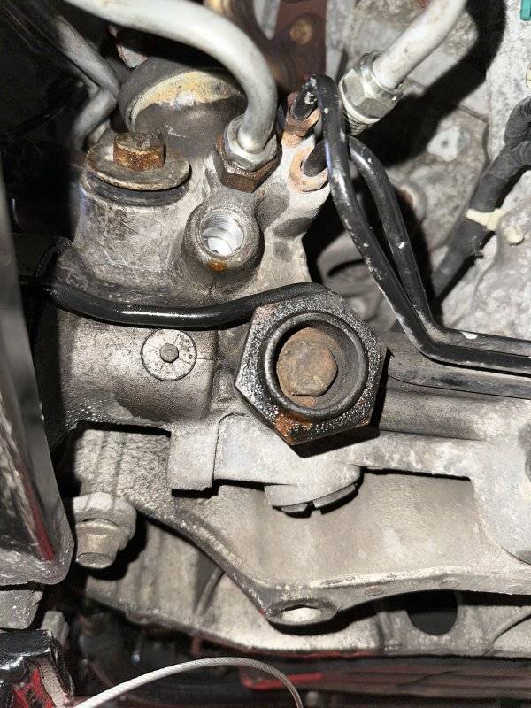

@Broseph here is a couple of pics. I had to jack the car up but i got you a couple of pics. The best i can tell the hose coming from the front went into the bottom and the hose thats in the back went to the top.
