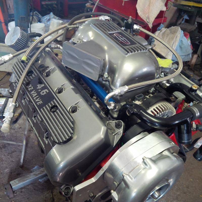

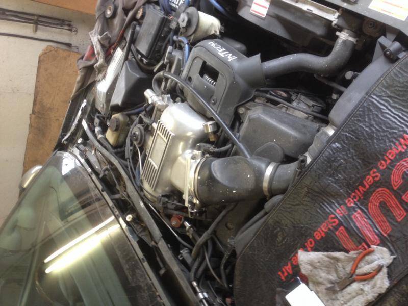

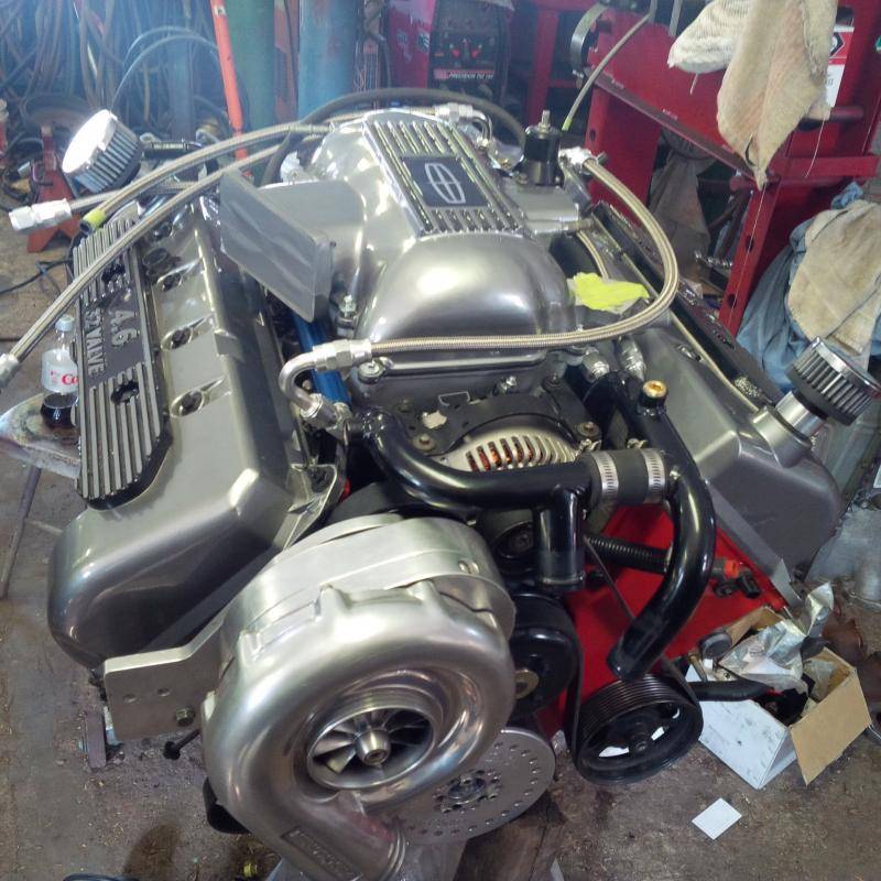

A few pics, she's in pieces.
Full rear end upgrade... Again. Upgraded eaton posi, 31 spline with pro level shafts 33 spline outers all new bearings; pumpkin and hubs.

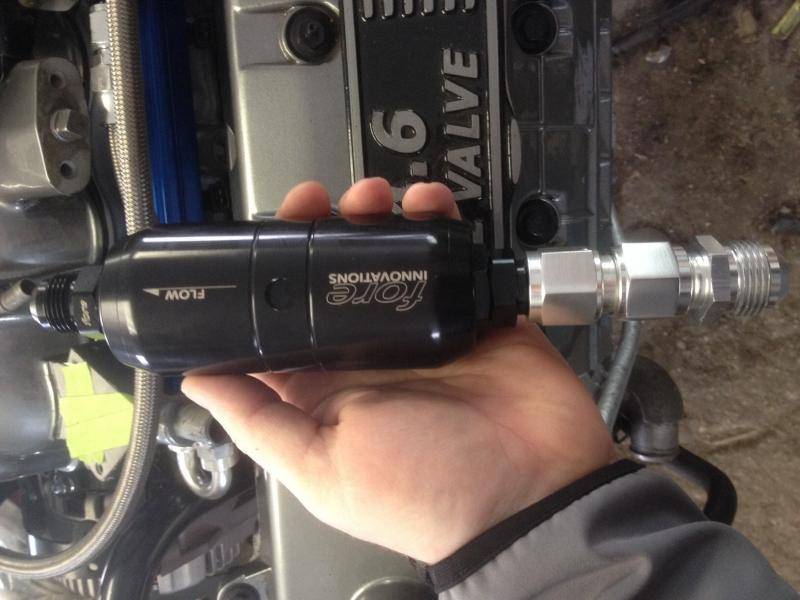

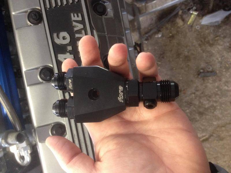

Fuel parts, no my hands aren't small... Lol 12 and 10an feed with 8an return.

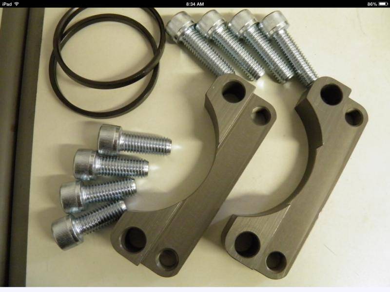

Intercooler piping, caliper relocation brackets for the rear, and rear end mount as well.

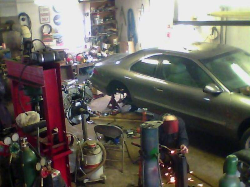

Pops doing a little bit of welding.
Fuel tank is out, getting baffled and twin 465's with a fuel hat mod.
It has begun
Inter cooler piping, caliper relocation brackets for the rear, and rear end mount as well.

Awesome build man. I got my morning reading material. Thanks for all the pictures. I'm on a mission now to install a supercharger also. Your car is completely custom and it is one of a kind.
I want to thank everyone for all the kind words, I've been collecting parts.. One piece at a time for quite a while now.

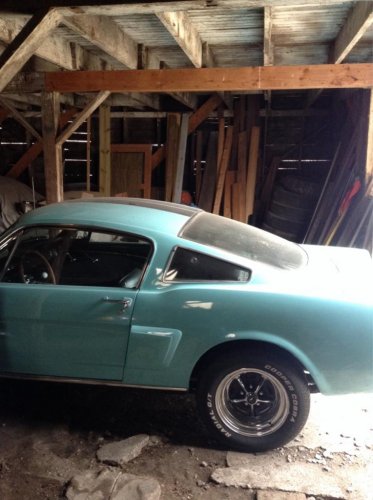

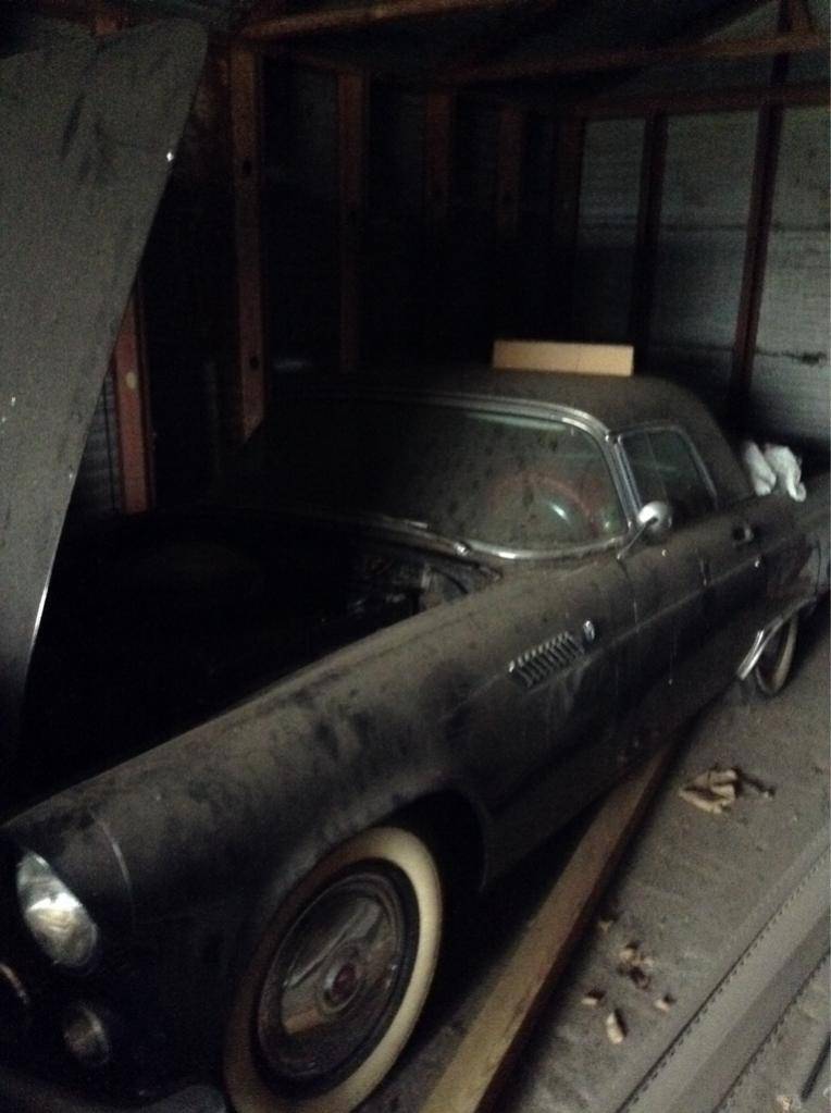

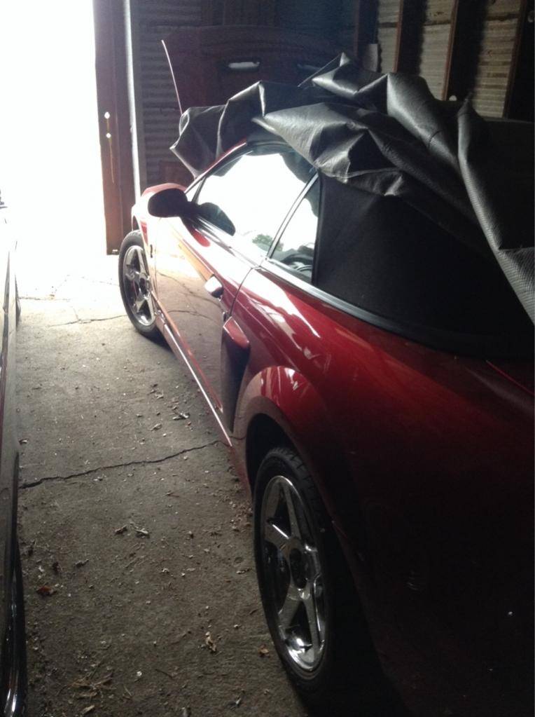

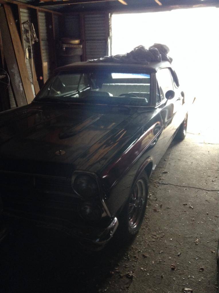

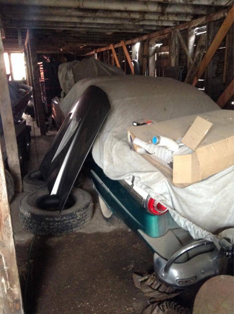

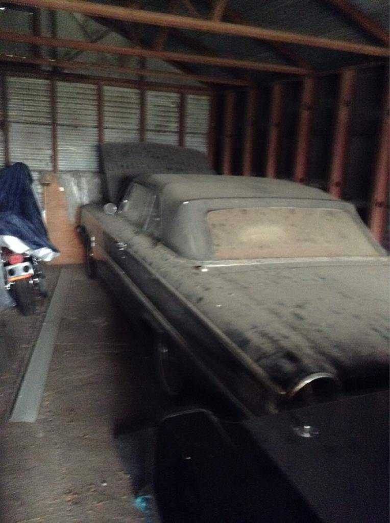

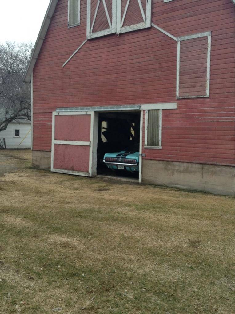

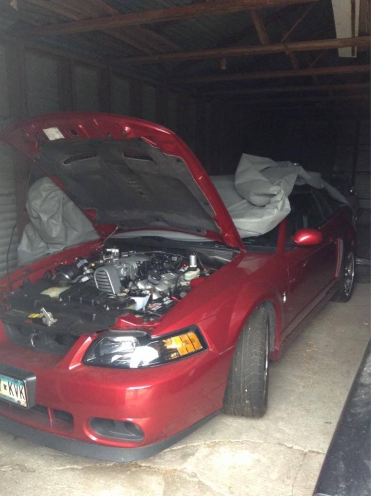

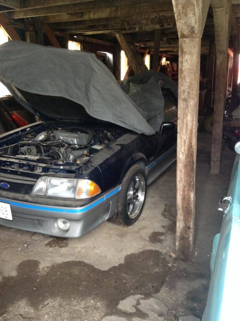

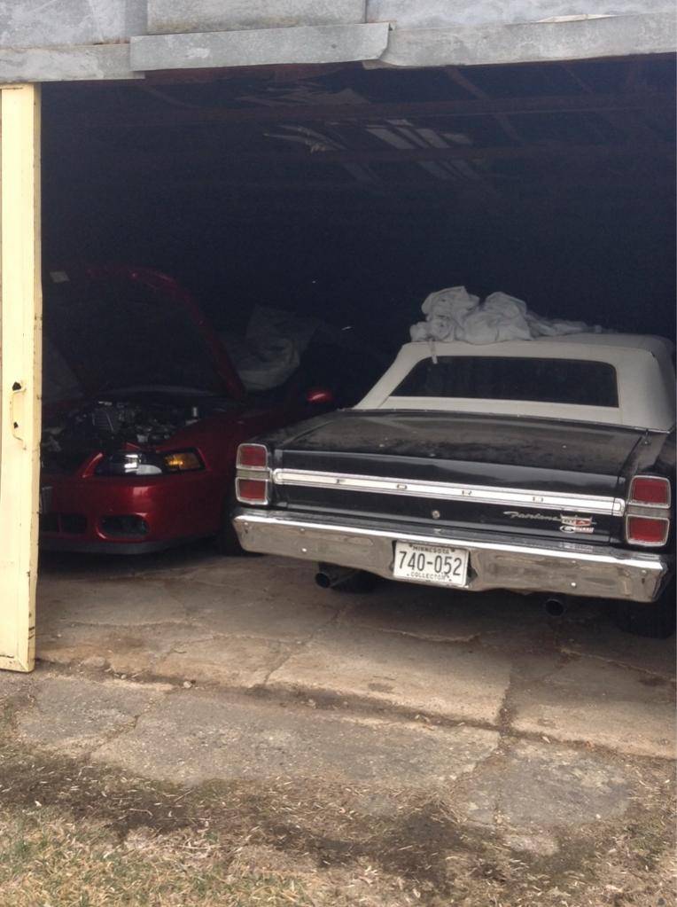

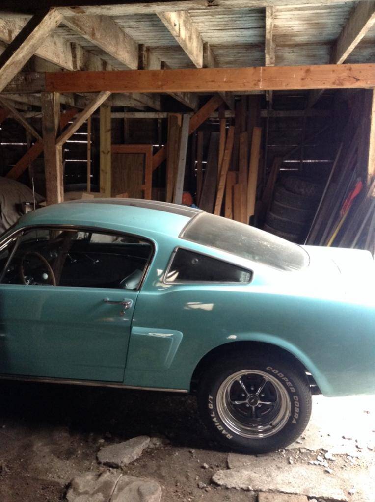

What the ?
Why have you not invited us locals to see such treasures you keep hidden away.
I would love to come take pictures.
I'm sure we could find a car show to go to in Fargo then swing by and give my pops a hard time.
Oh wow, cool collection. There's allot of fun pack in to that barn.
I'm down for a road trip car show, I know some Model T guys up that way we could put stop at.
