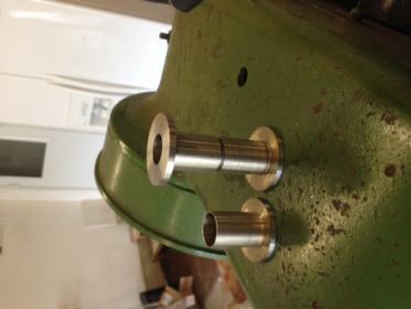

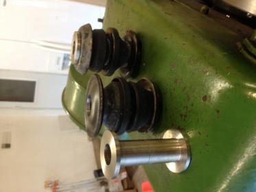

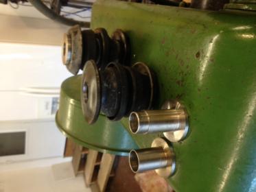

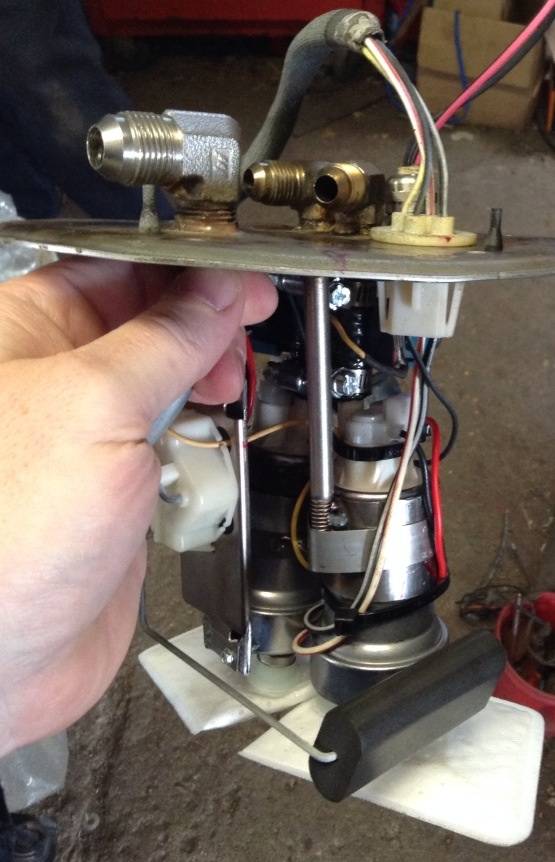

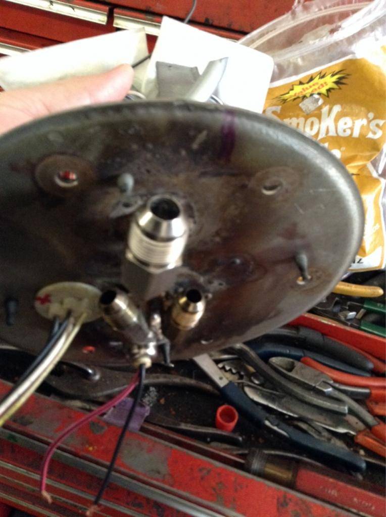

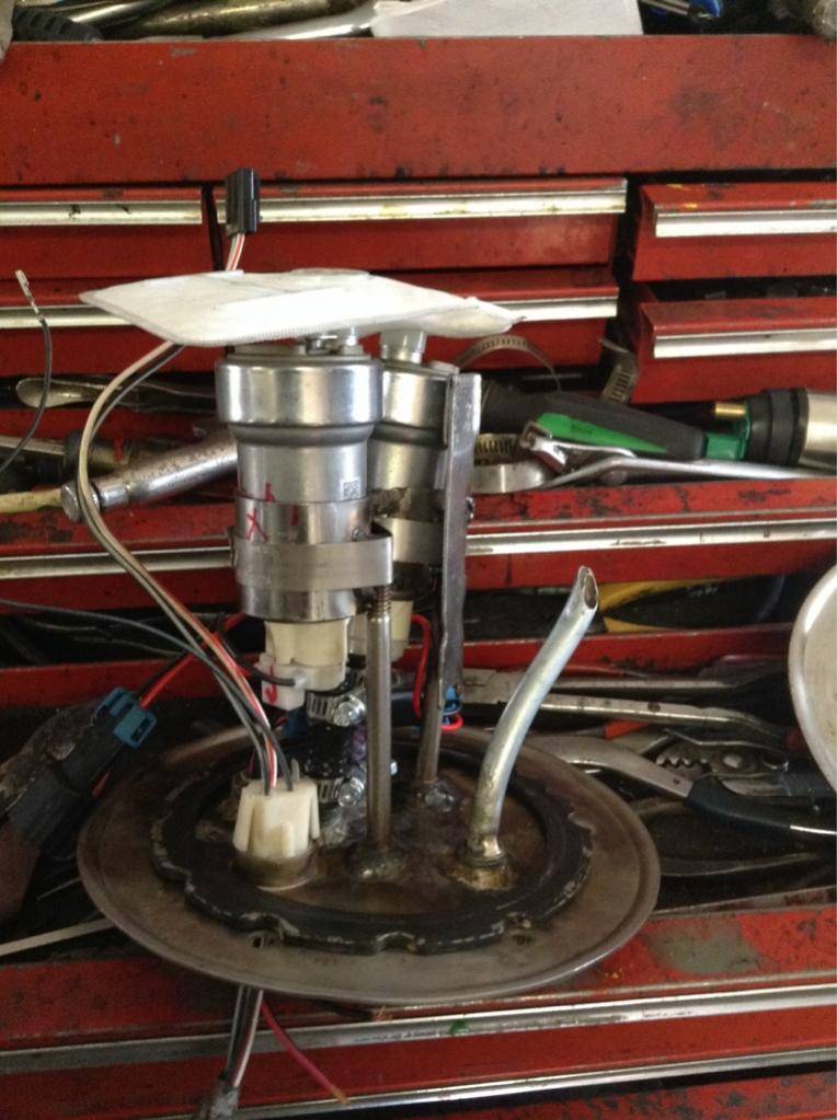

Fuel hat is done, twin 465's mounted and the fuel sending unit. All stainless using the factory hat.
ImageUploadedByTapatalk1397578624.629352.jpgImageUploadedByTapatalk1397578648.416608.jpgImageUploadedByTapatalk1397578661.874387.jpg

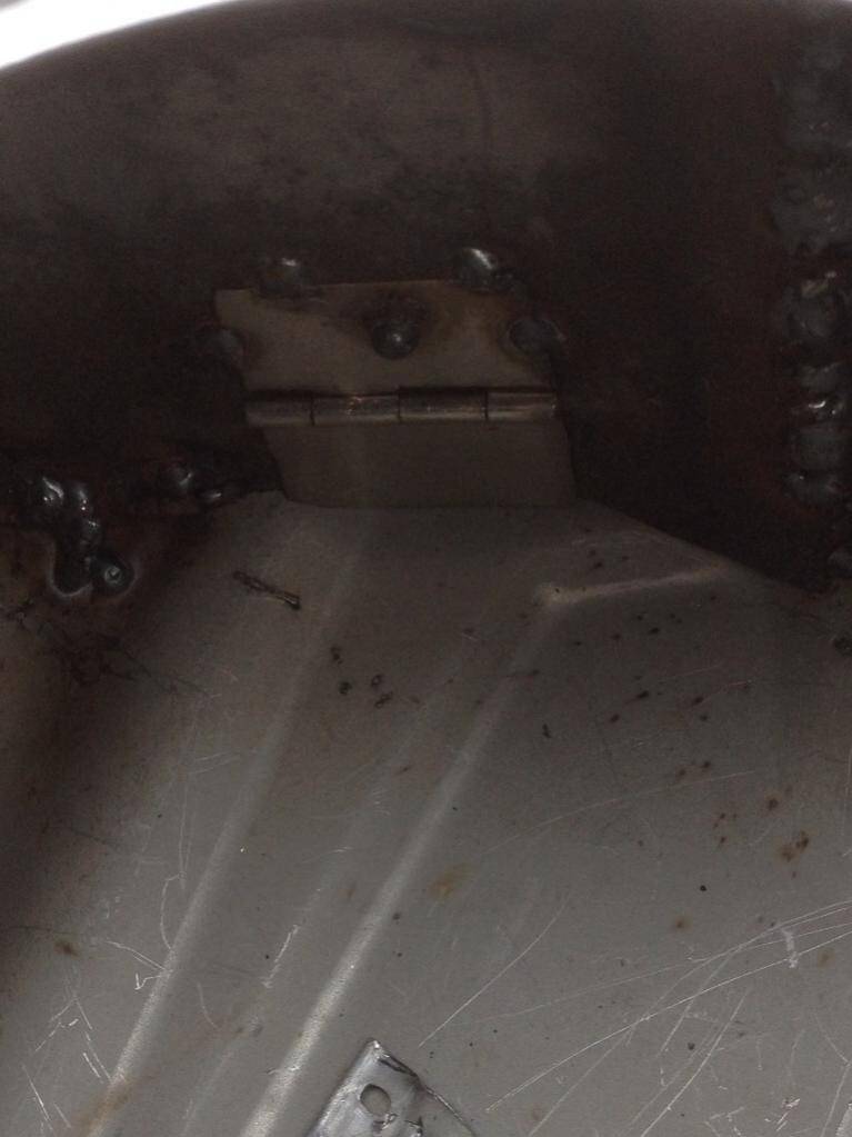

Tank is baffled. 3/4 the height of the tank with stainless trap doors. Original fuel basket was removed for the new fuel pumps.
Hard to get a good picture inside the fuel tank when it's bright out. All back together now and a test fit for the lines. -8an return with twin -6an to single -10an running forward. Fuel filter is a -12an fore stainless, the one pictured in a previous post; about the size of a coke can.
That hat will pump 930lph of corn fuel ;)
No way the tuner is going to tell me I have a fuel problem.
That is a lot of fuel.
You will have to stop at every farm on the way back.
Might have to trailer it back huh?
That's only 460 gallons per hour or so, I'd have to do the math to get the right number.

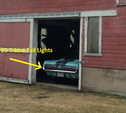

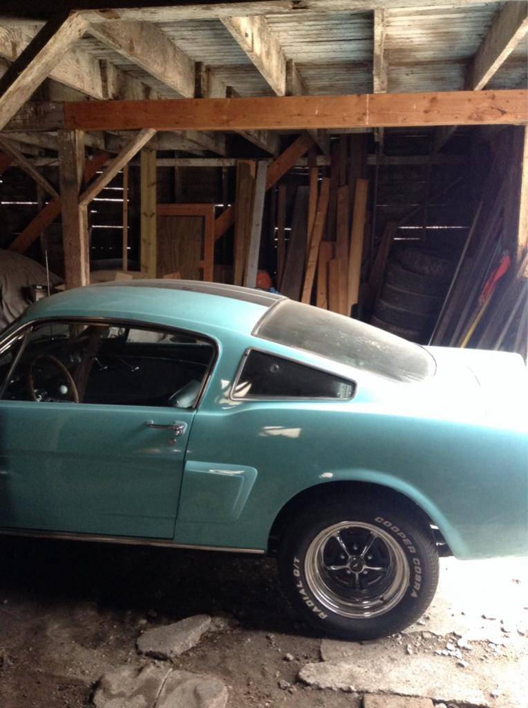

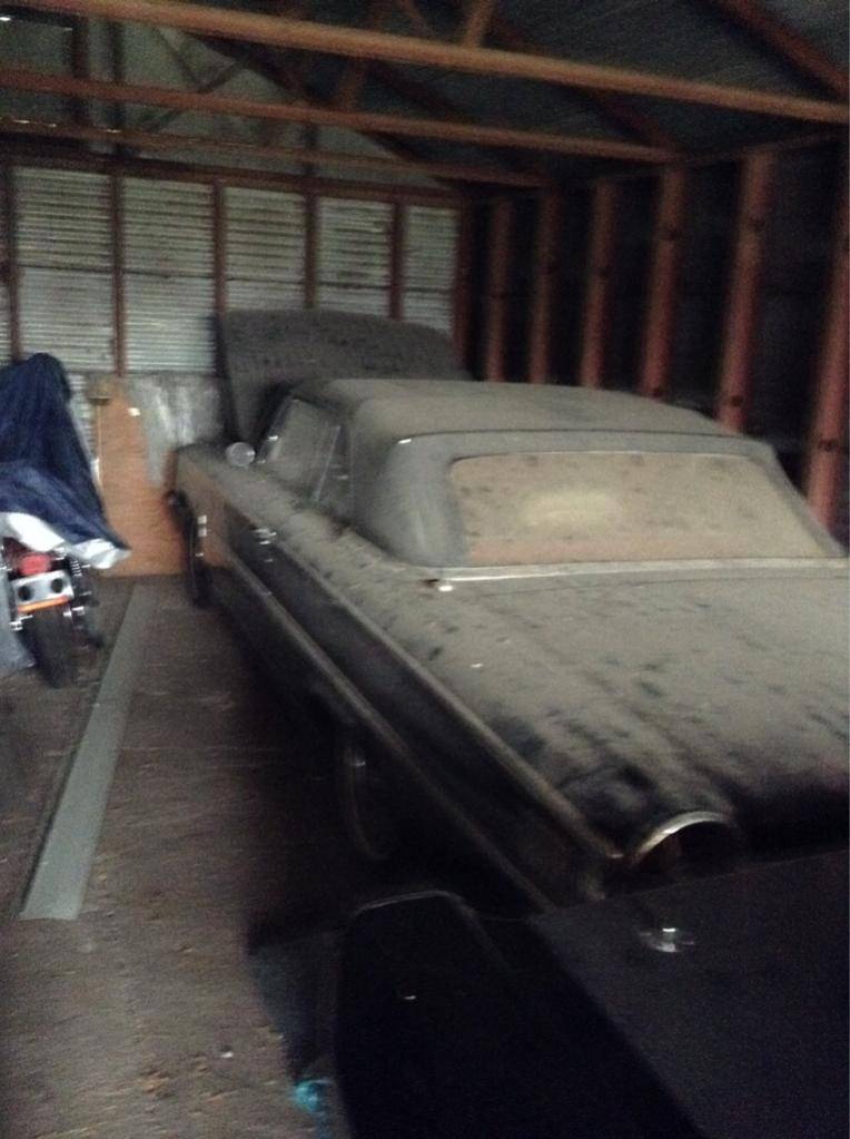

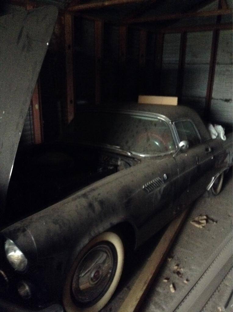

Daaaaannnng! I want the Shelby and the Fairlane. My first car was a '67 Fairlane 500XL hardtop. And I've only seen a handful of '66 Shelbys with the '65 T-Bird sequential tail lights. Wow...just wow... :eek:

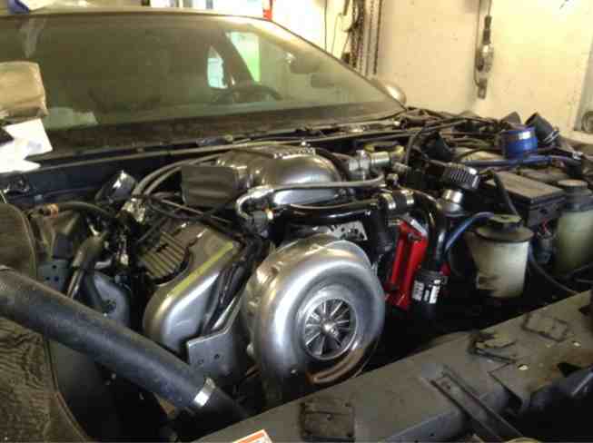

Man that thing looks huge in the engine bay, looks twice the size of the intake. :runaway:

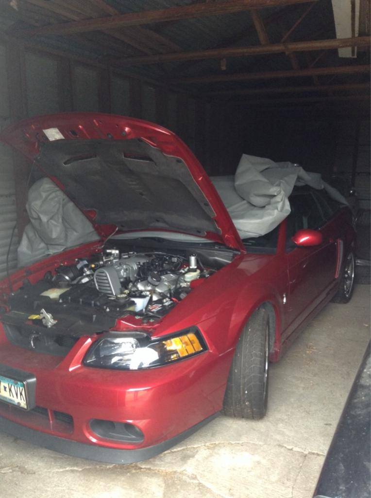

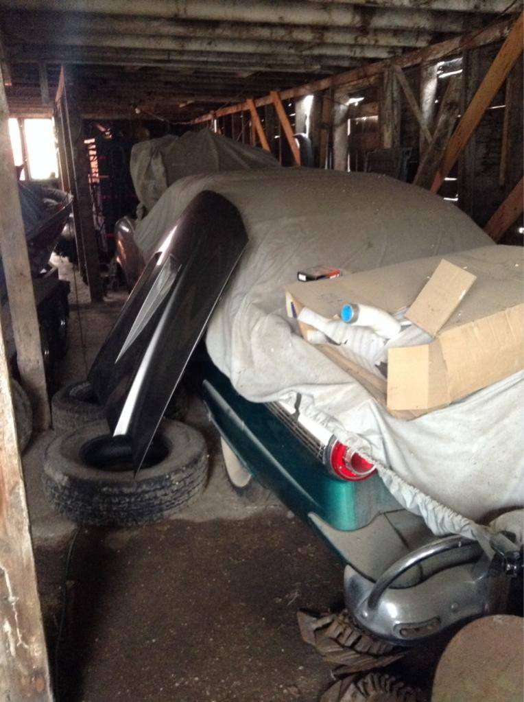

Took a couple of pics while I was up north. ImageUploadedByTapatalk1406951514.096756.jpgImageUploadedByTapatalk1406951528.629655.jpgImageUploadedByTapatalk1406951538.265553.jpg

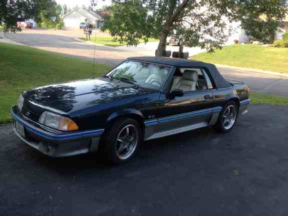

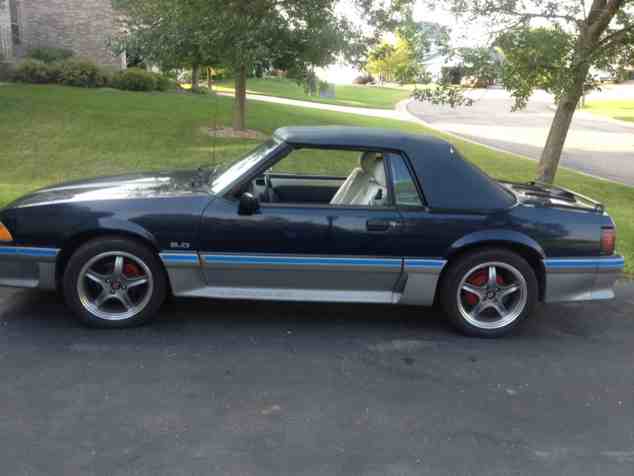

Got the 5.0 out to make sure the tires were still round.. There's just something about the rawness of the fox body stang.
ImageUploadedByTapatalk1406951744.570534.jpgImageUploadedByTapatalk1406951754.602130.jpg
Good going. ;)
What tuning software are you using?
SCT is what I use, no expert by any means. Read the book at least 4 times, then went page by page writing the tune.
It's a learning curve but you can't beat the feeling when you turn the key and she starts right up.
