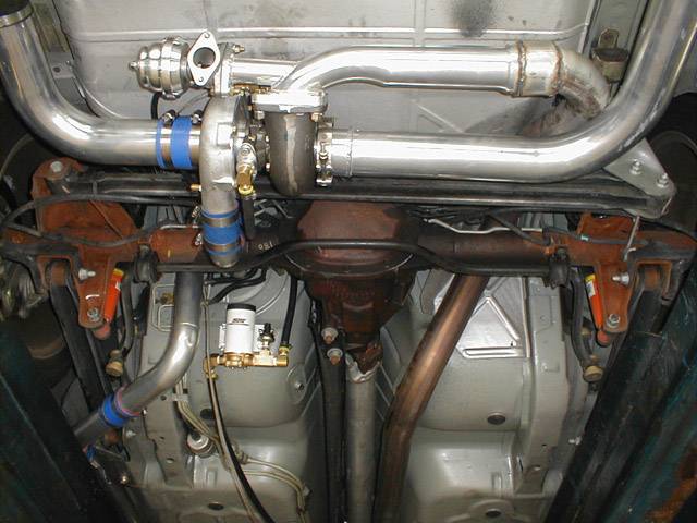

But if its going to be rearmounted with PLENTY of room, why not go to a dual inline. Get a smaller one for the low end and a bigger one to really push the air through!
I recommend against this. I know that compounded boost (turbo to bigger turbo or turbo to bigger twin screw blower) is getting all hyped up right now but it make for needlessly complex piping under an already tight underbody. This will be due to the way the piping will have to be run for the inline turbo's. I suggest that if you want faster spooling times and good streetable power then go with regular twin turbo's. The way the piping will have to be routed under the car with conventional twin's will be much much simpler.

Any progress on this? Seems like a rear mount kit would be easy for a good shop to fab up.
I'm doing all the fab work in my garage. Slow going at present because I've had to start a new business and this takes all my time and money. I now expect to be back at Maxton for the start of the new season.
