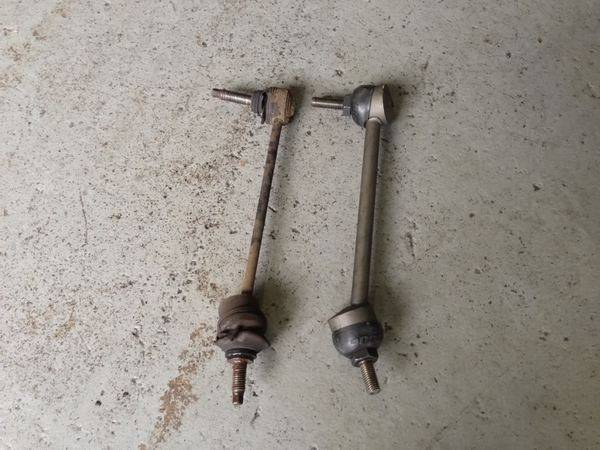

OEM (left) vs. MOOG (right)

Moog's for either front or rear are much "beefier" as 04_ stated.

g1ft, I just noted by your listing, in this case the left sway bar end link is more expensive compared to the right side. Kinda contradicts my other thread statement about right side parts being more expensive. This is in some instances, the right side control arms are more then the lefts. Is what it is.
The OEM end links are skinnier then the Moog's. The Moog's seem more robust and solid. Many of us have used them without issue. Moog is a very reputable brand name in the suspension game. They only provide the greasable units, which means they come with the grease nipple that you'd need to turn in. They easily strip if you crank them in to much so easy on that.

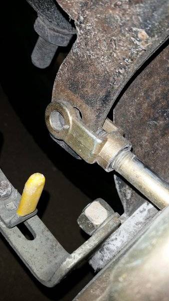

I'm struggling with the inboard nut and bolt on the toe link. I've sprayed with PB Blaster and backed the nut off the bolt to the point where the threads stop and the integrated bolt head starts (at the very tip of the threads). I just can't seem to get the head off.
Any advice?

I think you are saying the through bolt where it connects to the frame on the toe adjust links?
If it's the old one your trying to get off and it begins to turn, you have to hold the inside with large locking pliers and undo the nut. When you put the new link on you have to watch that rubber boot doesn't begin to turn on ya.
No sure what you mean by "where the threads stop and the integrated bolt head starts"
a pic would be handy if possible.
Don't try and split the toe adjust links in the middle. It should come out as one piece. Outer side has the through bolt at the wheel spindle and the inner side mounts into a bracket at the frame side.
When they are tough to get out, you have to clamp them down and use an impact on them, sometime a bit of heat from a torch is needed. The old crap coming out can fight ya a bit at times only because it's old rusted and sometimes seized. Pb blaster helps of course.

Gift is talking about the 8mm hex on the inboard stud of the toe link.
Gift... try running the nut back on part way,,, and take a wire brush to the threads to clean them up. If that doesn't work then you will most likely need a Dremel or die grinder with a cut off wheel. At the very minimum a hacksaw will do it... but you'll need a fine tooth metal cutting blade.

Managed to use the hack saw to get one side off. Probably going to have to do the same on the other side. The wire brush is a good idea.
