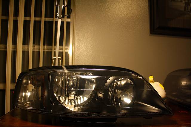

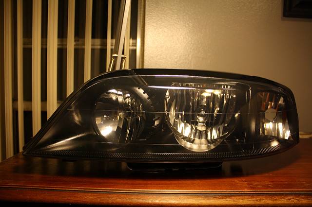

Refinished my lights - PICS!!!

finished this weekend
completed this this weekend.... Thanks Myfirstlincoln for the awesome write-up. Was able to do it in about 2-3 hours.
Followed his write almost completely. I did find that as long as you have something to push the headlight against, a box isn't necessary. i just used a folding table and lined up things behind the light so i could have the lens on the edge of the table... never moved...300, 500 and 1000 grits went fine. make sure you take your time with the 3000 and rubbing compound though. heres some pics. sorry i forgot to take before pics. they were extremely bad though. far worse than lincoln's lights above... oxidized on top and tons of chips and nicks.

G-Rell....your lights look sick - GREAT WORK!
Glad I could contribute something to the site since it seems I always gain information from everyone but don't have much to offer :p
