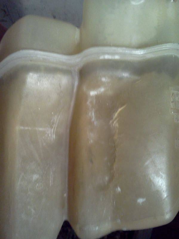

BTW this is what I found when I finally wrestled the bastard out:

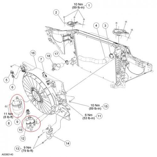

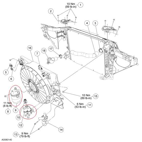

alright here we go - major coolant leak occurred today with some overheating. car is sitting in a parking lot right now. item #9 below appeared soaked and appeared to be the source of the issue. but i'm not sure, i know item #12 below often comes up as an issue. does #9 ever present problems? how do i proceed? i know i know, tell me to replace all plastic components, etc. what are we looking at cost wise vs taking to dealer?
Item 9 is the AC receiver/dryer. It has refrigerant circulating through it. It does not have any coolant at all. Any coolant that you are finding on it is spraying there from somewhere else. If it's wet, then it's most likely the radiator or the upper radiator hose. "Item 12", the DCCV, certainly can leak (it did on my 06 just recently), but it's unlikely to be able to soak the AC part above it.

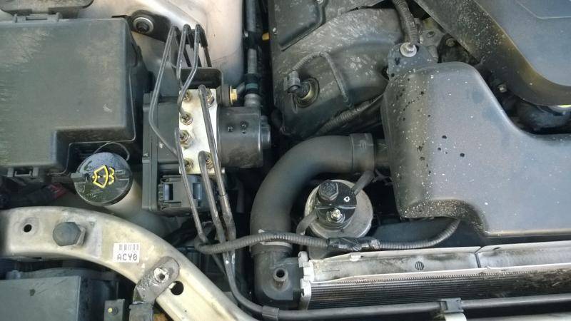

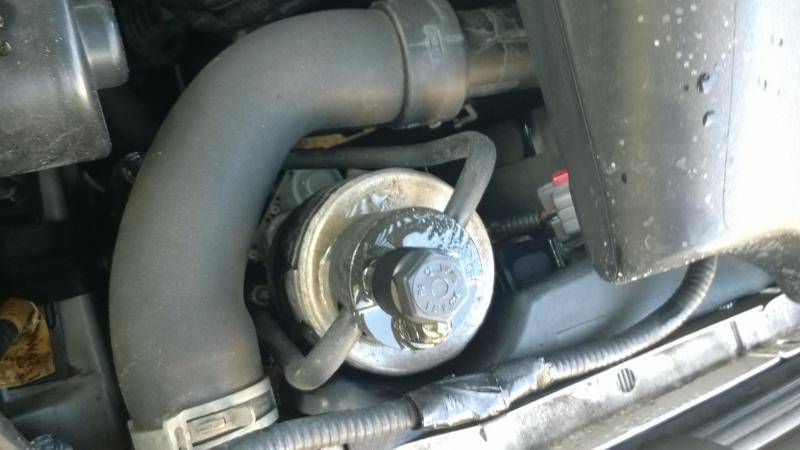

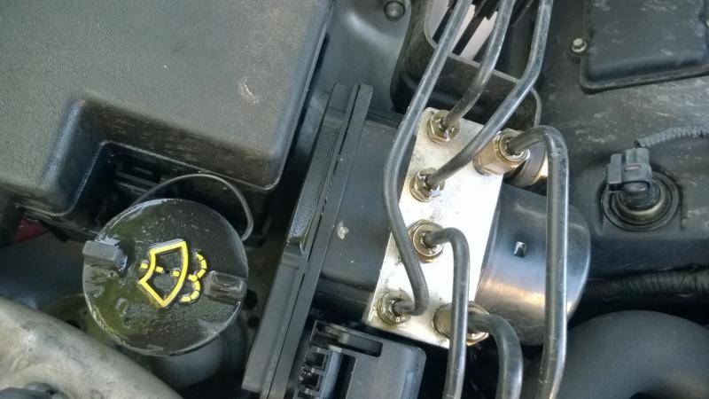

i hear ya joe - thanks for the help. just went down there, took a few pics. coolant tank is very dry, after filling up to try and limp home. leak seems to be hitting the pavement just inside the front passenger wheel, maybe a little forward of that. coolant spewed EVERYWHERE on the left side of the engine bay.
You're going to have to start removing more stuff to find the source of the leak...
Speaking of which, did you just remove the top radiator supports, or have you been driving with those missing?
Anyway, need to start by removing the air intake and the engine cover. If you haven't already replaced all of the plastic cooling system parts...
