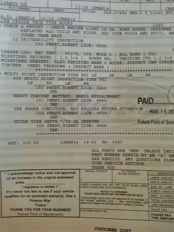

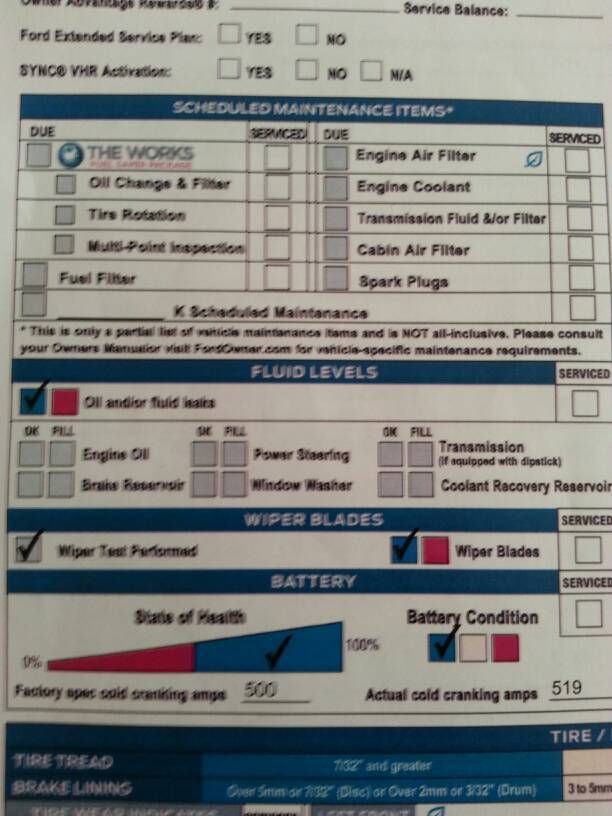

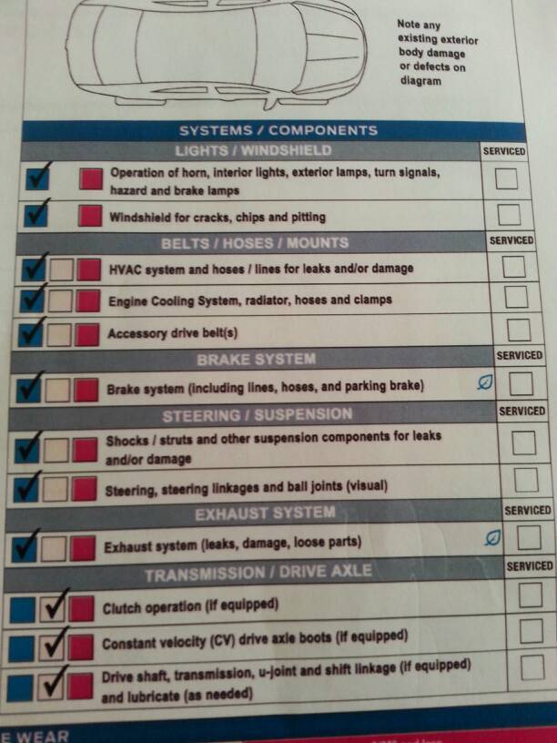

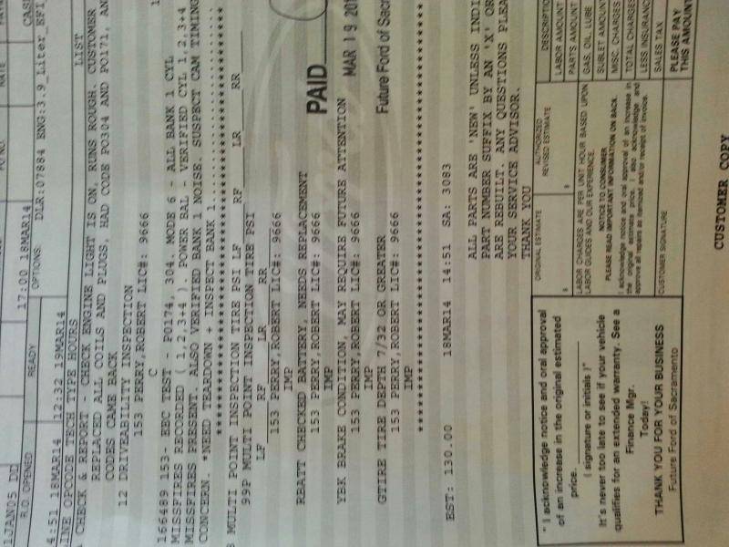

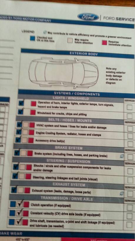

Took it to the dealer... after $130 diagnostic fee... results are in...
I was informed I should
Replace battery.
Replace suspension parts.
Replace tensioners guides and chains.
They want 2900$ .... I can get another LS for that. :/
Suspension and the battery I am fairly sure I can tackle myself... the tensioners and the rest. No way.

might be able to shop around for the recommended work of Replace tensioners guides and chains.... but from the image little rig rotated for ya, it doesnt look like they dug into it to know for sure what the problem is? im not sure where you are getting the replace tensioner guides/chains unless that was a verbal thing...or maybe it was on the estimate (i dont think you posted that picture). either way, i would take their word for it. youre probably not going to get a better opinion than theirs...
lincoln/ford dealer (esp lincoln) is always a sky high estimate (IMO). you can try shopping around to see if you can get a better quote from another dealer or someone you can trust. how many miles on the 2000? maybe return the new coils (if possible) and sell/scrap/partout and just get somethin else.
and to think yall just automatically said 'coils' 'yep uhh huh just gotta be the coils' <eye-roll>
are the new plugs gapped correctly?
i didnt read it so i figured i would ask. sometimes its easy stuff, and sometimes dealers miss stuff.
"It's them coils I tell ya" ... no, There is a timing chain concern, it's noted by the tech as SUSPECT CAM TIMING,
leaving that new coils & plugs are fine, it's firing out of order all of bank 1 and it can't compensate it out that far.
little rig ... funny
cant really tell from the pic if that is the tech's suspicion or the customer's suspicion... if you look just above that it is listing the things the owner told the service rep. due to not seeing the whole pic i cant really tell where customer complaint and tech findings (or maybe 'suspicions' in this case) begin and end..
CHECK & REPORT:
- CHECK ENGINE LIGHT IS ON, RUNS ROUGH, CUSTOMER REPLACED ALL COILS AND PLUGS, HAD CODE P0304 AND P0171 AND CODES CAME BACK
ASSIGNED TO: TECH 153 PERRY, ROBERT LIC# 9666
PERFORMED: EEC TEST - P0174, 304. MODE 6 - ALL BANK 1 CYL MISSFIRES RECORDED (1,2,3,4)
VERIFIED CYL 1,2,3,4 MISSFIRE PRESENT, ALSO VERIFIED BANK 1 NOISE. SUSPECT CAM TIMING CONCERN.
* NEEDS TEARDOWN + INSPECT BANK 1
= Loose stretched chains, worn down cracked tensioners and guides.
:: caused chain to skip one of two notches on one of the cam sprockets. (most likely the exhaust side)
That motor has been ridden hard. (another word is "BEAT ON")
^ thats what I suspect at this point BUT I've been wrong plenty.

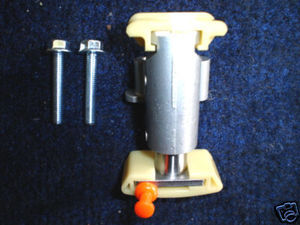

So I am looking into a shop fixing the timing chain issue... and hopefully it resolves my whole dilemma here.. I have done so much already... Seems $1000 is going to be the damage + parts..
Going off the quote from Ford... I have the following from fordpartsgiants ...
Part Number - Description
xw4Z-6020-AA - Timing Cover Gasket Grommet
2w9Z-6020-AA - Timing Cover Gastet Lower
2w9Z-6020-BA - Timing Cover Gastet Upper
2w9Z-6700-AA - Crankshaft Oil Seal
and the timing chain set from rockauto..
https://www.rockauto.com/dbphp/x,ca...756,d,2000_LINCOLN_LS_3.9L_V8_Timing_Set.html
Is there anything else I am missing? Anything I should maybe have replaced since they will have it off anyway?
