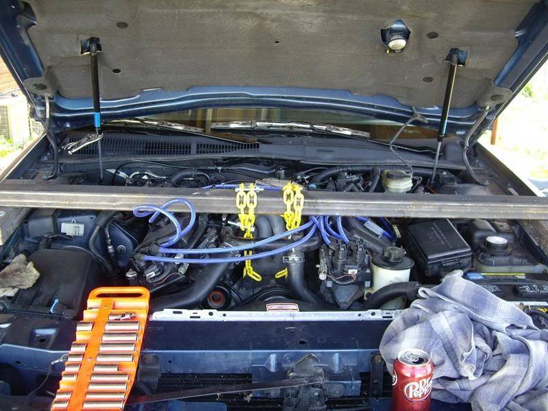

to support the eng remove the alt and put the chain on the 2 lower alt bolts on the front of the block

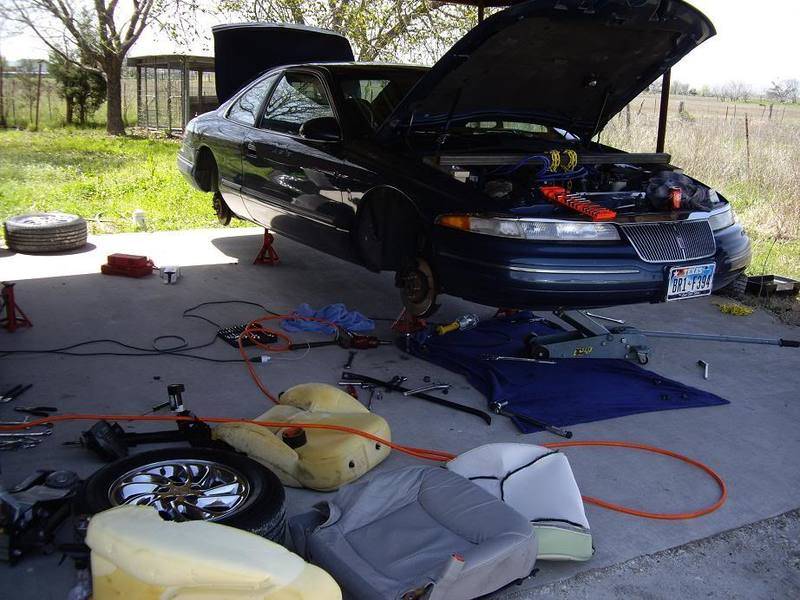

This weekends projects are to swap the K-member, change the oil pan gasket, change the oil cooling jacket gasket, swap the shocks, swap the struts, change power steering hose and do an oil change. Of course things never go as planed on these cars and she decided to throw us a couple curve balls.

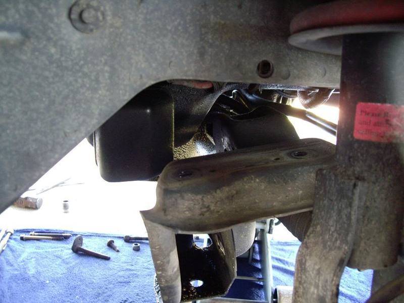

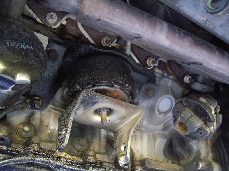

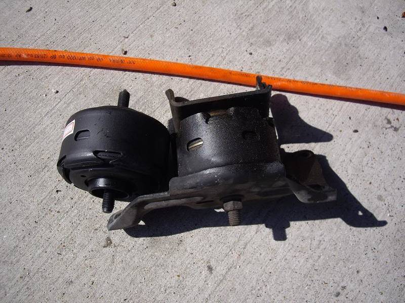

The rear strut rod bushings are shot but fortunatly he thought ahead and bought a set before coming out here to BFE. The can not being happy with no parts store runs decided that it would reward us with a broken engine mount. :( Any of you that have had to replace these before know the joys of trying to locate one anywhere. Fortunatly I located a parts store that had one and it was only 52 miles away. :lol:
So we are no back after the journey of getting it and will resume tomorrow.
Here she is back up in the air and us multitasking by working on both cars at once.
Thanks for the alt idea!

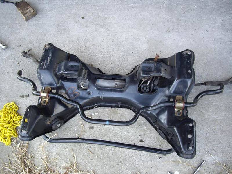

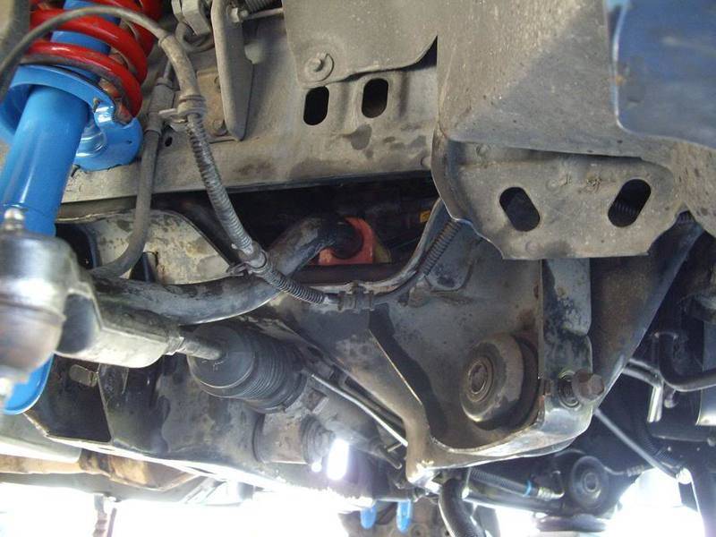

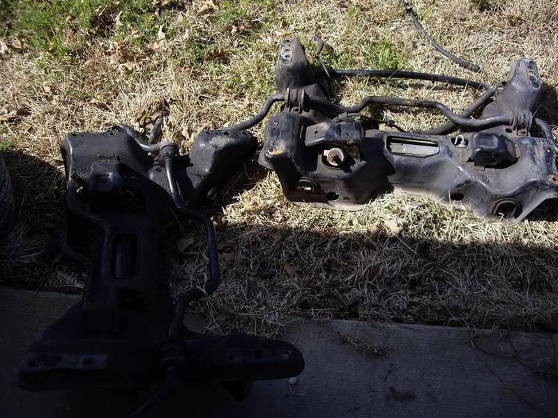

Here you can see just how messed up his cradle was. When I removed the front brace it almost shot off like a spring.

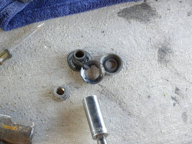

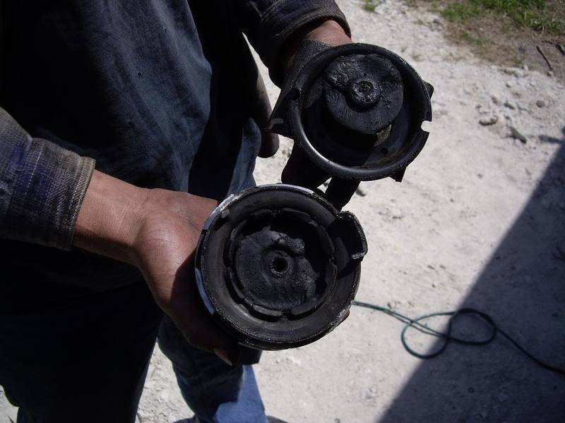

These may be worn out, not sure.

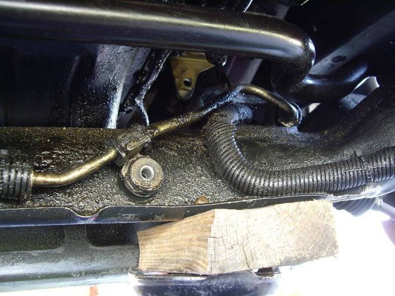

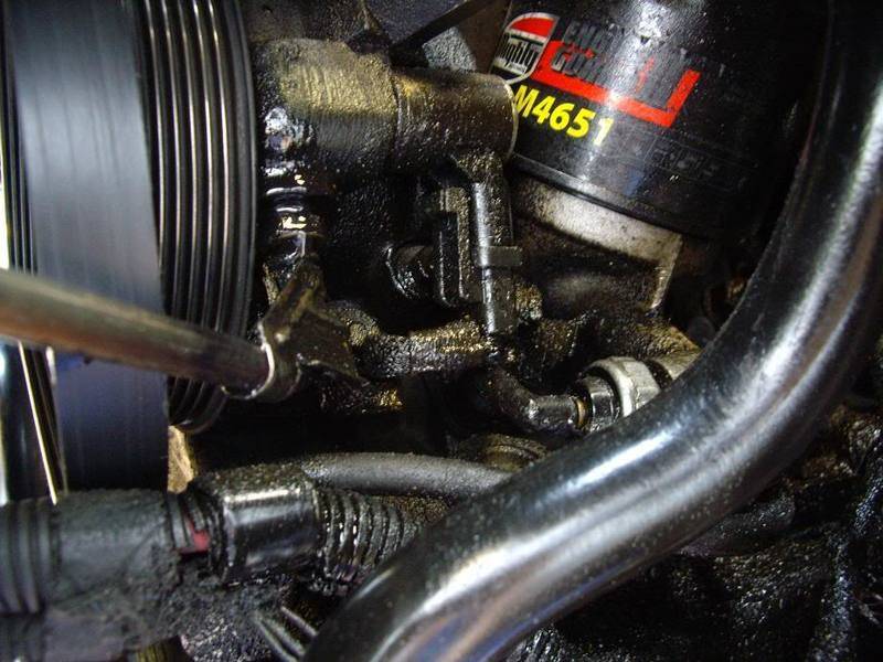

One of the many leaks that will be addressed, the infamous power steering line leak. Im sure 50% of us have had to deal with this leak.
Just a nasty mess but soon to be nice again.

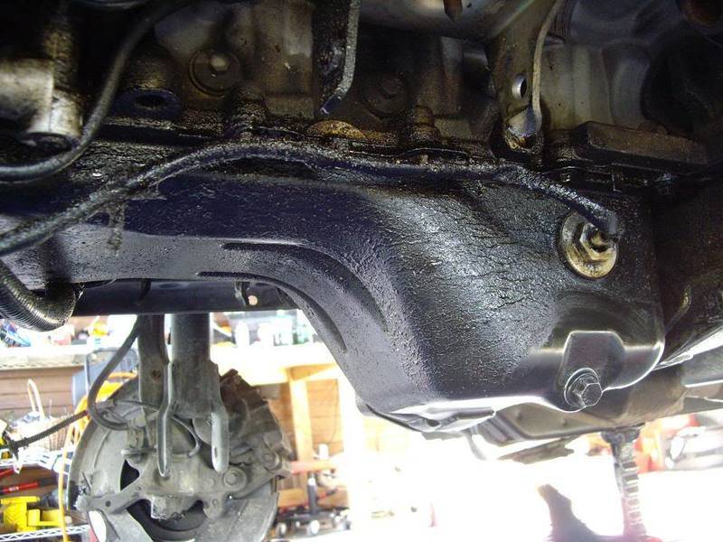

And the oil pan leak:

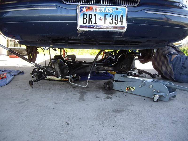

Finnaly lowering the cradle:

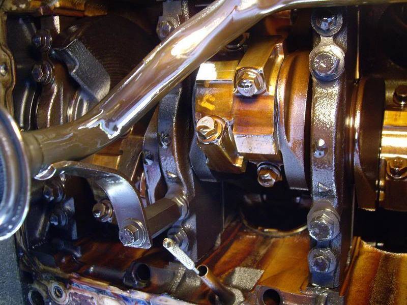

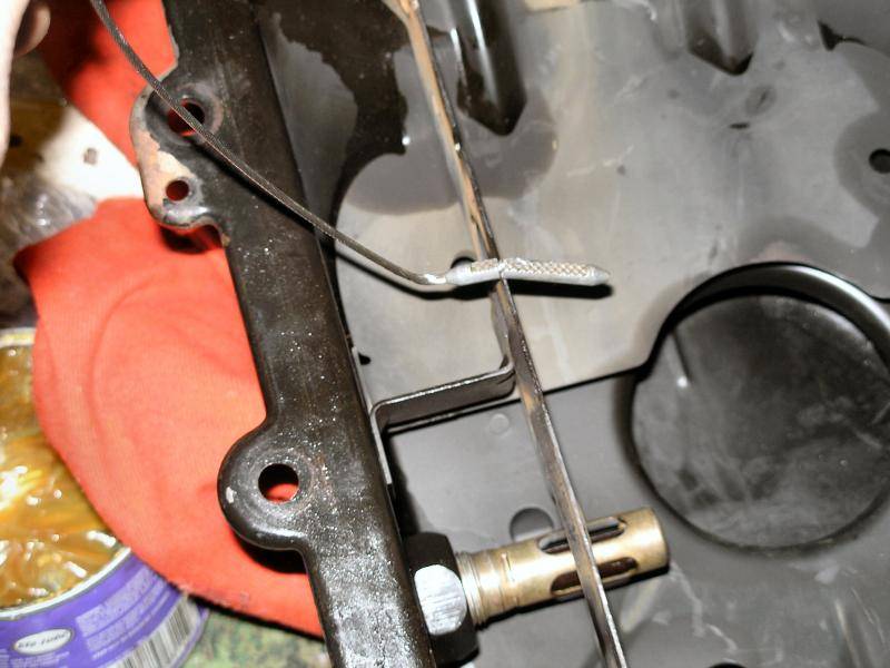

Just a shot of the inside. Oil pickup was clean but engine shows signs of early on poor maintenence. Did a couple back to back oil changes to clean it out and shes getting refilled with Synthetic. Engine runs like a raped ape so I am sure shes fine.
Fuggin failed mount. :mad:
And $100 and 104 miles latter:

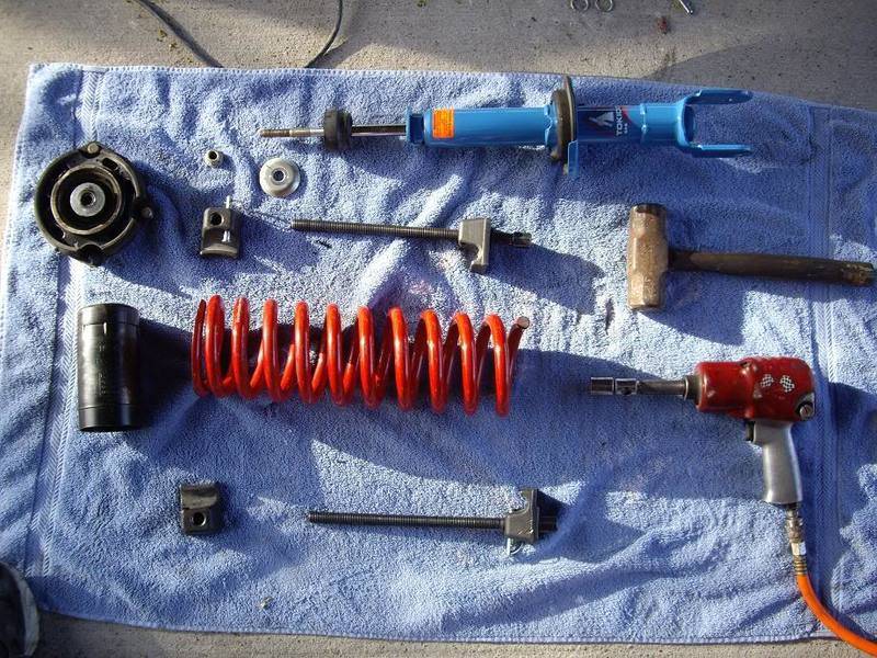

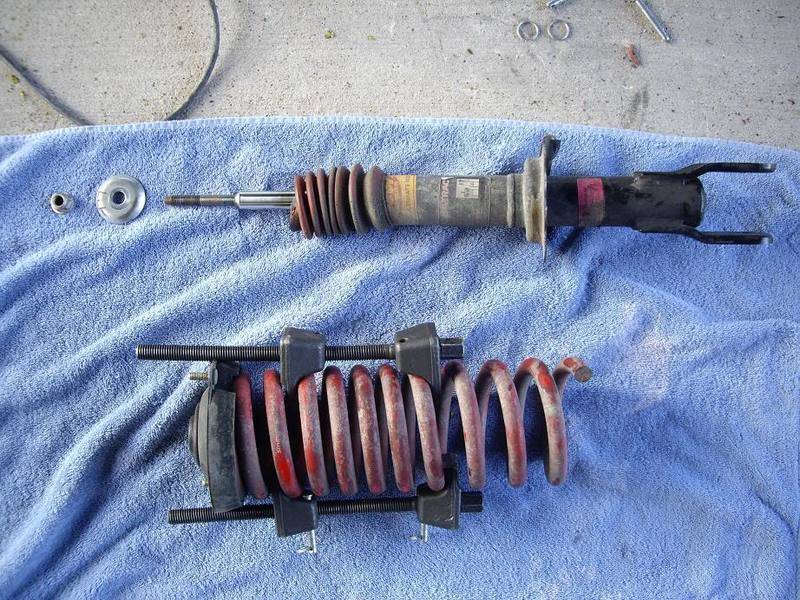

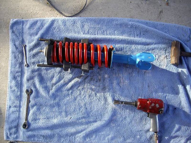

Next up was the struts. PITA getting the dang spring compressor in there.
And all pretty:

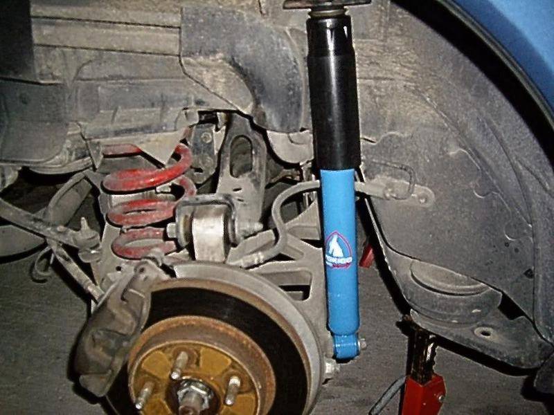

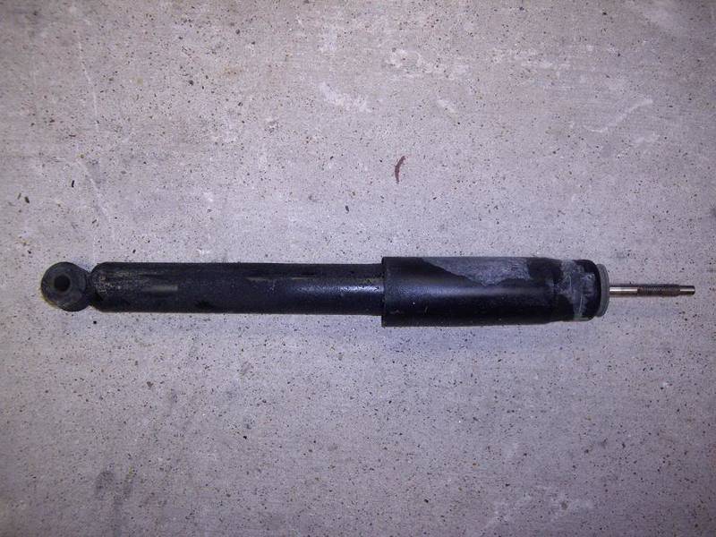

Both rear shocks were completly blown and the rear shock mounts were shot. Also one shocks lower bushing was about gone.

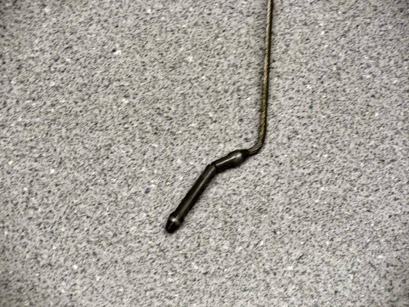

Pull that dipstick out before you put the pan back on! We forgot when we did the one on my 95 and it sounded like a bunch of angry midgets with mallets in there. Turns out the dipstick got tangled up in there on the crank. Was a major PITA getting it out. Just a heads-up just in case.

So back to work today. Just got the oil pan cleaned up and new gasketed and got the motor mount in. I will update as I have time.

So I assume you didnt check the oil level after re-filling it and starting it? :(

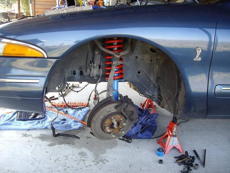

Onward and upward! Quick front strut pic:

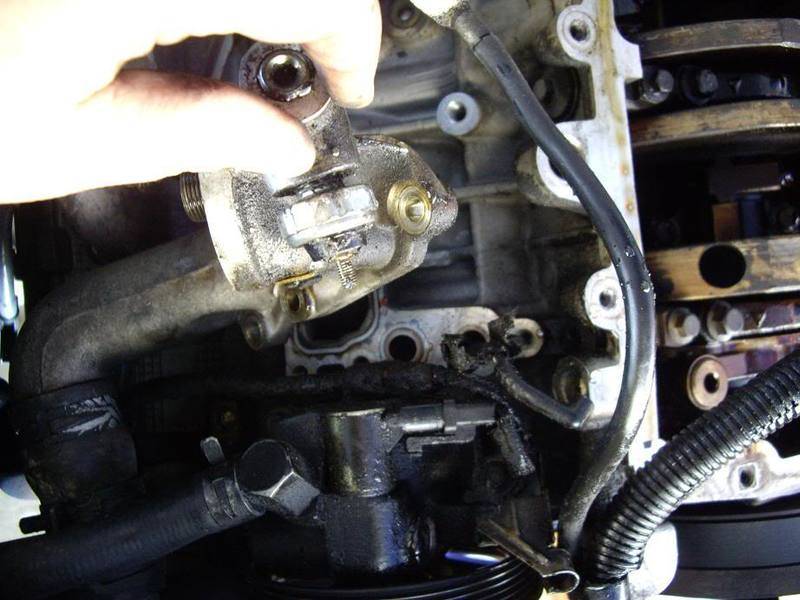

Swapping the cooling jacket gasket:

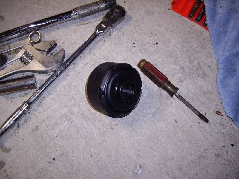

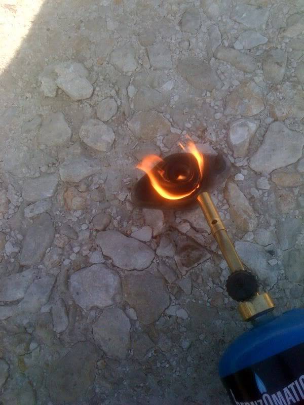

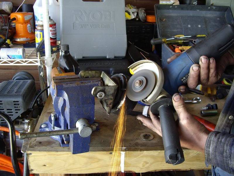

The motor mount from hell! The top nut would not move. I had it in my vice and a half inch drive 18mm socket on it and snapped the shaft on the wrench. :(
Impacts couldnt take it off and I used a propane torch on it too. Gave up and had to cut it off:
Then the other side nut was free spinning cause the motor mount was beyond shot. Had to cut the case apart so I could clamp it in the vice again:

While Sappre was getting the gaskets and hoses in I worked the k-member over. Cleaned it up and then swapped the few month old tie rods on to the new/old rack and pumped out the old fluid out of it. I also gave him a set of poly sway bushings and greasable mounts that I had laying around and we discovered something interesting. May be common knowledge but I didnt know, his 93 front sway bar is 1/16" smaller then my 97 or 98s is. So I guess I did a minor upgrade and put my 97's front bar on it with the new bushings. Should help her out a bit.

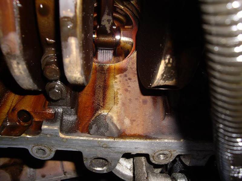

Now this was a cause for concern, he was pissed cause he thought his block was cracked. I went under there and looked and am pretty sure its a casting mark but figured I would check anyway. So is this a crack or just normal? Its by the second crank lobe and on the drivers side.

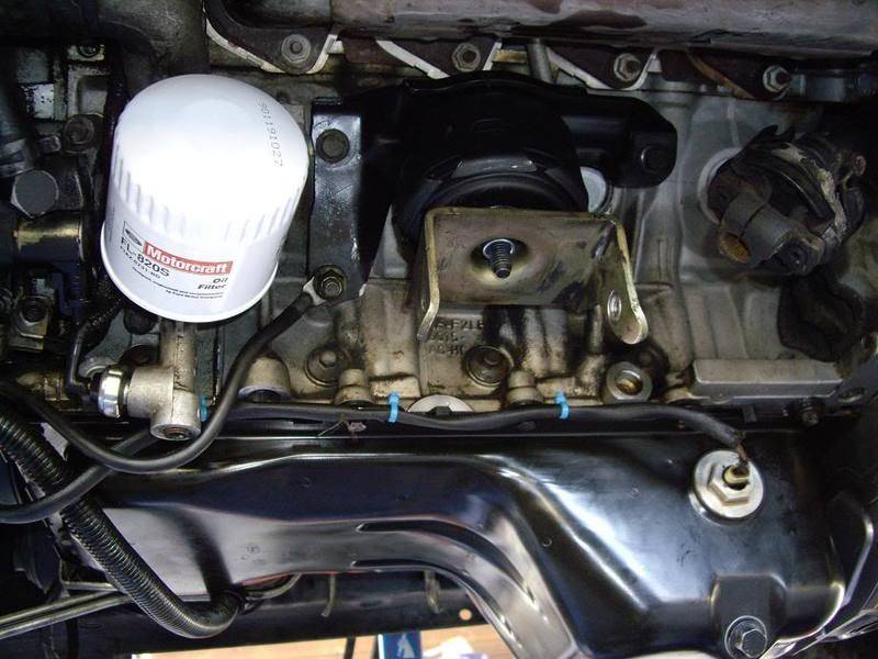

All cleaned up and hopefully leak free:

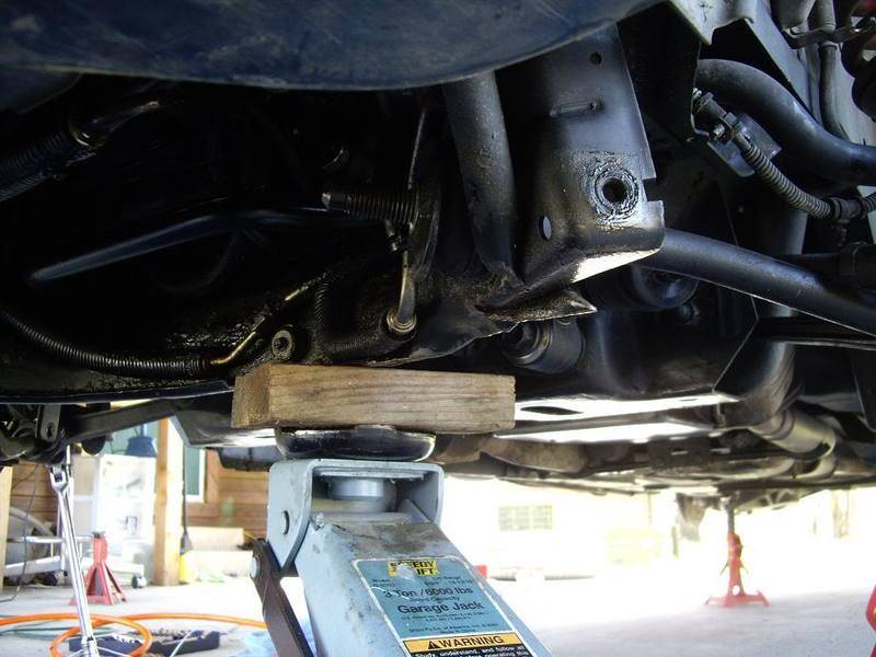

Tried plan A of getting it back in but that didnt work out well. He took a nap.
So we resorted to jacks.
And finnaly its in there. :wrench
Nah man. I put in however many quarts it needed before starting it, started it up to check for leaks and it was like BANG BANG BANGBANGBANG BANG lol The car was a beater/daily driver so I didn't really care too much. :D
