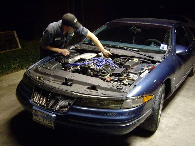

Sapperfires 93 blue on blue progress thread

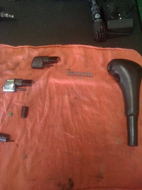

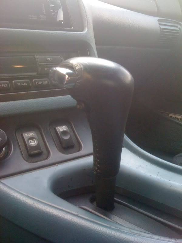

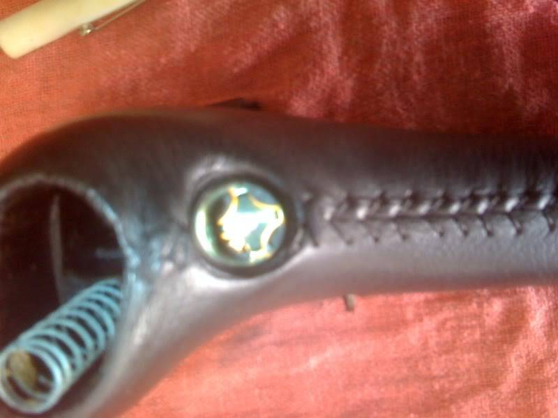

My blue shifter looked very worn and nasty, so I snagged a black one with chrome button..it was missing the OD button so I took it all apart and used the one from my original shifter
would rather have a new looking blue one, but can't find one. Black will do for now

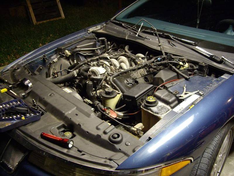

We got all the disco work done, just have to drop it down now. Sapperfire got some PB blaster in his eye so we figured its a good time to stop and remove his contact before it melted to his eyeball. :lol:

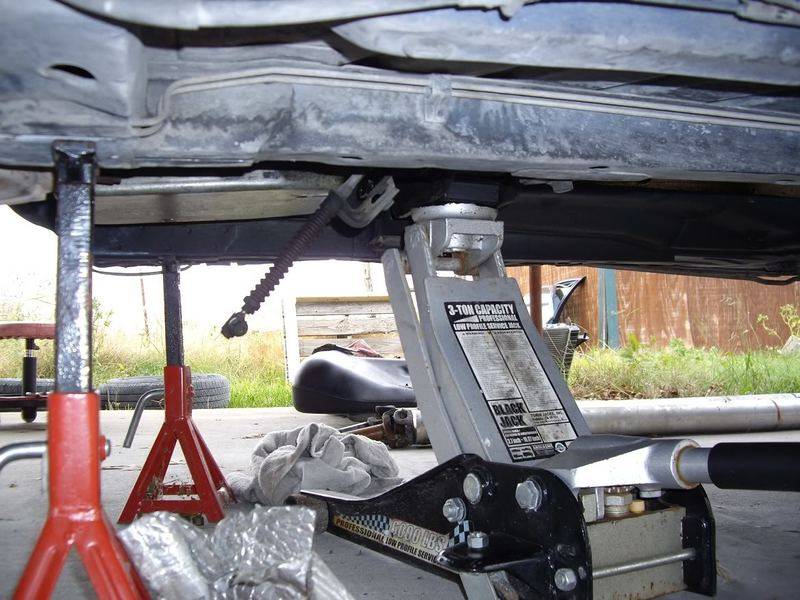

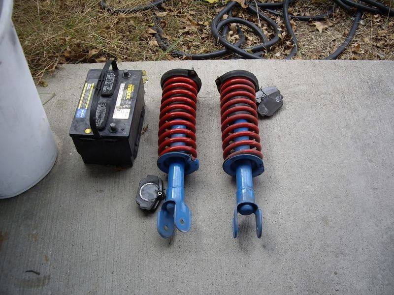

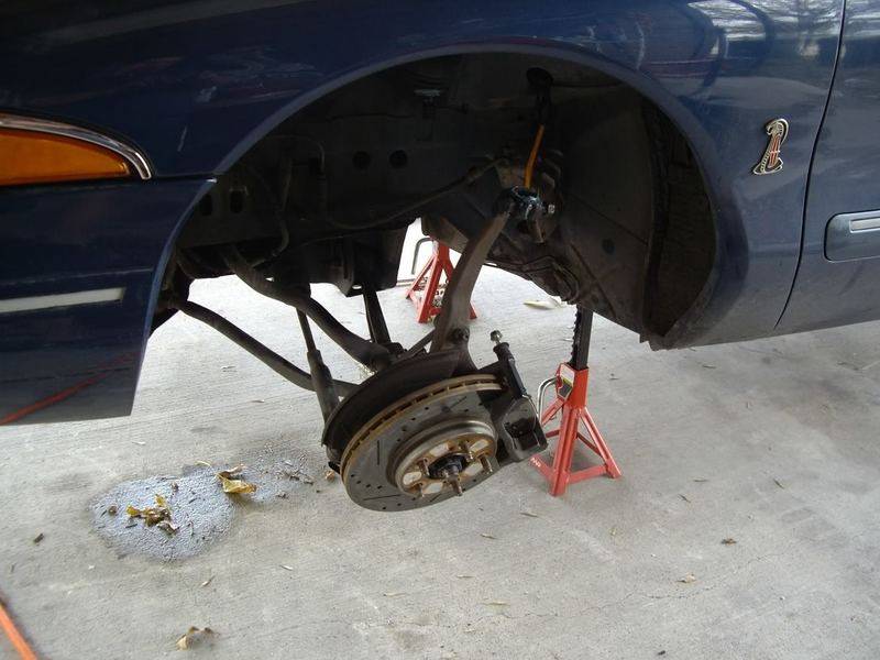

Got the front suspension apart.

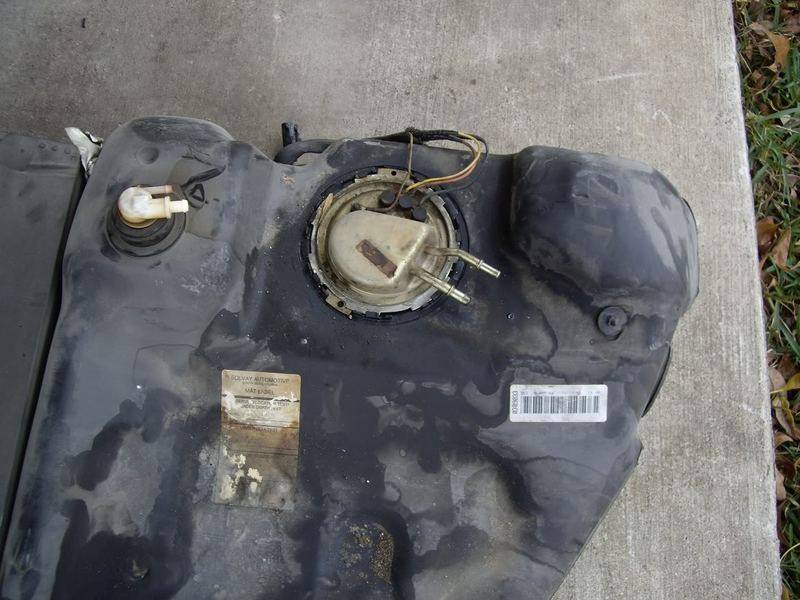

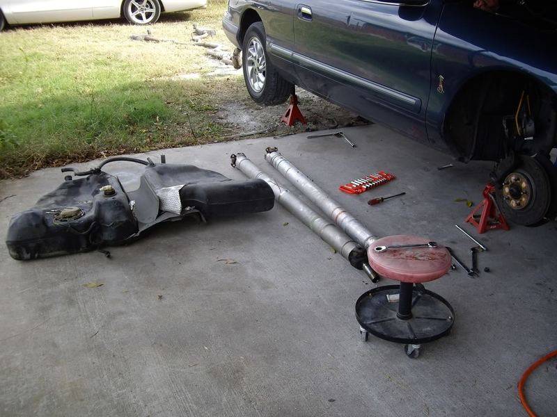

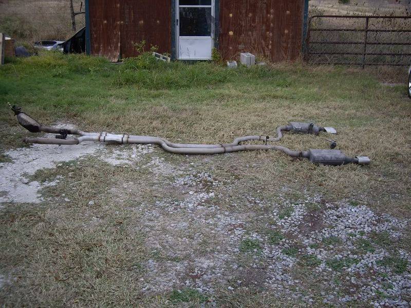

Then drop the exhaust, gas tank and drive shaft. Gonna be replacing the sending unit since the pump in this one is wrong, has no gasket, computer says tanks empty (even when full) and gauge always says full (even when empty):

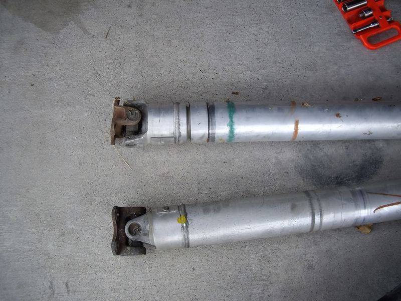

Note the difference between a 93 drive shaft and latter ones. The upper one is the two piece:

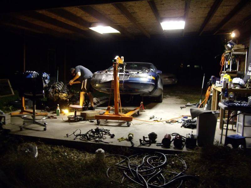

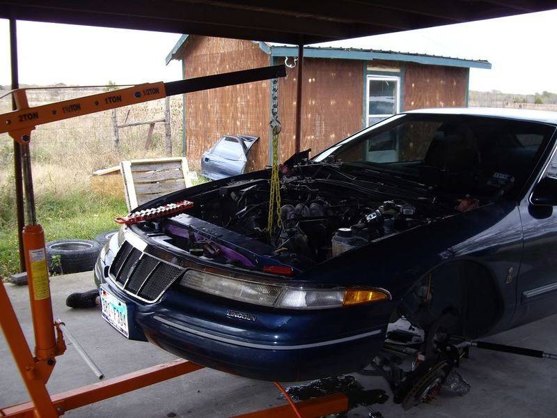

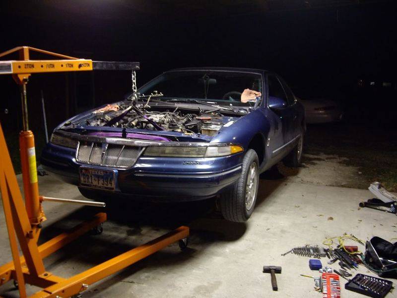

Got the motor ready to drop, yes we are taking our time. :D
Brace the trans:

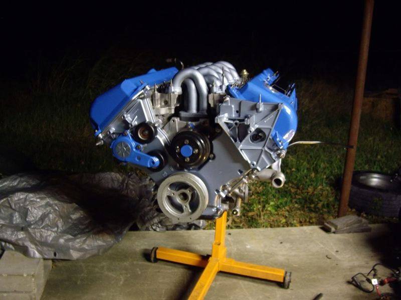

Moar updates. Things are taking a while due to us cleaning everything and this wasnt just an engine swap. The new second hand motor has all new gaskets, polished bolts and various other things that take time to install, clean and properly tq down.

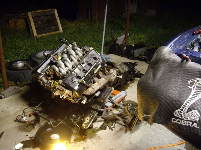

As of 6:30 we had the engine/trans divorced and the new motor almost done.
Tourqued down the intake to 8ftlbs then 11, TQ the valve covers to 6ftlbs and the timing cover to 20ftlbs.
And here is our big mess. :lol:
