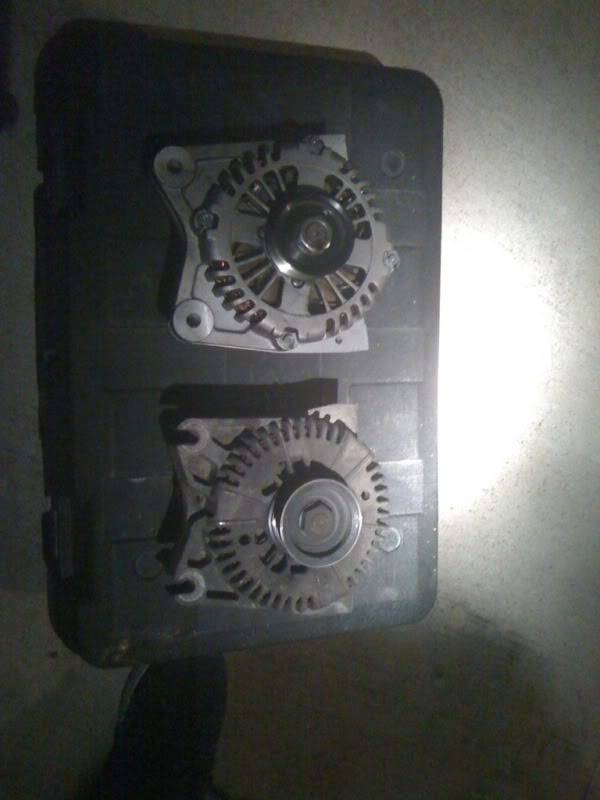

Replaced the freshly rebuilt (bad again) Alt with a brand new pretty one...I think the new one is for an 01 Cobra, the plug is reversed so just had to twist the pigtail 180*, the bolt holes are fully closed, and the case has larger vents...hopefully it will last longer than the last one
Looks to me like the mounting holes on the top one are farther apart than the bottom one.

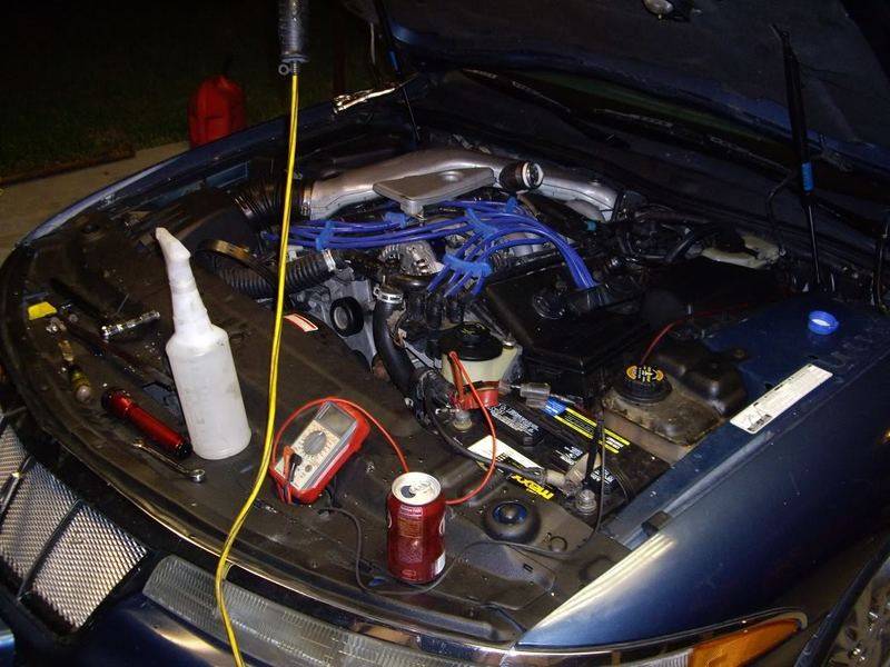

Swear his car is fuggin possesed! Sapperfire came over so I could test his alt out which it is bad by the way. The voltage cycles between 14.4 and 16.9 volts all the time. It shuts off when the battery is charged though but with the voltage spikes and the AC voltage it gives I believe he has a failing half wave rectifier. So thats gonna have to go.

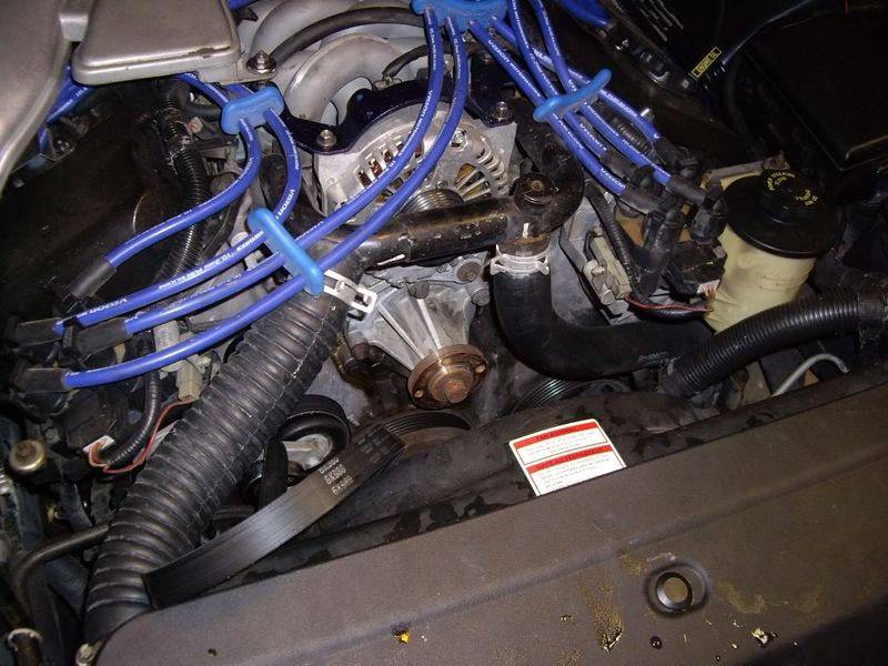

Since the 160* thermostat I ordered for him (and one for me and another friend) showd up so we figured its time to slap it in since the car still overheated on the way here. After the initial install was a failure (gasket got pinched) we retried and got a proper seal on it.
So we filled the coolant, burped the system and let it idle for a while. Car ran much much cooler then before so all was well........ then I had the nerve to say "Well guess that fixes the over heating problem!" :lol: followed by "Where is all that water coming from" (looking at a stream coming from under the car). :(
Look at the motor and the water pump is just gushing out. Should note he was running a rad flush in the car and we just pulled out some nasty looking water. Guess it flushed out the barnicals for the water pump too.
Fortunatly I had a spare one sitting on my spare motor so I yanked it and we swapped them out. The old water pump was quite nasty and was some no name brand pump.

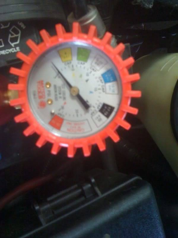

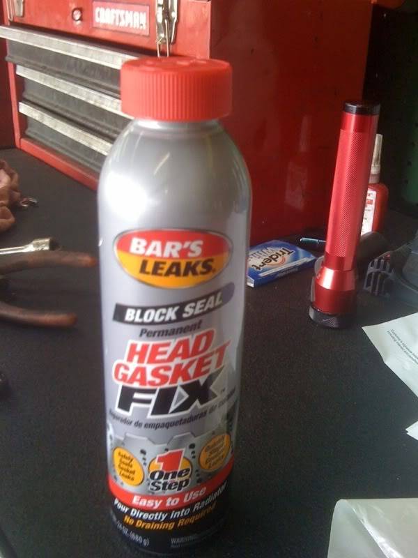

Hooked the coolant pressure tester up and put pressure on the system, as before the needle dropped just a hair and stopped...so I decided to do a reverse test of that, released pressure, put pump back on surge tank but did not pump..instead I started the car and ran over to watch the gauge...as it was quickly building pressure to about 30 psi (only took a few seconds) turned car off and called my buddies at Advance Auto who sent me this....
I installed the bottle directly in the crossover tube with Coolant, let car idle for 15 minutes...turned car off and let cool...
Then hooked pressure tester back up to surge bottle, no pumps, start car...
it's working great...car purrs like it should..
This marks my odo at 139,450 , let's see how long that stuff works
