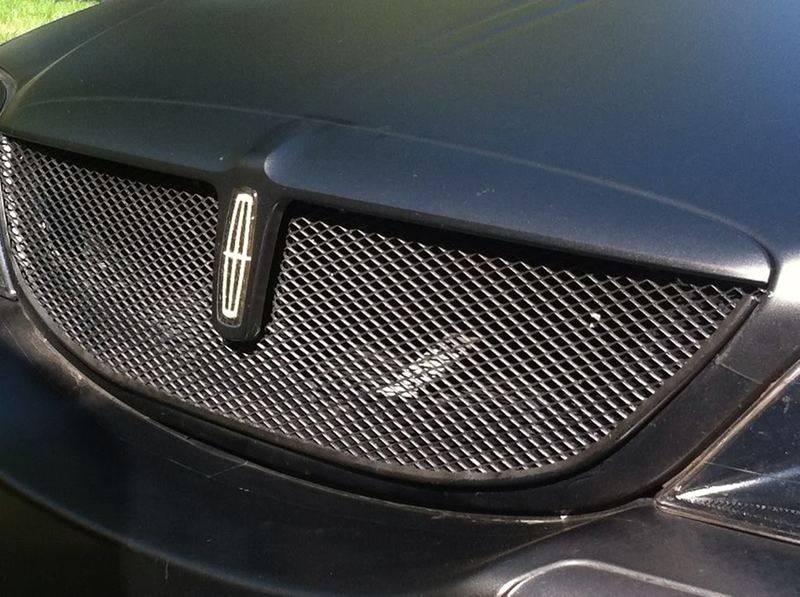

It's just a aluminum mesh sprayed w plasti dip then zip tied to the grille, with door trim around the sides

When you did the McClaren grille as well as this mesh one did you just place it over the stock plastic slats or did you cut those out?

The McLaren is a direct replacement. The CDC (mesh) grille is a two-piece unit where the mesh rests in a channel in the lower piece. There is a way to remove the "waterfall" from the 2nd gen grilles and glue the mesh to the framework of the grille. There are instructions here somewhere. I was going to do it on my '06, but for some reason it is far down on my to-do list. Maybe sometime next year I'll get the inspiration to do it......
